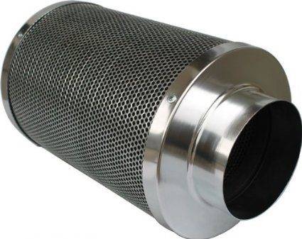

My filer looks like this.
The air first goes through carbon tube (that also has a prefilter on it ) then it goes through prefilter for Hepa and then HEPA before passing through the fan.
I'm mostly interested if anyone can tell me what can I expect if I overload the fan?? in other words if the pressure of filters is too big for fan to operate.? Will the fan overheat and malfunction? or will it just work at lower airflow through the filters? I would be fine if it will be pulling 100m3/h airflow through these filters but my instinct tells me its probably not good in long term if any at all.

A worthy exercise: I once bought a $300 one from a major/reputable manufacturer for a girlfriend. It was just a fan and filter in a poorly made plastic and foam box (there is a scathing review of it somewhere on this forum...). I'm sure I could do better and considered doing it myself...
I already bought a fan, its a 1000m3/h, 110W, 350Pa fan. But I am always skeptical about manufacturers claims when it comes to values.
As you should be. What, precisely, does the spec sheet say? 1000m3/h, 350P and 1000m3/h @ 350P are very, very different things. The best thing to do is find a fan curve, if the manufacturer can provide it (more discussion below...). Anyway, the airflow is in the ballpark of what a room-sized HEPA should be.
Sounds reasonable.
Fans have performance curves and if you choke them off by having a higher resistance than the chosen operating point specifies, you end up further back on the curve at a lower airflow and higher pressure. They don't overheat unless you stop the airflow completely: fan runs at lower power input when they are choked-off.

The sheet says exactly that what I wrote , its a typical curve, The highest static pressure(350Pa) is when the an airflow is lowest, and 1000m3/h is when there is no pressure. if I am reading the curve correctly.
But I got completely confused how all these work together when assembled, because the filter has its own curve and I am trying to calculate how it will all work together. As I learn more I found out there is initial pressure drop in filter and when it gets clogged up the pressure will only get bigger so I guess the fan is definitely weak I thing, but if I read the filter curve correctly let's say that the filter has 1000m3/h airflow at 250Pa pressure drop. Does that mean that at lower airflow there will be less pressure drop in filter? Or will it always be the same 250Pa and only rise above as it gets clogged and with more airflow required?
I just can't seem to wrap my head about how the fan and filter combined together will work. For example there was a smaller an with 270Pa and "only" 300m3/h airflow, maybe I should have taken that one instead of this one.
Either way I should be buying the filers in the next few days so I will see what will happen. I was thinking of also making my own inclined manometer to measure the pressure and learn more as I go. But my biggest concern is how the fan will behave and survive if it gets little airflow and big pressure for example running at 100m3/h at 300Pa all the time
