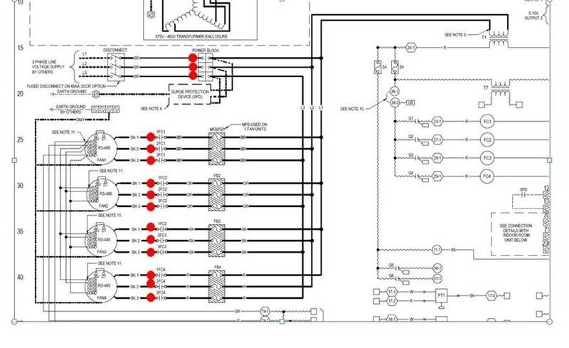

Testing Procedure
I think we are onto something. Below is the testing procedures and I see the very likelihood that the diode is experiencing the differential not once, but multiple times during this testing. Looking forward to your feedback.
Testing Procedure: Attached is the schematic for the system.
Separate tests are performed for each lead.
So in the example below each red dot represents an individual test
15 tests will be performed for this product
3 on the main Voltage line L1,L2,L3
And individual tests on each contactor on the load side total 12
All contactors are NOT energized while performing the tests

I see it applied to the motor windings, but it is not clear to me where the heaters are on that schematic.
Is this like my home unit, heater energized when motor isn't ?
Then, during that test with the contactors open the L1-L2-L3 are not connected by the motor winding.
That means you may well have the highpot DC (~2500 Volts?) pushing current from one L into another L through your diode . There should be only enough current to charge the distributed capacitance and whatever leakage is present. I'd guess that is enough to hurt an 800 volt diode.
At this point that's just speculation but not wild speculation.
Somebody who's real practical-minded needs to see it done.
Do you have a schematic of their unit that shows your heater ? Or am i just too dumb to find it on what you've already posted?
I take directions well, so don't be bashful about pointing out the obvious for i need and appreciate it.
old jim
Aha ! Maybe that's them in attachment to post [STRIKE]24[/STRIKE] post # 11, (doggone aspergers ! ) ...
below the text block, CCH1 and CCH2 through B contacts C1AUX and C2AUX ?
If so you've probably found the trouble, and without my bungling "help" ..
old jim

Good eyes! I now wonder even more why the diode is in the circuit. If there are capacitors in series with the resistive heating elements, why not just decrease the series capacitors instead of going to a half-wave rectifying diode?
Of course, fixing the Hi-Pot test program is probably a simpler option...
Capacitors ? Or normally closed (form B) relay or switch contacts (and fuses) ? Awkward naming convention makes them look like caps, sure enough.

Sorry I am late to this. You have found the heater and it is after the auxiliary contactor, either C1AUX or C2AUX, not sure which one is our heater. My guess is the heater is after the NO contact for what I have been told there is a selector switch that allows the heater to be turned on or off.
It sounds like the way they test could definitely be the source of the sporadic failures of the diode. Those diodes are definitely not the most robust elements and when we buy them in the tens of thousands some are bad coming out of the box.
At this time, I see a couple of different options:
1) Try to get them to change their test methods by either removing our heater from this hi-pot test (since we hi-pot the heater prior to shipping and before the diode is put in, or by tying the two leads of the heater together prior to shocking their system.
2) Re-design the heater by either including some type of surge protector in parallel with the diode or removing the diode completely. Both will be hard. The UL is one thing but to get the heater to mimic the current limitation caused by the diode may not be possible.
Thanks for taking this issue on gentlemen.

Jim,
I laid out four options to resolve this issue and they chose to re-evaluate their hi-pot testing procedure. In the meantime they will tie the leads of our heater together, after the contactor, to avoid presenting a voltage differential across it. I could not get one to fail testing it this way at our shop. They too are weary of changing the part at this time so did not bite on putting a surge device in parallel.
  • #35
Hey, that's great news! :biggrin:
