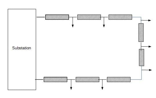

System reliability may or may not be part of the OP's responsibility. But for the benefit of others who may read this thread, let me explain better the relationship between system reliability and component reliability. See also post #2.
Consider a simplified distribution loop as shown below. The substation is the interface between the distribution system and the transmission system. Most distribution circuits are arranged as loops, that can feed power clockwise or counterclockwise, thus providing two paths to most loads. The cross hatched rectangles are components (breakers, transformers, switches, fuses, overhead line sections, underground cables, shunt capacitors, whatever). Let's assume that we know of a mean time between failues MTBF and mean time to repair MTTR, for each failure mode (say short circuit, open circuit, whatever) for each component.
The arrows are places where one or more customer loads can be connected.
The first thing to observe is that the chance of power interruption is different for each node in the circuit. In general, higher reliability closer to the substation. So we need to calculate interruption frequency and duration averaged over all the loads.
Next, note that the consequences of failure of a component depends on its location in the circuit. In the simplified case above, there is no load that will be interrupted by a single failure, it would take two or more simultaneous failures. Simulaneous failure of the two components closest to the substation takes out the whole loop. Simulaneous failure of the two components furthest from the substations takes out only one load.
In real life, single failures may interrupt a few customers while leaving others undisturbed. Think of a branch taking down the wire from the pole to your house (withough causing a short circuit). That single failure will take your house out, but nobody else. Also in real life, the typical loop will have thousands of components and topologies more complicated than a single loop. Also some loads more critical than other loads.
Tree branches taking down lines is the most frequent bad event. Squirrels crawling on components is also very significant.
Next, we use the Monte Carlo statistical method to calculate the system average frequency and duration of interrruptions, based on the component MTBF and MTTR values, and from the component placements in the circuit. That is the system reliability calculation.
Finally, we can calculate the contribution of each component to system reliability, by first calculating system reliability with that component in the circuit and calculating again with the component removed. The difference in the two answers is the contribution of that single component to overall system reliability; it is a meaningful number. The same method can be used to calculate how much value there is to doubling or halving the MTTR of a single component.
So, the question in the OP is quite doable. The contribution of a single breaker to system reliability can be calculated, and that number is meaningful. Whether or not that should be the reponsibility of the poster is not an engineering question.
Sorry if I went overboard with this long post. It is both overly complicated and overly simplified. I couldn't resist.
