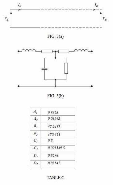

Figure shows a 50 Hz, high-voltage, transmission line. The relationships between the sending and receiving end voltages and currents are given by the complex ABCD equations:
[itex] V_S = V_R (A_1+jA_2)+I_R (B_1+jB_2) [/itex]
[itex] I_S = V_R(C_1+jC_2)+I_R(D_1+jD_2) [/itex]
where 'S' stands for sending-end and 'R' stands for receiving-end
(a) Given the parameter values in TABLE C and an open-circuit received voltage measured as 88.9 kV, calculate the values of [itex] V_S [/itex] and [itex] I_S [/itex] and hence the power [itex] P_{SO} [/itex] absorbed from the supply by the transmission line on open circuit.
(b) If the line is modeled by the T-circuit of FIGURE 3(b), see if you can estimate the primary line coefficients R, L, G and C. The line is 50 km long.

What I'm thinking is [itex] I_R=0 [/itex] as this is an open-circuit and given [itex] V_R [/itex]; [itex] V_S [/itex] and [itex] I_S [/itex] can be calculated.
Now,
[itex] V_S=77325+j3149 KV [/itex]
[itex] I_S=j119.9 A [/itex]
But I don't think that is correct because [itex] V_S [/itex] should not be lower than [itex] V_R [/itex], also 50Hz frequency is given for a reason, I'm sure it has to be used somewhere.
And as for question (b) I have only got ideas. I can find coefficient of propagation γ and [itex] Z_o [/itex] from R,L,G,C but I don't know how to produce them vice versa (from ABCD), I don't see where I could go from there either.

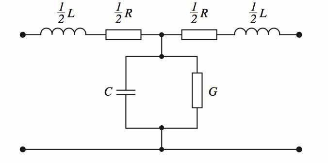

A transmission line is usually modeled in my learning material by the figure shown in attachment, I reckon this should be the case in this exercise.
Right, the current in the right leg is zero which means that resistor and inductor are out of consideration, hence, the voltage in the top centre node is [itex] V_R [/itex].

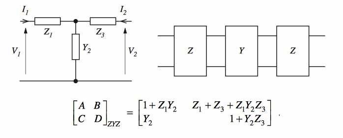

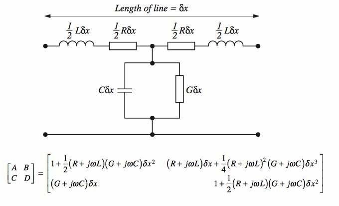

I've got new ideas, see the pictures attached. The T-circuit can be modeled by ZYZ circuit shown in figure.
We know ABCD, frequency and length of line, the question is how to find R,L,G,C.
I'm so close, just need the last nudge.

Yes, that's great, thank you. Let's go down the other line I just figured and see if the values match. I think I'll need 4 equations with 4 unknowns. I need some time to figure them out.
I think I've got it. Referring to my latest attachments the left or right series element [itex] Z = \frac{A-1}{C} [/itex], shunt element [itex] Y = \frac{1}{C} [/itex]
Real part of Z = R/2, imaginary part of Z = L/2, divide by ω for L value.
1/C=jωCs (shunt capacitor)
Divide all values by line length.
I get the same L and R values as you did. Thank you very much indeed!
