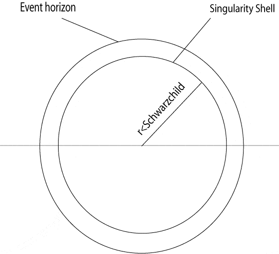

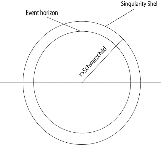

  • #58
JesseM said:
But Instine isn't talking about an ordinary spherical shell of finite volume, he's talking about a 2D singularity of infinite density that has the shape of a sphere. I don't know if GR even allows such things, but it does allow "ring singularities" in the center of a rotating black hole, and apparently there was a 2D plane singularity in the unphysical model of the galaxy suggested by Cooperstock and Tieu which Garth mentioned in post #31.
OK I see now. Its like to joining up lots of little black holes into a spherical shell.
I think that you still get one big black hole. Since the radius of a black hole is proportional to the mass, having enough mass to create a sphere of black holes will mean that that sphere is smaller than the event horizon of the total mass

  • #60
Essentially Abrams cuts out a spherical shell around the black hole, topologically identifies all points of this spherical shell as being "the same point", and procliams that this "eliminates" the interior of the black hole.
This is surely the kind of forgiveable thing we must try. I mean forbidding this is akin to saying you must never change from polar coordinates to Cartesian mid calculation.
definately one way of looking at it.
Yet more cunning thoughts. I nearly dismissed this one, but now its really got me thinking. I like it. And I'd not thought of this as an issue. Anyone want to do the maths, or do I have to get my calculator out.
At first guess, I'd assume you could have both scenarios. i.e. One where the Singularity Shell was 'thin crust' of low mass but had a large radius, and therefore had a possible Cosmic Censorship issue. And then the other kind 'deep pan' (I must be hungry) with which there is no such issue.
