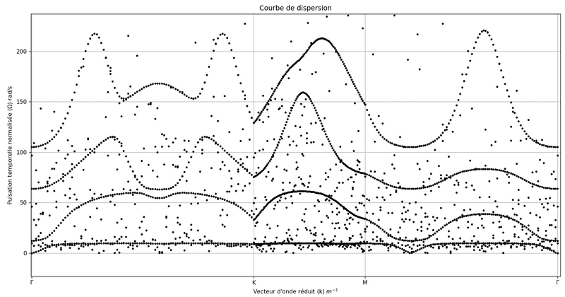

I struggle to implement the perturbation of a wave in a Honeycomb structure : i can't have the results which can be find on internet.
Hi,
I am a engineering student and I am in apprenticeship with a mechanics lab : I am studying about Honeycomb propagation and periodic structures. I hadn't have any courses in FEM or in Bloch's theory, I've done all by myself : but there is the problem, i didn't practice or use viable courses. I tired to implement the propagation in 2D of a wave in these honeycombs, with the following code in Python :
[CODE lang="python" title="Honeycomb wave propagation (function names are in french)"]from Matrices import mass_matrix,stiffness_matrix

But the result is absurd (left, mine and right from a research paper):
VS
If you have any suggestion or help, I am thanking you in advance,
