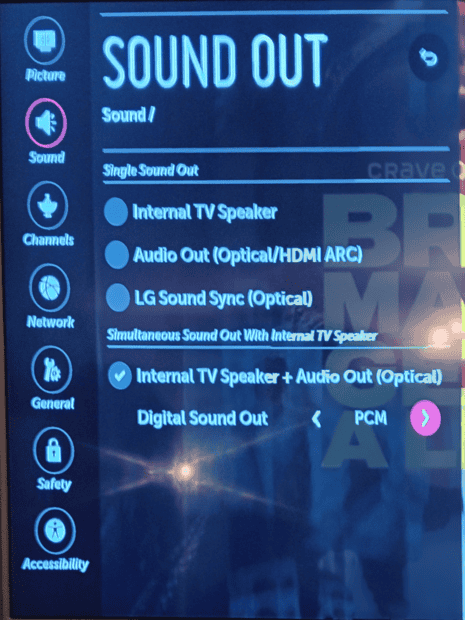

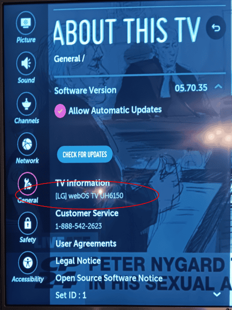

What I don't understand is that I can't get it to work with the RCA jacks. It comes with an RCA-to-3.5mm jack and my TV has RCA jacks on the back but as far as I can tell, my TV has no way to output to RCA.
LG webOS UH6150
There's a bunch of sound settings but none of them output to RCA as far as I can determine (I am open to suggestions).
Unless anyone has some things I could try, I think my next option is to pick up an optical splitter so I can run it to my sound bar as well as the headset transceiver. (I would like to have the option of having a headset and soundbar active at the same time).
Then, hopefully, there will be a way to conveniently mute or switch off the sound bar when we are both using the headsets. (I mean, I guess the sound bar has a power button...)
I'm only guessing (based on my LG TV) but that could be because the RCA jacks are inputs (for sound to go with component or composite video).
:Dave feels like an idiot: o0)
