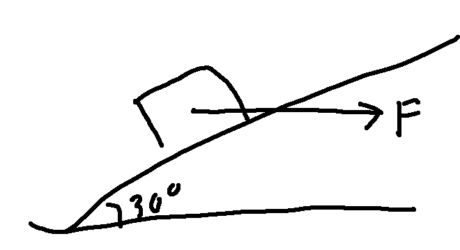

A 100 N box is being pushed with a horizontal force F at 30 degrees on a frictionless ramp. Determine F and N (normal force). I got about 57.74 and about 115 for the second part (I don't know if it is right)
Fcos(theta) -mgsin(theta)=0 for part A
N-Fsin(theta)-mgcos(theta)=0 for part B
Please let me know what you get.
Thank you for your help! Any and all answers are much appreciated!

yep, your answers look good to me :)

There is not enough information to answer this question.
Is the box stationary?
Is it moving at a constant velocity?
Is it accelerating? If so, at what rate?
haha, yes, I was going to say that. I assumed that the box was moving at constant speed, and I got the same answer as him, so I guess he just forgot to write that in the first post.
