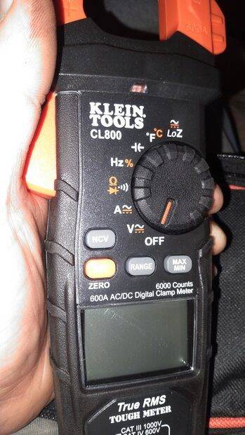

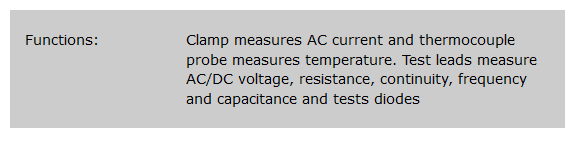

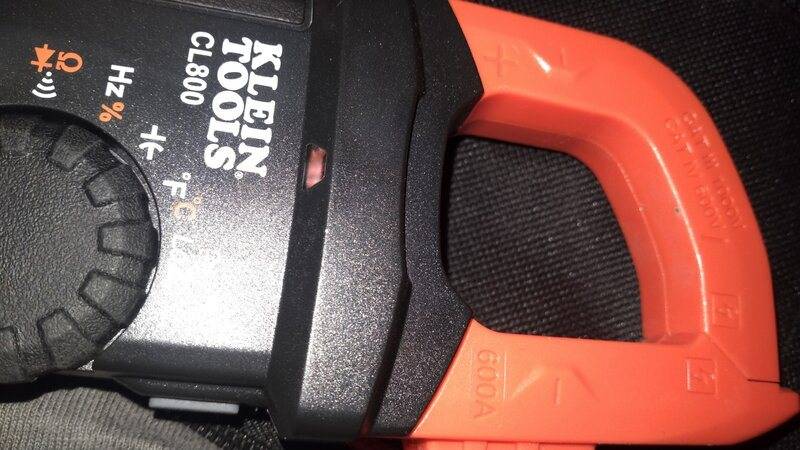

My Klein multimeter measures AC as well as DC current with the clamp. I have not tried it on DC. The clamps I've used on AC are fine for what they're used for. Why is it important to have .1% or better accuracy when measuring mains current? Afraid your clothes dryer draws a fraction of an amp more than spec?
Interesting! Which model is it?
berkeman said:
Hmm. Might be the 800. I'll be able to actually pick it up and look in a couple hours.
Likes berkeman
Fluke has some that look good for high currents. I've only ever used the really old ones from them which were sort of OK, but not great. The magic words are hall-effect. They usually have a manual DC offset adjustment, since it's hard to avoid some magnetization of the core.
$50 gets you this: https://www.amazon.com/dp/B0188WD1NE/?tag=pfamazon01-20

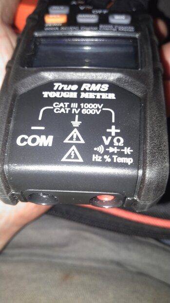

The build quality is excellent and I can measure DC currents down to the 10 mA range. I used mine to track down a vampire load in my old Town & Country van. You don't need .1% accuracy for something like this.
When measuring DC currents that low you have to watch out for the effect of the Earth's magnetic field.
The reason I posted the pic showing the jacks the probes plug into with text showing their function was to show that current is NOT measured on that meter except in the clamp. Not a practical unit for lower currents.
