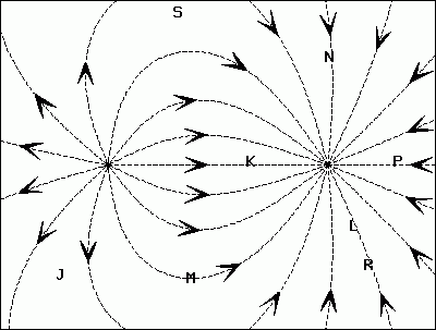

The electric field from two charges in the plane of the paper is represented by the dashed lines and arrows below.
Select a response for each statement below. (Use 'North' towards top of page, and 'East' to the right)
The force on a (-) test charge at N is directed ...
The magnitude of the E-field at R is ... than at L. s
The sign of the charge on the right is negative.
The force on a (-) test charge at M is directed ...
The force on a (+) test charge at N is directed ...
The force on a (-) test charge at S is zero.
The magnitude of the charge on the left is ... that on the right.
The force on a (-) test charge at N is directed ... South
The magnitude of the E-field at R is ... than at L. s Less than
The sign of the charge on the right is negative. True
The force on a (-) test charge at M is directed ... North
The force on a (+) test charge at N is directed ... North
The force on a (-) test charge at S is zero. False
The magnitude of the charge on the left is ... that on the right. Less than.
