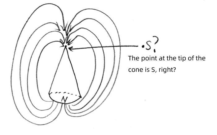

I didn't find the right formula.
How are the poles of a tapered magnet distributed?
Is there any way to calculate its magnetic force?

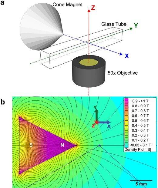

Looks like FEM modeling software is your best bet for finding magnetic force. Below is an example FEM model of a conical magnet that I found online. Note that the magnetic field lines don't concentrate at the apex nearly as strongly as in your hand sketch.
http://dx.doi.org/10.1371/journal.pone.0188015
