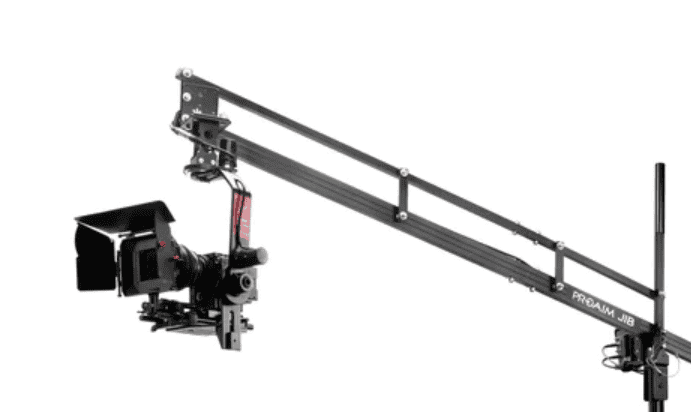

Thank you for replying.
I dont have much info but a few video for reference on the setup and usage:
Hope this helps.
This works because the boom is rigid (from the cables) and the torque from the camera weight is exactly to counterbalanced by the the torque from the weights by adjustment at zero angle. Any change in angle shortens the moment arm of each in the exact same proportion, so the balance remains perfect.

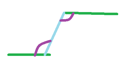

Thanks Hutchphd,
moment arms are static. they do not lengthen or shorten while going up or down.
There is no spring mechanism from the camera head side to vary torque at different angles too.
The cables are meant to act as a tension cable to level the camera head. Its based on fig 1: the sum of angles for the purple is 180 degrees.
thus allowing fig 2 movements

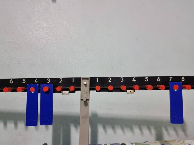

russ_watters said:
No, perfect balance is a neutral condition. Returning to level is an imbalanced condition. But there's a catch; where's the imbalance when it returns to level?
Given the case does it mean i would be able to balance this level scale so that it can stay in any position without changing the weight or distance? if so how?
jack action said:
If you look at a window balanced by a counterweight through a pulley, what would be the "level" condition?
It seems the pulley has springs to have increased torque depending on the length. A jib does not have spring mechanism, both heads are free. Given a scale lever, would it be possible to change the "level condition" to be flexible?

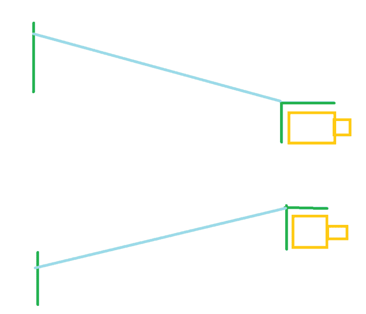

Hi,
i tried drawing a jib from memory. concepts are roughly similar across.
starting from left,
the yellow is a control plate attached to swivel plate (Green)
Its is connected via a tension cable / rod (Pastel blue) to the front to mantain level. ( see above response to hutchphd)
Red is the bar. Weights are attached to the blue circle via a rod where weights can be mounted on.
The bar has a T pin to prevent it from escaping.
Black is the fulcrum.
There is no spring mechanism in the jib. Perhaps i am missing some key concepts. appriate your love and patience. Thank you.
I fear you are. A child's teeter-toter, if balanced at horizontal, will also be balanced at any other angle so long as the children remain rigidly upright. there are no further requirements.
By the same token, any imbalance will likewise persist at all angles unless the geometry changes (e.g. one child leans back).
That's it. Not complicated.
In that example the weights are hanging below the bar. That's the answer to my question: it is imbalanced in the vertical axis (more weight below than above). Though if they are hanging they might be able to swing back and forth somewhat.

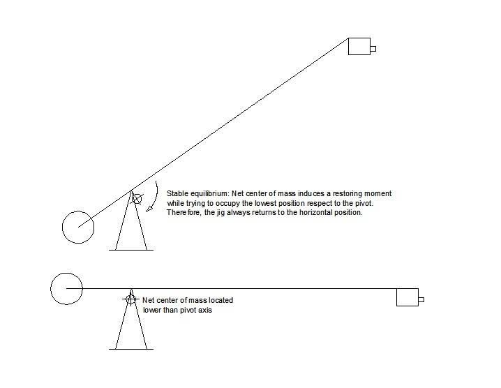

loozh said:
TL;DR Summary: Given that both ends of a camera jib are balanced, shouldn't a jib remain level / parallel to the ground instead of staying in any position?
In order for the camera jib to remain level, or to return to level by itself, not only one, but two conditions are necessary:
- Both sides to be balanced.
- The vertical location of its center the mass is lower than the location of the pivot axis.
The second condition will always make the center of mass return to its lowest location, which is located on a vertical line that crosses the pivot.
In order for the camera jib to remain at any angle, not returning to level by itself, two conditions are necessary:
- The vertical location of its center the mass exactly coincides with the location of the pivot axis.
Note a friction disk in the video below, which, besides the fine balancing, helps stop any small movement induced by a less than perfect spatial coincidence of the net center the mass and the axis of the pivot.
