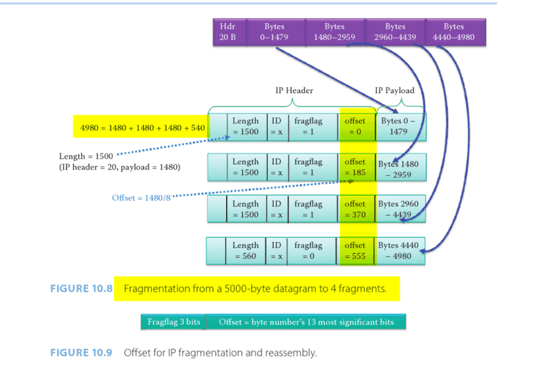

How can a 13 bit number represent 16 bit number?Or why is fragmentation offset multiple of 8?
none
This is more of a mathematics confusion rather than a computer science confusion, so please treat it like that. I understand the computer science behind it(I hope so) but my confusion lies in the basic math part that is there.
I am studying about ipv4 fragmentation.
This is ipv4 header. The fields of concern here are-:
-> identification(16 bit)
-> Flags(3 bit)
-> fragment offset(13 bit)
-> Total length(16 bit)
In order to understand these concepts of fragmentation, I have solved multiple problems. One of them is below.
Here initially we have 5000 byte datagram of which 20 byte is header.
The MTU is 1500 bytes.
The answer is this-:
But I am unable to realize this simple concept that I believe even a 5th grader can understand even though I am college level undergraduate student. It is being pretty shameful for me.I am leaving my shame aside and asking this instead of giving up. I have asked this everywhere and everyone says this is basic math but it is not clicking in my head. Imma memorize this lol. I can solve any numerical problem related to fragmentation but this curiosity isn’t letting me to learn further and go to ipv6.
It would be immensely helpful to me if anyone can help me via that above example to understand this simple concept. I am unable to relate with this concept.
I agree there are 2^13 offset values ie 0,1,2,3,4,5,6,7,8,9…..8191. So that is the total no. of fragments possible 8192 fragments. But datagram can be only as big as 2^16-1 bytes. But why are we dividing them? It doesn’t make any sense. Maybe it is trying to say that 8192 fragments need to span 65535 bytes which gives 7.99987793 as the answer. But I have calculated it later, and fragmentation doesn’t work like that.
Opinion 1-:
Max “true” fragment offset possible=sum of all previous DATA ONLY excluding header
=65535-n*20 bytes.
Where 65535 is the max total length possible.n is the number of fragments and 20 bytes is the header length
The max value of offset possible is 8191. 65535-n*20 bytes should be represented by 8191 (both max values). But this opinion takes nowhere.Opinion 2-:
Max. 13 bit number=8191
Max 16 bit number=65535
So 65535/8191=8.0000sthsth (not exactly 8).
So the problem is like how can max offset value represent the max data size. But as i said in opinion 1, max data size can never be 65535 as header also takes up some space.
Opinion 3–:
Say i want to understand this example by a dummy example. Say fragmentation offset field is of 1 bit. And total length field is of 4 bit. What would happen?
Here are some answers that I have read which gave me further confusions-:
From the image you posted and highlighted:
"The field is measured in unit of 8 bytes."
Each fragment or chunk is 8 bytes. The total datagram size is 65536 bytes, with the bytes numbered 0, 1, 2, ..., 65,535. This means there are 65536/8 = 8192 (exactly) chunks of 8 bytes each. The chunks are numbered 0, 1, 2, ..., 8191.
The division above is ##\frac{2^{16}}{2^3} = 2^{13}##. That's all there is to it.

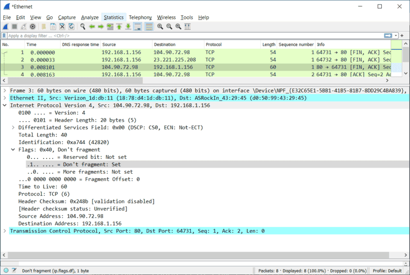

For the TCP protocol, PMTUD (Path MTU discovery) is almost universally used. So the "Do Not Fragment" (DF) flag is normally set and TCP packets will normally not be fragmented. Instead, the TCP payload will be transmitted in smaller "segments".
Fragmentation is normally to be avoided. With VPN, one finds software that artificially reduces the MTU on VPN adapters. My organization does a lot of MSS clamping to avoid PMTUD black holes.
Wireshark is your friend.
I think you're making two mistakes. First, the datagram can be 2^16 bytes in size. That's what the excerpt you quoted says, and for some reason, you decided to subtract 1.
Second, you seem to be assuming the offset 8191 has to correspond to the last possible eight-byte chunk of data. If you subtract out the 20 bytes used for the header, the data field can be 65516 bytes long. A data field of that length can be divided into 8190 eight-byte pieces, which corresponds to fragment offsets 0 through 8189. You should never see a fragment offset of 8190 or 8191.
Going the other way, you have thirteen bits for the fragment offset, so you have 8192 possible offsets. If you divide the largest possible datagram into 8192 pieces, you find that each piece needs to be eight bytes long. So if you use eight-byte chunks, you can accommodate any length data field since it's only a portion of the datagram. (Because of the overhead from the header, it doesn't follow that the largest possible data field would require all 8192 offsets.)
RFC 791 says 65,535.
"Total Length is the length of the datagram, measured in octets, including internet header and data. This field allows the length of a datagram to be up to 65,535 octets."
The packet format allows for the possibility of a last fragment in a 65,535 octet datagram at a fragment offset of 8191*8 = 65,528. In principle, this would allow for the possibility of creatively encoding a sequence of fragmented IP datagrams (I think you'd need at least three datagrams total) with a payload length totaling 65,528 + 65,535 - 20 = 131,043 octets. In practice, I do not think one would find many peers willing or able to accept such a monstrosity.
