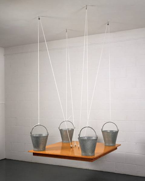

Hello Physics Forums, Deployment here. After browsing the internet I came across this photo..
I have been pondering and pondering on how this is actually possible. If you think about it, the buckets are actually holding down the table.
Does anybody have any idea how you would conduct calculations on doing this?
Thanks,
- Deployment​
4 M_bucket >= M_table
where M, of course, is the mass.
Instead of buckets, imagine there were people pulling down on the ropes (if the table were bigger). Would that make more sense?
Treat it as any other static equilibrium problem.

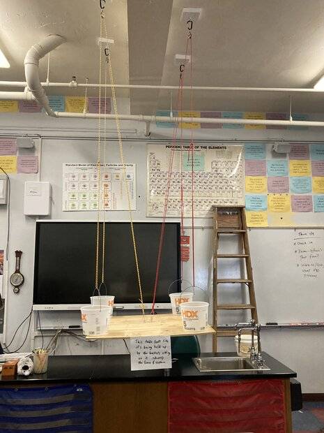

So we were coming to the conclusion today that what if you just took the weight of the table and divided it by 4...As long as each bucket is pulling with the same amount of force of course. The only concept that I keep over-thinking is that the ropes go through the pulley from the buckets to the table at an angle..and I keep asking myself if that angle will make any changes in our calculations.
I got some number for you guys today. Here they are,
Table Weight = 68.11N
Bucket 1 Weight = 165.9g | .1659kg
Bucket 2 Weight = 165.7g | .1657kg
Bucket 3 Weight = 167g | .1670kg
Bucket 4 Weight = 166.4g | .1664kg
The Table Dimensions are..
33.25 x 33.25 inches
The holes in the table obviously make a square, and are directly 14.25 inches from each edge. The square that they make is 10.25 x 10.25 cm
- Deployment
So could it be this simple..
1.) The weight of the table is 68.11N, which can be converted into 6945.2871 grams.
2.) If you divide the weight of the table (In grams) by 4, you get the amount of weight that must be exerted on EACH bucket. Which is 1736.321775 grams.
3.) Now we have to factor in the weight that is already applied from the weight of the buckets, which can be seen in my last post, so after that factoring we can come to the conclusion that the following is how many grams that need to be added to each bucket..
Bucket 1 = 1570.421775g
Bucket 2 = 1570.621775g
Bucket 3 = 1569.321775g
Bucket 4 = 1569.921775g
Does this sound anywhere close to a reasonable prediction? Or do you also feel that the angle at which the ropes are tied and pull on the table matter in the factoring of this equation?
- Deployment
I think it can be as simple as this, for the symmetrical case with long ropes.
Each rope supports 1/4 of the total weight, shared by both of its ends. The tension will be 1/2 that value - i.e. 1/8 of the total weight.
The force on each bucket from the table will be the difference between the weight of the bucket and the weight of the bucket plus its share of the table weight - i.e force on the bottom of the bucket would be 1/4 the weight of the table.
Without symmetry, you would need more calculations and, as mentioned earlier, the system is over-supported. So would you allow some finite stretch in the rope, to allow things to settle?

Analyze each object separately. The forces on each bucket are: Weight of the bucket, tension in the rope, and the normal force from the table. These should add to zero.
The forces on the table are: The weight of the table, the normal force by each bucket down on the table (this is what you meant by "buckets are actually holding down the table", The vertical component of the tension in each string tied near the center of the table. These should add to zero. By symmetry the horizontal components of the tensions in the strings tied to the table will add to zero.
Write down these two equations, and you will find that with the given data, you can solve for everything.

Deployment has the answer.
Weigh the table, divide it in 4, calculate the weight needed to equalize ¼ of the table weight using the string angle. Make sure the string angle is enough to position the table above the floor. Lift the table above your calculated height, add your necessary weight to the buckets then allow the table to lower and suspend at it’s equalized weight height.
By the way, a bosun's chair needs 2 men and a boy lifting, when anyone is sitting in it; you need to lift the weight of the chair as well as the person in it... Or! Normally you pull it up empty, tie it off then climb up and sit in it.
  • #33
HaHa. You have my sympathy there, and you are welcome to try to climb the mast on my boat, unaided and without mast steps.
But your comment demonstrates the vast difference between Mechanical Advantage and Velocity Ratio (=Efficiency), which is a point that only I seem to make, ever, on PF. The VR of a self-pulled bosun's chair is 2 and the MA is something less than 0.5 (assuming you can normally lift your own weight yet you need another person's help). So the efficiency is MA/VR = <25% ! Bosun's 'chairs' are normally canvas and webbing and will be no more than a couple of kg so the losses must be due to friction in the (usually pretty expensive) halyard pulleys and compression in the rope as it goes over. But I guess the pulleys are not designed to turn efficiently under a 100kg (1kN) load. I'd bet that a really good pulley (also large diameter) at the top would make things a lot easier - but who would think about that when their mast happens to be laying down in the yard?
  • #34
This is simple. The weight of the table is equal to that of the buckets. A little push and you could make the buckets float 1 inch above the table. It would still be a static system and would not move.
1) First think about 1/4 of the table and 1 bucket. Then replace the bucket by 4 pounds of weight. Then replace the weight of the 1/4 table by another weight of 4 pounds. It will be a static system because the two weights are equal. If the weights are not equal things will move.
2) for the second step suspend 2 separate 4 pound weights over a table. As the string angle increases the weight of the table must be decreased to keep a constant tension in the string.
  • #35
