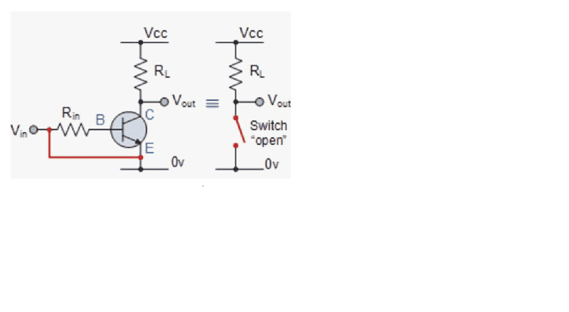

how can a transistor behave as a switch in the saturated region when it is in forward bias mode in the saturation region and the collector current may become zero
ic = Vcc / Rl , where ic = collector current, vcc is the potential of the output circuit battery
how can a transistor behave as a switch in the saturated region when it is in forward bias mode in the saturation region and the collector current may become zero,
when a transistor is used as a switch im the satruation in region, it is having maximum current but as it is forward biased as it is in the saturation region, the collector current may become zero when the forward bias will be maximum and thereby it will behave as an open switch and will be in the OFF state, where as in the saturation region, it is always ON,

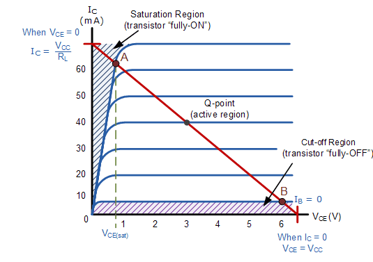

how is it possible, the same we can analyse from the output characteristics of the transistor between collector current and input voltage as given the attached files where the collector current from maximum finally becomes zero,
the confusion comes in 22.30 of the video of mr. h.c verma when he says the collector current may become zero and in 50.30 in the video when he says the collector current is maximum,

When a BJT has excess base current w.r.t. the collector current that the attached circuitry can generate, then the collector current does not depend on the base current anymore, it has more than enough. This is called the saturation region because a small change in the base current has a minimal effect on the collector current. In this region the transistor will look like a resistor from collector to emitter. This is the desired "on state" for a transistor switch. The fact that the externally connected circuitry might not induce any current flow doesn't matter. A switch doesn't have to carry current to be on.
