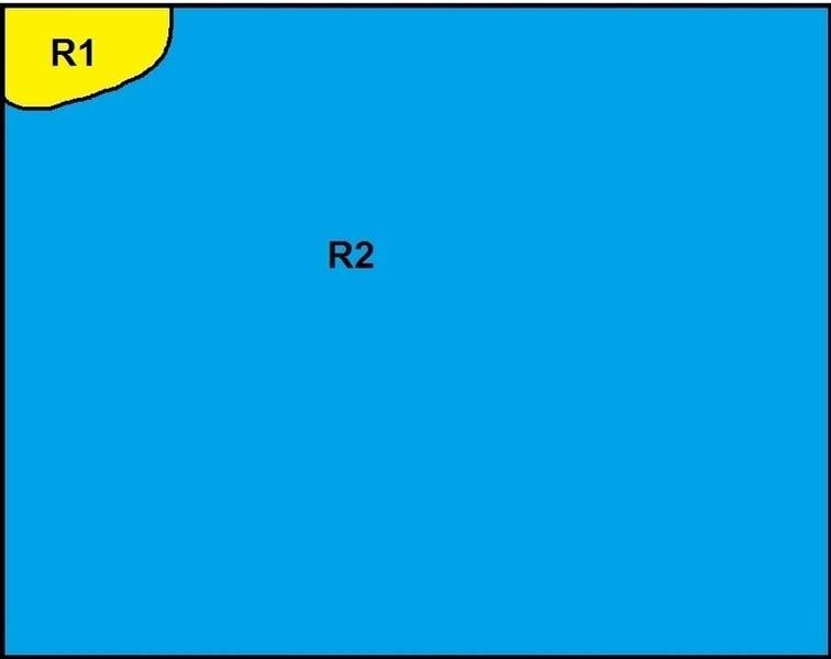

Hmm. To me, that's too weak. It's not just that our laws of physics happen to be entropy-increasing; it's hard to imagine laws that don't increase entropy.
Let's look at a particularly simple model
This drawing represents the space of possible states for some hypothetical system. Let's assume that there are finitely many possible states. Some of these states are blue states and some are yellow states. (It occurred to me after making the drawing that I should have chosen red and blue). Let's assume that there are 100 times as many blue states as yellow states. This is before we've said anything about what the "laws of physics" are. Let's assume that the "laws of physics" are deterministic transition rules (we'll let time be discrete) saying that if the system is currently in such-and-such state, then in the next time interval, it will be in such-and-such state. Let's also assume that the rules are reversible: every state has at most one state it could have come from.
The statistical mechanics definition of entropy tells us that the blue region has higher entropy than the yellow region, because entropy is just a counting of the number of states. (Technically, it's proportional to the log of this number.) Without saying anything more about the laws of physics, we know that 99% of the blue states must make transitions back into the blue region. So no matter what transition rules we come up with, for most states, entropy will be non-decreasing. The only way that we could have entropy decreasing, on the average, is if most blue states made a transition to yellow states. And that's not possible with reversible transition rules.
Now, we could come up with rules such that entropy remained constant: For example, if yellow states only made transitions to other yellow states, then entropy would remain constant. But microscopic reversibility implies that macroscopically, entropy is (usually) non-decreasing.
Likes Nugatory
I don't understand how the number of states is related to picture. Does the blue region have a higher number of states because it is a larger area? The scenario involves a number of different states and also a "system" in one of the states or "parts of a system" that are in various states. What does a point in the diagram represent? - a state? or a state and also a part of a system that is "in" that state?
How do we know that? Where does "99%" come from in a deterministic setting? Are we imagining a flow so "thing" at a point moves to a nearby point as time passes? I can see how that would imply that most things at blue points would move to other blue points over a small time increment. But that assumes more than reversibility, it assumes the "things" have a continuous trajectory. So we should make that assumption explicit.
Why isn't it possible? It isn't clear what property the two colors distinguish. You mentioned 99% of the blue states must make a transition back into the blue region, so I assume 1% of the blue states make a transition from the blue state to a yellow state.
Yes, that's the intention. My description used a finite number of states, so that it's possible to count numbers of states. For a more realistic model with an infinite number of states, you would need a notion of "volume" in state space.
It's just states. The system is in some location at every moment in time. Some of the locations are colored "yellow" and some of the locations are colored "blue".
In my simple model, it's just counting. There are, say, 10,000 possible states. 100 of them are labeled "yellow" and 9900 are labeled "blue". Whatever transition rule you come up with for determining which states evolve into which other states, most blue states will evolve into blue states. For a typical state, entropy will not decrease.
No, there is no assumption about continuity (you can't really have continuity with only finitely many states, which is what I was assuming). You don't need that. If there is only 100 possible yellow states, then that means that at most 100 out of the 9900 blue states can make transitions to yellow states.
If the transition relation is reversible, then it means that there is a unique predecessor state for each state. So if there are 100 yellow states, then there are at most 100 states that are predecessor states to yellow states. That means that out of 10,000 states, only 100 of them make transitions to yellow states. The rest make transitions to blue states.
It doesn't matter. For concreteness, assume that you have a machine that has two internal counters, [itex]i[/itex] and [itex]j[/itex] It has two lights, one colored blue, and one colored yellow. For some combinations of [itex]i[/itex] and [itex]j[/itex], the blue light will be on. For all other combinations, the yellow light will be other. Which combination produce which light colors can be represented by a diagram such as the one I gave: [itex](i,j)[/itex] results in a yellow light if the pixel with coordinates [itex](i,j)[/itex] is colored yellow, and otherwise, [itex](i,j)[/itex] results in a blue light.
At least 99%.
Possibly.
As I understand "reversibility" there can't be any "absorbing states". We can't have a transition rule like ##b_1 \rightarrow b_2 \rightarrow b_3 \rightarrow b_1 \rightarrow b_1## because if we are in state ##b_1## we wouldn't know if we got there from previous state ##b_3## or previous state ##b_1##.
Right. Or the simpler way to think about it is that every state has a unique predecessor state: For every state [itex]b_1[/itex] there is at most one state [itex]b_2[/itex] such that [itex]b_2 \rightarrow b_1[/itex].
So if we have a finite number of states, we must have cyclic transition rules like ##b_1 \rightarrow b_2 \rightarrow b_3 \rightarrow b_1 \rightarrow b_2 ...## Do the colors in the diagram have something to do with these cycles?
No, it's just a partition of the states into states that are observationally distinguishable. Like I say, imagine a machine whose only visible characteristic is which of two lights, yellow or blue, is on. There is more going on inside the machine, but we don't have access to that.
I thought the purpose of discussing the diagram was to prove somehow that "microscopic reversibility implies macroscopic entropy is non-decreasing".

Stephen Tashi said:
That explanation begins by assuming determinism and then refers to probability.
I agree with a probabilistic model. However, the OP asks about a deterministic scenario. If we take a deterministic scenario seriously (literally) then can we formulate a coherent argument that introduces probability into the picture? We can say that things get all complicated, so we have to talk about probability. However, that contradicts the literal interpretation of the deterministic scenario.
I think you are misunderstanding the role of probability here. We are talking about uncertain initial conditions and deterministics laws.
We have deterministic laws but we cannot know the initial conditions for every particle. So, we have to analyse the system assuming an unknown initial state. But, this probabilitistic analysis (using deterministic laws) leads to general conclusions about all initial states and that they all result in an increase in entropy (*).
A probabilistic law would say that the result of an individual interaction cannot be known. A probabilistic analysis can be based on deterministic laws.
(*) For simple systems there may be initial conditions that would avoid entropy increase, but for large, complex systems the probability of having initial conditions that defied entropy increase is so low as to be physically irrelevant: we never and can never see that behaviour.
So:
Proposition 1: if you start with a litre of hot water and a litre of cold water and allow them to mix then they cannot inevitably reach a temperature equilibrium through deterministic laws of particle collisions.
I am saying proposition 1 is false.
Proposition 2: if you start with a litre of hot water and a litre of cold water and assume a plausible set of initial conditions (from previous observations of hot and cold water), then using deterministic laws the prediction is that the temperature will always reach equilibrium.
I am saying proposition 2 is true. Further, if you repeat the prediction for as many sets of initial conditions as possible, in all cases equilibrium results.
Proposition 3: you cannot specify initial conditions whereby the water temperature does not reach equilibrium. Obviously, unless you prevent the water from mixing.
I am saying proposition 3 is true.
Then, as I asked in a previous post, how does the entropy "of a system" involve a "number of states" if the system is in only one state at a time? It seems to me that if we define entropy so it can involve a "number of states" ##\gt 1## then the definition of entropy must encompass several different systems or several different times.
Is it a "state" that has entropy, or is it a "system" (in a particular state) that has entropy? It's not clear to me how entropy "of a state" or "of a system" is defined vis-a-vis the picture.
It's only one state at a time, but all that we know about that state is that it is a yellow state or a blue state. If it's yellow, then the system is in one of 100 possible microstates. If it's blue, it's in one of 9900 possible microstates.
Entropy is (in the statistical mechanics view) a measure of how uncertain we are about the microstate, given the observable macrostate. The more realistic system is a tank full of gas. The macrostate--what we know about the state of the gas--is completely described by:
  1. The type of gas.
  2. The quantity of gas.
  3. The temperature of the gas.
  4. The volume of the gas.
The microstate classically would be the positions and momenta of every single molecule of the gas. Naturally, there is a huge number of microstates that are consistent with our macrostate.
In the statistical mechanics notion of entropy, there are two kinds of states:
  1. The microstate, which in my drawing would be represented by a pixel in the picture.
  2. The macrostate, which is an observable property of the microstate. In my example, it would be the color of the pixel.
The entropy of a microstate is proportional to the log of the number of microstates with the same macrostate. So in my example, the entropy of a yellow state would be the log of the area that is colored yellow. The entropy of a blue state would be the log of the area that is colored blue.
With the numbers that I made up, the entropy of a yellow state is proportional to log(100) = 2 (using base 10). The entropy of a blue state is proportional to log(9900) = 3.996. So blue states have about twice the entropy of yellow states.
(The choice of using log base 10 or some other base just changes the constant of proportionality.)
So far, that's clear.
Then "Entropy" as a property of a state doesn't change as a function of time, correct? A state is a state. It doesn't become a different state as time passes.
A system can change from one state to another, so we can define the entropy "of a system" at time t as the entropy of the state it is in at time t.
That clarifies the intepretation of the picture. But it isn't clear how the picture shows that the entropy of a system never decreases with time. That would say that if a system in the yellow patch ever moves into the blue then it must stay there. If the intended meaning is not that this be strictly true, but that it be true "most of the time" then we are introducing probability or time averages into the model, aren't we? We are saying something like "Over a long period of time, a system that has moved into the blue area will spend most of its time in the blue area?"

  • #33
I'm not sure I understand the question, but let's imagine a machine that has two internal counters, [itex]i[/itex] and [itex]j[/itex] that can range over a value from 1 to 100. The machine has an internal representation of my drawing. It behaves this way: Every time one of the counters changes, it looks up the color of the pixel with coordinates [itex](i,j)[/itex] and turns on the yellow light or blue light as appropriate.
The state is the pair [itex](i,j)[/itex], and its changing with time according to some unspecified rule. The mapping from coordinates to colors is recorded in the drawing, and that mapping is not changing with time.
Yes.
It's not necessarily true that the entropy never decreases. But in my example, with 100 yellow states and 9900 blue states, if the evolution is reversible, at most 100 blue states out of 9900 will experience decreasing entropy. So entropy-decreasing transitions are rare.
In a more realistic situation, such as one involving [itex]10^{23}[/itex] particles, the number of states that will experience decreasing entropy will be microscopically tiny compared to the total number of states.
No, the rule that entropy always increases is a statistical statement: for the vast majority of states, it's true. There may be (and will be) a small number of states that will violate this rule.
Yes, in the statistical mechanics interpretation of entropy, it necessarily involves uncertainty about what the actual (microscopic) state is. So probability is involved. But the probability does not reflect nondeterminism in the laws of physics.
I agree that the state being measured is changing. That's because the thing being measured is changing states, not because a state itself is being redefined as a different state. It is the vocabulary distinction that we'd make in saying a person's mass changed from 80 kg to 85 kg. It's the person who changed, not the definition of an 80 kg mass. In the diagram, a point on the diagram remains fixed and we imaging the system moving from one point to another. The entropy of a point (eg.. at a point in the blue area) is constant with respect to time.
I agree. So part of answering the OP's question:
Then the question again rises, why does entropy increase and not decrease, if all microstates all not equally likelly?
is to say that entropy may sometimes decrease.
( I think the OP is implying that deterministic transition laws might result in microstates not being equally likely.)
Another part of answering the OP is to determine what "equally likely" or "not equally likely" would mean. These phrases only makes sense if we are considering a model that involves probability or a model where we can interpret "equally likely" to mean "an equal fraction of the time" or "an equal number of things" out of the total number of things.
In what sense "rare"? Since we are not using a probabilistic model, "rare" with respect to a single given system must refer to some sort of frequency of occurrence of its states (and entropies) measured over an interval of time - correct? And "rare" for with respect to a state (or a color of a state) would refer to a small fraction of states out of the total number of states.
You explained that reversibility of transitions implies that at most 100 blue states can change to yellow states in a "step" of the transition process. So such instances are rare with respect to a fraction of states. What we wish to show is that entropy increase is rare for a system. So to connect "rare for a system" with "rare for a state", it seems to me that we must consider the behavior of a system over time, as it passes through different states.
Unless we stipulate that a system can pass through each of the states in the diagram then we also have consider more than one system in our definition of "rare for a system".
The argument based on the diagram depends on making the yellow area smaller than the blue area - which we interpret as making the number of yellow states smaller than the number of blue states. How do we relate this to the physical definition of entropy? Crudely put, why would it be necessary to color the microstates ( i.e. the points) so the areas are different?
In some sense microstates are "equally likely" - that is a requirement enforced by how microstates are defined, isn't it? The problem is to say what "equally likely" means in a completely deterministic scenario. As a fraction of states, each unique microstate is 1/(total number of microstates). That would hold no matter how we define the microstates.
If we visualize the diagram as discrete points instead of a continuum then we impose the restriction that in one "step" of time, a system must move from one point to another or stay on the point where it is and remain there forever after. E.g. it is impossible for a system to remain at a point for 3 steps and then move off of it. There are no sub-microstates within the microstate represented by a point. I think the implementation of microstates in physics is such that this concept is a good approximation. However, what technical part of the definition a microstate guarantees this?
It seems to me that probability can be avoided if entropy can be define in terms of numbers of states. One may then introduce probability by saying "Suppose we pick a microstate at random, giving each microstate an equal probability of being selected". I agree that introducing probability in this manner does not require that the population being sampled was generated by some random process.
Well in systems that are "ergodic", the system visits every state (or gets arbitrarily close to every state), so the entropy does reflect the amount of time spent in each macroscopic state.
But I wasn't talking about time, I was talking about uncertainty. If all you know is that you're in some blue state, then there is a 1/9900 chance that you're in any particular blue state. That's subjective probability.
I just meant that it is improbable (using a subjective notion of probability) that the next state will be lower entropy, if all we know about the current state is that it is a blue state. The statement about the fraction of time spent in blue versus yellow states may also be true, but we would have to make more complicated assumptions about the nature of the transition relation to make that conclusion.
I'm assuming that the color is a macroscopically observable property of the state. The point of using an example where the two colors corresponded to different numbers of states is just that otherwise, the entropy would always be constant. Entropy is only a useful concept when it differs from state to state.
It's a subjective notion of probability. If somebody shuffles a deck of cards and you pick a card from within the deck, there is a subjective probability of 1/13 that your card will be an ace. You have no basis for assuming anything else. It's possible that someone who has studied shuffling and has studied your preferences in picking a card could make a better prediction, but given no more information than that the deck has been shuffled and you have picked a card, there is no basis for any choice other than 1/13.
Right, in a deterministic system where the next state is a function of the current state.
I'm not sure what you mean by "sub-microstate". Do you mean that the microstate itself may actually be a macrostate, with even more microscopic details?
Boltzmann introduced the purely discrete notion of entropy: [itex]S = k log(W)[/itex], where [itex]S[/itex] is the entropy of a macrostate, [itex]k[/itex] is Boltzmann's constant, and [itex]W[/itex] is the number of microstates corresponding to the same macrostate.
