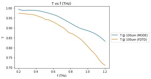

I am trying to simulate mode loss for a waveguide and the units I get for loss are dB/mm, but I want to convert the units to just mm^-1 so I can the absorption (α) value. I am guessing there is a specific value that I need to either multiply or divide my values with, but I'm just not sure what that value is.

The equation I have is T = I_0 * e^{-x*α}, where T is the transmission and α the absorption coefficient. Essentially, I need graphs that show α vs frequency, but I'm just having trouble with converting the units, as I mentioned in the question.
Are you considering the power, or the electric or magnetic field?
What is the form of your equation given dB?
Do you use; dB =10⋅Log(power ratio); or, dB = 20⋅Log(amplitude ratio) .

Hi, I have these 2 equations: V=V_0*e^(-αL) and V=V_0*10^(-α_dB*L/20) where α_dB is loss in dB/mm and α is attenuation which has 1/mm units. When I solve for α, I get α = α_dB*ln(10)/20, but when I use
T = T_0 * e^{-L*α} to convert it to transmission, the values are not correct. The image shows a plot of what I'm trying to achieve. I want to match the MODE with the FDTD transmission. When I divide by 10 rather than 20, I get the correct values, but I can't seem to find these equations anywhere to check if they are correct. Am I using the correct equations? Where do the first 2 equations come from, it's still not clear for me?

I have tried this before, here is the code
Code:
tra1filedata = genfromtxt("T vs f (1mm L=100).txt") #transmission data from FDTD
lossfiledata = genfromtxt("loss vs f xspan 200.txt") #loss data from MODE
loss_dB = lossfiledata[:,1]/1000
lambda_0 = 0.25*2.27 #wavelength
kappa = (loss_dB*lambda_0)/(20*2*np.pi*0.43)
k0 = (2*np.pi*2.27 + kappa*1j)/lambda_0
alpha1 = 2*kappa*k0
alpha2 = 10**(loss_dB/10)
alpha = loss_dB*((math.log(10))/20)
T = np.exp(alpha1*-1*0.1) #transmission converted from loss MODE
plt.plot(lossfiledata[:,0]*1e-12, T, label = "T @ 100um (MODE)");
plt.plot(tra1filedata[:, 0]*10e-13, tra1filedata[:, 1], label="T @ 100um (FDTD)");
For the GaAs I'm simulating, the refractive index is 3.6 and the imaginary refractive index is 0.01.
But then I'm not exactly sure how to plot it or if the code I wrote so far is correct. As you can see, I tried 3 different equations for alpha, and none of them have yielded the result I want. Would I still need to use
T = T_0 * e^{-L*α}? Because I'm essentially trying to convert the loss data from MODE to match with the transmission data from FDTD. I know the simulations are correct because the loss from both methods matches, so the error must be in the equations I'm using, I'm just not sure what it is.
I am not good at code, but I don't see these refractive index values being used in your code. You need to include them in the calculations. Also is this a plane wave with linear loss? or is there an exponential factor? (as Baluncore suggested with E vs P)
