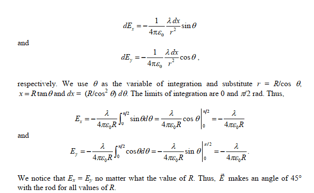

How can I find "dx" in a straight line of electric charge?(Details in Picture)
r=R/cos(teta)
x=rtan(teta)

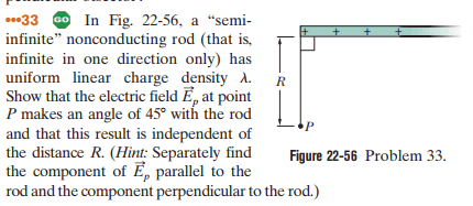

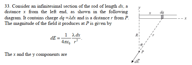

This is the question ... I have it's solution ...
My problem : I can't understand why dx=R/cos^2(teta) dteta
I have thought many hours but I couldn't find it's reason ... Can anyone please help with this ?!
If ##x = R\tan{\theta}##, then ##dx/d\theta= \dots##
Likes vanhees71 and MatinSAR
I got it ... I have learned this in a wrong way but now I know what was wrong ... Thanks a lot 🌷
