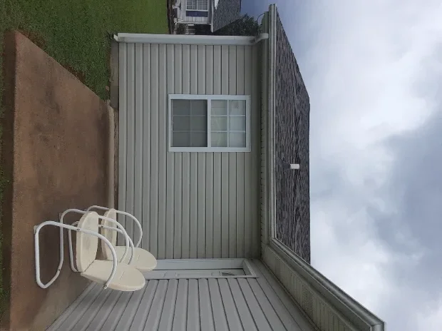

I am a long distance truck driver, but I recently completed a plumbing program with Stratford Career Institute. In the chapter of my textbook Repairing DWV Systems, the author says that if there is a clog in the building drain, one can clear out the clog by using a snake augur or maybe some other type of tool into the cleanout for the building drain. The author said that the cleanout for the building drain is usually near the stack.
I live in a duplex townhouse. Just out of curiosity, I would like to locate the cleanout for my building drain. Today I am on hometime from my trucking job, and I went to my house and looked for my building drain. I don't think that I found the cleanout for the building drain. There is a 3" or 4" diamater plastic pipe coming out of my house at the back of my house. This 3" or 4" diameter plastic pipe coming out of my roof might be the stack. But there is no cleanout for a building drain directly below this plastic pipe that might be my stack.
My townhouse is built on a slab foundation. So there is no basement or crawl space.

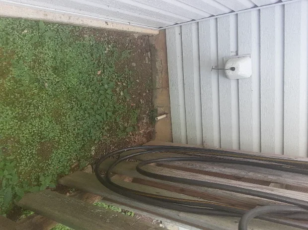

There is a 1/2" or 3/4" diameter plastic drainage pipe coming out of my wall in my backyard, but it is not directly below the stack. Below are two photographs of this 1/2" or 3/4" diameter plastic drainage pipe coming out of the wall in my backyard. One photograph is a close up photograph, and the other photograph is more zoomed out.
For some unknown reason, PhysicsForums rotated my photographs 90 degrees to the clockwise.
Do you think that the 1/2" or 3/4" diamater plastic pipe in the photographs above is the cleanout for my building drain? If not, how can I find the cleanout for my building drain? Is it possible that there is no cleanout for my building drain? If there is no cleanout for my building drain, how would a plumber clear out a clog in my building drain?
It just occurred to me that some people might think that the plastic pipe in the photographs in the OP are my A/C condensate line.
I know where my A/C condensate line is at my house. The plastic pipe in the photographs in the OP is not my A/C condensate line.
That PVC pipe sems to be located next to a condenser unit or heat pump.
That location is typical of a condensate or overflow pipe coming from an air handler unit.

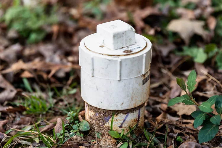

The clean out port you are looking for should look like a plug in a 3 or 4-inch tee.
It is normally located at grade level around one foot from the exterior wall.
It could also be found in an exterior wall (vertical drain pipe in the wall) or flush with a driveway surface (brass cover).
Please, see:
https://redcapnow.com/help-guides/where-is-the-sewer-cleanout-in-my-florida-home
Do cleanouts for building drains always look like the white plastic pipe in the photograph that you posted on post #3 on this thread? I have not seen anything that looks like that in my yard.
I wonder if the cleanout for my building drain might be buried underground.
Extremely unlikely. Some kind of overflow pipe, at most.

That small pipe can't possibly be a clean out. It looks like my sump pump discharge.
To me it looks like the outlet of the water heater relief valve.
Likes Herman Trivilino, russ_watters and sevensages
That definitely makes sense to me because one time about 3 years ago, my pressure reducing valve, my T/P relief valve on my water heater, and the expansion tank on my water heater all became defective simultaneously due to a water surge, and water started pouring out of the plastic pipe in the photographs in the OP.

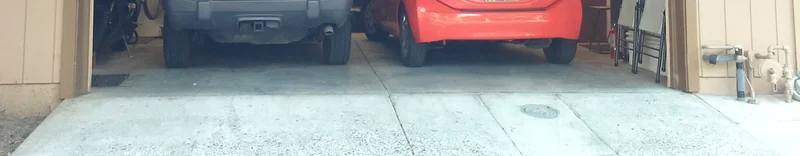

See another type in the link provided in that post.
A flat bronze cover is used in areas where vehicles can run over it.
Yes, it is probably buried under vegetation and dirt.
The underground pipe leading to the point of connection with the main sewer pipe running below and along the street is normally located on the side of the house that is opposed to the water meter and the underground water supply pipe.
You should be able to see a round iron disc that covers another clean out port located at your property line along the street.
That should have stamped the Sewer fonts on it.

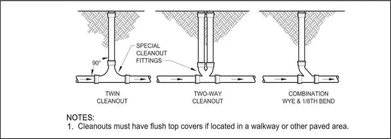

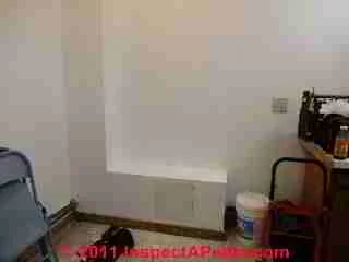

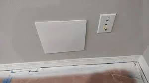

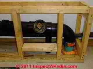

Yup. The first cleanout access point should be close to that pipe: maybe at the bottom of it, maybe just close: might be covered by drywall (with only a small door visible).
Like these:
(source)
Or:
Some may be on the floor:
Likes russ_watters, berkeman, sophiecentaur and 1 other person
Like these:
View attachment 364365 =>View attachment 364366
(source)
Or:
View attachment 364367=> View attachment 364368
Some may be on the floor: View attachment 364369

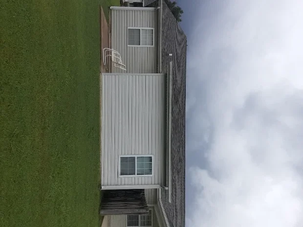

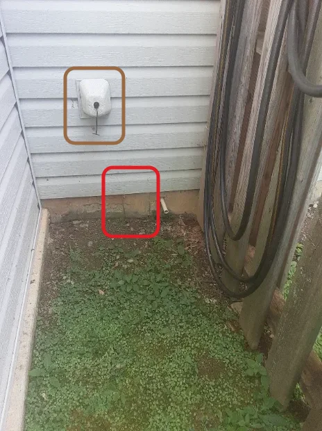

On this picture:
The marked parts looks suspicious too.

On this picture:
All there is behind that insulation cap is a water faucet, not a cleanout. I know that because I am the person who installed that insulation cap.
When you say "The marked parts look suspicious too", do you mean that area you put in a red colored rectangle looks like there might be a cleanout behind it?
Edited to add: I am viewing the photo on a cell phone with a small screen. At first, I had no idea why you inserted that red colored rectangle there. But then I looked at the photo in my gallery on my cell instead of looking at the photo via this message board. I was able to zoom in the photo when I looked at it in my gallery. I now see the two vertical cracks or lines in that wall. Do you think that my cleanout might be behind there? The area of that photo that you put in the red rectangle is about 25 or 30 feet to the side of my stack.
No idea, but it looks like there was some happenings with the foundation there. And at this point it's already a detective story, so every clue counts.

You can see a photograph of the side of my house and my stack in post #17. You can see that my exterior walls have siding.
Do you think that the cleanout for my building drain might be on the exterior wall below the stack and underneath the siding?
I do not 'think'. I only see it possible.

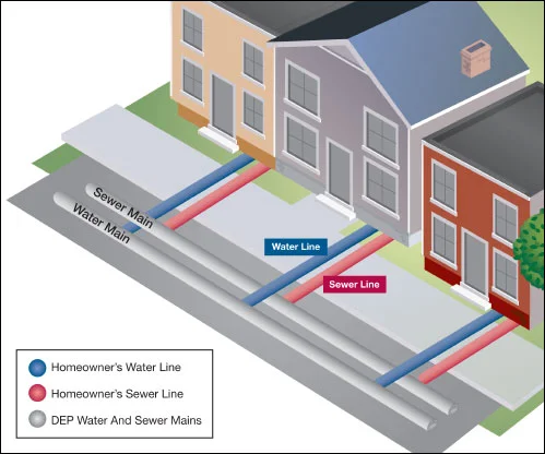

Interesting. Both neighbors say in the front yard. That implies that the city main is on the opposite side of the house. Unless the clean-out is only concerned from that point to the street.
  • #35
When you say, that implies that the city main is on the opposite side of the house, do you mean that that implies that the city sewer main is on the opposite side of the house?
  • #36
Uh, yeah that's what I said. To be a clean-out for the "building" as you put it, it is implied that the snake goes into the clean-out, under the house towards the city main. I would have assumed the city sewer main is under the street. Of course that could be an incorrect assumption.

The 3-inch sanitary drain clean-out port is normally located at grade level, as close to the exterior wall as possible, in order to reach farther into the house, but not closer than one foot, so the plumbing snake can be easily fed also into the sewer main direction (commonly, there is a 2-way tee connecting the clean-out vertical pipe and the underground drain pipe).
Please, see:
https://up.codes/s/cleanouts-for-drain-piping
Regarding location of underground water supply, storm and sewer main pipes, could the underground layout be like this?
Yes. The underground layout of my sewer line and water line could be like that. Indeed, I think that the underground layout of my sewer line and water line is probably like that.

That's likely where it is. Probably just below grade. Poke around with a shovel.

Please look at the photographs I posted on post #17. Notice that my concrete patio is directly below my stack. So I cannot poke around directly below my stack with a shovel because that area is concrete.
