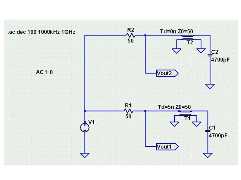

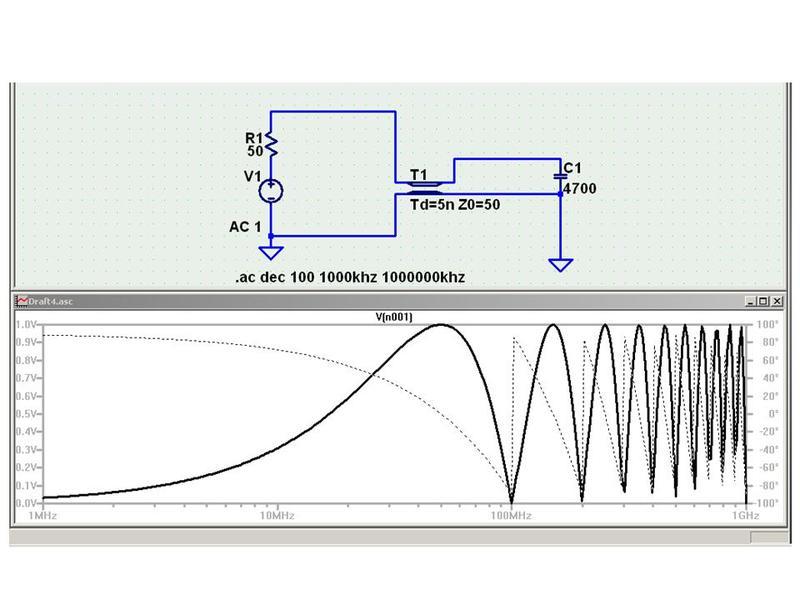

Here is a Spice model of a 4700 pF capacitor on the end of a 5 ns, 50 ohm cable. (1 meter coax with beta = 0.67 is 5 ns delay). The frequency sweep is from 1 MHz to 1 GHz. See thumbnail. At 1 MHz, the phase angle is 90 degrees (capacitive), and at 10 MHz it is only about 70 degrees (due to 5 ns coax cable). At 60 MHz iimpedance phase goes thru 0 degrees (real impedance).

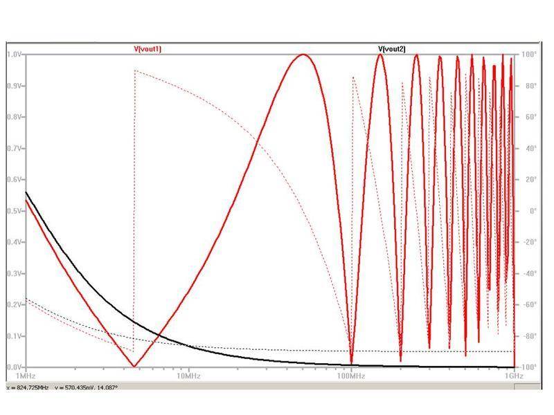

Here are two thumbnails. The second is a thumbnail of the two circuits I am measuring, one over the other. Both are terminated in 4700 pF. The top one has a zero length transmission line. The bottom one has a 1 meter (5 ns), 50 ohm (e.g., RG-8) transmission line. The voltage source has zero impedance, so the voltage measurements in the two circuits are completely decoupled. The 50 ohm series resistor is to absorb all reflections. The two measurement points are between the 50 ohm resistors and the transmission lines. In the two curves in the next thumbnail, the black curve represents the zero length transmission line, and the red represents the 5 ns delay line.
The frequency sweep in the plot extends from 1 MHz to 1 GHz. The black line represents the 4700 pF capacitor with the zero length delay line. The voltage across it drops monotonically from about 0.5 volts to zero. The phase remains capacitive. The red line represents a 4700 pF capacitor at the end of a 5 ns, 50 ohm delay line. The first zero amplitude point represents a series resonance with the inductance of the delay line and the capacitor. I have checked this by varying both the transmission line length and the capacitor value. The first max amplitude (open circuit) at 50 MHz is a quarter wave "impedance transformer" of the capacitance. The impedance at this point should be (50 ohms)2*jwC. The next zero at 100 MHz is the half-wave point which "moves" (transforms) the capacitor impedance to the measurement point. It is apparent even at 1 MHz, that there is a difference between the two curves, which could be due to the shunt capacitance of the 5 ns delay line. However, at about 5 MHZ, the red line changes from capacitive to inductive. It is very apparent that any measurement with a 5 ns delay line above several MHz is not trustworthy.

Hi Bob,
Thanks for clarifying that. I tried it with metre of 50 ohm coax and a 3700 pF capacitor (actual C...marked 4700 pF) and got similar results measuring total Z with an antenna analyser. I got a minimum at about 4 MHz when the impedance with transmission line started to rise again after falling since DC.
MHz...no TL...TL
1.....46....42
2.....28....23
3.....22....17
4.....17....14
5.....15....16
6.....14....18
7.....12....23
8.....11....26
9.....14....30
10....15...33
