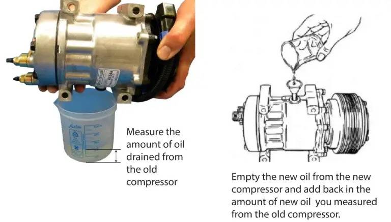

jack action said:
But the A/C unit is next to a hot engine
If you are familiar with them - how are the lubrication works for such an A/C unit in a car?
Is it hooked to the main oil pump?
Common outdoor A/C units has just that common 'sitting in a bucket with oil' kind of compressor.
No. I has a closed system like all other refrigeration devices.
This is why they tell you to leave the unit to settle when it's been moved around or you could get oil blocking the heat matrix.
