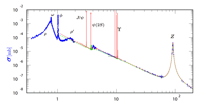

Can you point to this place?
(Electron-positron cross section)
I can't fathom what the graph shows. What are the axis titles and units? In particular "mb"? I would have moaned at my students for leaving out / assuming such information - and how about a title? :smile:
mb = millibarns = 10^-31 m^2
Millibarns, a unit of cross section, and the x-axis is the center of mass energy in GeV.
The title was written above the image.
I didn't make the graph, and that was the nicest-looking I found with a quick search.
But you made the post and included the image. I imagine you wanted to get some message across with it. If you don't actually want to help then why bother posting?
What is the x-axis and what would the units be? kWh / Joules / Bthu?
I can see there are some peaks and an 'inverted well' shape. It may all be blindingly obvious to you but it may not be to all your readers.
Sorry to be grumpy but I am on this thread in the hope of getting to understand the subject (as well as having a friendly conversation).
GeV, see above.
The scale doesn't matter here. The main point is that the plot is full of features, but none of them looks like what you were looking for.

mfb said:
GeV, see above.
Oh yes, I see now.
mfb said:
Your approach doesn't work at all.
I was just trying to interpret the suggestion (?) in Post #20 from Vanadium. So how can you find or estimate the 'size' from that data in your post? Could you inject just a tad of positive into your reply? Saying how something could be done is much more useful than saying another thing just won't work. I know there are a lot of people on PF who know more than I (or even you) do in some areas but what do we post here for?
You cannot, that is the point. If electrons would have something like a classical size you could, but they do not have this.

I think that's as much as we can expect and I can cope with that idea. It's actually all we get from any cross section measurement. As far as I remember, talk of an electron cross section seems to be in terms of an upper limit - as in "it must be smaller than this value".
I could understand that the cross section would be different for different interactions - eg for charged and non charged particles but that could be the same for proton / proton cross section and proton / neutron cross section and how it could relate to the KE of an electron. My (mis?)conception is based on a though experiment of what would happen for two beams of electrons fired at one another. The distribution of the scattered beams would depend on the KE, the higher the KE, the narrower would be the 'shadow' of an emerging beam. But you are telling me that would fall down once the energies got high enough. (is that what the graph you posted shows?)
  • #34
You get various bumps in the spectrum from the production of new particles at their mass, you get steps from additional reactions that become possible above some thresholds, and similar effects. None of these things have anything to do with a size of an electron.
  • #35
But I have always been referring to scattering - which implies direction, not the energies involved. (As with Rutherford scattering and the size of the atom)
