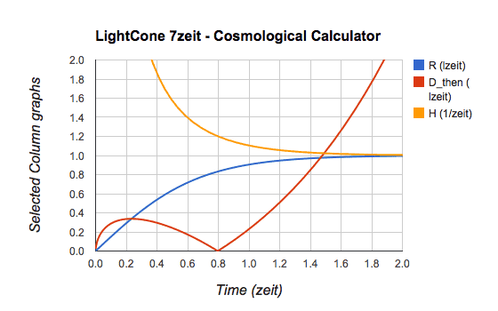

Just to illustrate what Bander said. In the standard cosmic model the Hubble rate H(t) is always declining but is beginning to kind of level out. This plot shows the history of H up to the present (which is t=0.8 on this scale) and then on into the future.
And the plot shows the history of a photon which is heading towards us since very early times, but is at first swept back by expansion, until around t=0.234, and then since H declines enough, it begins to make progress.
The photon is the red curve. It arrives here at the present day (t = 0.8) and then goes on past us into the future.
the blue curve is the Hubble radius, it is essentially the reciprocal of the Hubble rate--one over H. So it has been increasing as H decreases, and will continue to increase (according to standard cosmic model).

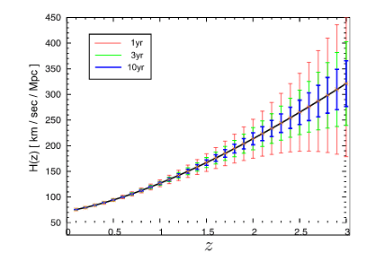

To see the evolution of Hubble constant you need a graph plotting H against redshift (or time, or distance).
Such as this one:
(never mind the error bars. You can read more about it in the paper: http://arxiv.org/abs/1011.5000)
(and I see marcus was faster this time! :) )
Likes marcus and Stephanus
  • #31
Stephanus said:
And...?
What if the Hubble constant go down even <0?
The big crunch?
That is right, as a "what if". In models where the universe contracts the H is negative. But the change in H has been observed over time and the evidence is that although it has indeed been decreasing it is not tending to zero, or into negative territory! It is leveling out at a positive value.
(that is what is beginning to cause acceleration in individual distance growth speeds)
You can see the leveling out in the plot.
Likes Stephanus
