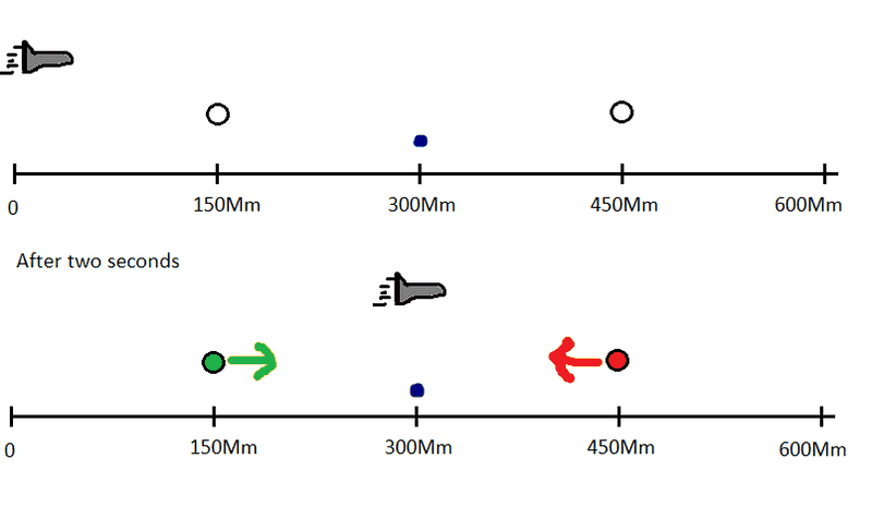

A similar picture here. It's similar to the "train example" on relativity of simultaneity.
We are placed on where the dark-blue dot is in the picture. The speed of rocket relative to us is 150 Mm/sec (0.5 c).
After two seconds when the rocket is in between two big lamps, the lamps send light waves simultaneously, red and green light.
Here's a schematic picture from our coordinates:
We see that the lamps send light simultaneously, and both reach us at the same time. But we see that the red light reaches the rocket before the green light.
But the astronauts in the rocket won't observe that both lamps send light simultaneously. They'll observe that the red lamp send light first, then the green lamp send the red light later.
For astronauts, it's the universe, us (the blue dot) and the lamps that are moving with a velocity of -150Mm/sec while they're on rest.
And they'll observe the distance between the lamps to be less than 300 Mm.
We'll observe the source of both light coming as 150Mm away from us.
But how will astronauts see the distance between the rocket and the light sources?
But will the astronauts observe both source of light having equal distance from the blue dot?
I mean will the astronauts observe that the blue dot is placed in the center (in the middle) of the of light sources?
Or will astronauts observe their rocket in the middle of the light sources?

Karagoz said:
Distance between the rocket and the light source; is it observed differently for us and for astrounts?
Your space-time diagram shows the lights starting simultaneously in the ship coordinates. The lights beams and the ship all meet at 3 seconds after the start on the ship clocks. This meeting will happen in all frames.
You can read off all the answers to your questions from the diagram. In our frame the lights do not start simultaneously.

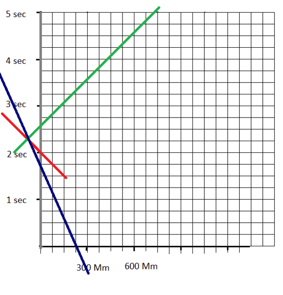

Sorry for not clarifying things. In the post #7 the diagram and picture shows another case and event than what the picture in post #1 shows. They picture the event from our coordinates. The grey line is the rocket (which is moving), the blue straight line is the blue dot (where we are observing the event). We are at rest in our coordinates, so the blue line is straight.
[I have drawn these images myself using Paint, this is why they're so amateurish and not exact].
From the formula:
t' = ϒt - ϒβx
x' = ϒx - ϒβt
If we express the coordinates as (x,t).
So in our coordinates, the red lamps sends the light at (1.5, 2) and green lamp sends the light at (0.5, 2).
The Lorentz factor here is: ϒ = 1/√(1-0.5^2) = 1.1547.
β = v/c = 150,000 / 300,000 = 0.5Starting point of the red light in astronaut's coordinates:
t' = ϒt - ϒβx = 1.1547*2 - 1.1547*0.5*1.5 = 1.443375
x' = ϒx - ϒβt = 1.1547*1.5 - 1.1547*0.5*2 = 0.57735
Starting point of the green light in astronaut's coordinates:
t' = ϒt - ϒβx = 1.1547*2 - 1.1547*0.5*0.5 = 2.020725
x' = ϒx - ϒβt = 1.1547*0.5 - 1.1547*0.5*2 = -0.57735
In our coordinates:
The red light starts from (1.5, 2) (1.5 light seconds from the origo, and after 2 seconds).
The green light starts from (0.5, 2).
But in rocket's coordinates:
The red light starts from (0.5773, 1.4433)
The green light starts from (-0.5773, 2.0207)
In our coordinates the lights hit us at (1, 2.5). In the rocket's coordinates the lights hit us at:
t' = ϒt - ϒβx = 1.1547*2.5 - 1.1547*0.5*1 = 2.3094
x' = ϒx - ϒβt = 1.1547*1 - 1.1547*0.5*2.5 = -0.2887
In our coordinates we stay at (1, 0) when t = 0 in our time. In rocket's coordinates we stay at:
x' = ϒx - ϒβt = 1.1547*1 - 1.1547*0.5*0 = 1.1547.
Then the time in rocket's coordinates are:
t' = ϒt - ϒβx = 1.1547*0 - 1.1547*0.5*1 = -0.5773
Is the calculations correct?
Here's the rocket's coordinates. The grey straight line is the rocket, since it's the rocket's coordinates the rocket is at rest relative to itself (I think one is always at rest relative to itself right?), but we (represented in blue line) are moving relative to the rocket.
Is this drawing correct?
I don't have time to check each point but your diagram looks correct. It is similar to the second diagram in post#6. Your calculation shows that that the red light starts earlier than the green light in the spaceship coordinates.
I hope you can see how the LT let's us calculate the coordinates of events for any inertial observer.
This transformation is passive because nothing changes - the coordinates are describing the same events.
The sort of questions you have asked can usually be answered by using the LT.
An interesting calculation is to transform ##t^2-x^2## to ##{t'}^2-{x'}^2## using the LT I gave. Do it algebraically and you'll get a surprise (maybe).
