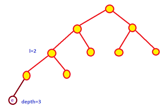

Suppose that we have a binary tree and a specific level $l$.
I want to add in the tree, a node $e$, as a child of the leftmost node of the level $l$, if the latter hasn't two children. If the leftmost node of the level $l$ has two children, then we have to look for a leftmost node, with less than two children, at the next levels and $e$ will be the child of the first such node, that will be found.
How can we add a node in a tree? (Thinking)

Hey! (Smile)
If it's a binary tree, we should have something like:
Code:
struct Node {
  int value;
  struct Node *left;
  struct Node *right;
struct Node *tree;
Suppose you have found the [m]node[/m] where you want to add a the node [m]e[/m] as a child to the left, then you can add it with:
Code:
node->left = e;
I'm assuming here that there was no left child yet.
There you go! (Happy)
You must assume there is such a node at level l. So first find the left most node at level l:
Oops. I need to think about how to find such a node. The only thing I can think of is to do a level traversal of the tree with a queue. So assume q is an initially empty queue that can store a node and an integer.
Code:
q.add(root,0);
while (true) {
  q.remove(p,d);
  if (d == l) {
    break;
  if (p.left != null) {
    q.add(p.left,d+1);
  if (p.right != null) {
    q.add(p.right,d+1);
Now p is the left most node at level l.
Next as long as node p has two children continue the above loop to find the node p where e is to be attachedt -- left to you. Finally attach e as either the left child or right child of p.

So, is the use of a queue necessary? (Thinking)
I would prefer a recursive function.
It might look like:
Code:
Add_node_leftmost_at_least_at_level(node, l, e, depth)
  /* Handle final failure case */
  if node == NULL
    return failure
  /* Handle final success cases */
  if depth >= l and node->left == NULL
    node->left = e
    return success
  if depth >= l and node->right == NULL
    node->right = e
    return success
  /* Recurse first left, then right */
  result = Add_node_leftmost_at_least_at_level(node->left, l, e, depth + 1)
  if result is failure
    result = Add_node_leftmost_at_least_at_level(node->right, l, e, depth + 1)
  return result
and it should be called with
Code:
Add_node_leftmost_at_least_at_level(tree, l, e, 0)
(Thinking)

I did it:
Code:
1.depth=0
2.Add_node_leftmost_at_least_at_level(node, l, e)
3.  if node == NULL
4.    return failure
5.  if depth >= l and node->left == NULL
6.    node->left = e
7.    return success
8.  else if depth >= l and node->right == NULL
9.    node->right = e
10.    return success
   else
11.  depth=depth+1
12.  result = Add_node_leftmost_at_least_at_level(node->left, l, e)
13.  if result is failure
14.    result = Add_node_leftmost_at_least_at_level(node->right, l, e)
15.  return result
Is it right? (Thinking)
I applied it at an example and I got the right result:
(Happy)
I tried to calculate the complexity of the algorithm:
At line 1, there is 1 elementary command.
At line 2, there are T(n) elementary commands.
At line 3, there is 1 elementary command.
At line 4, there is 1 elementary command.
At line 5, there are 3 elementary commands.
At line 6, there are 2 elementary commands.
At line 7, there is 1 elementary command.
At line 8, there are 3 elementary commands.
At line 9, there are 2 elementary commands.
At line 10, there is 1 elementary command.
At line 11, there are 2 elementary commands.
At line 12, there are T(n-1)+1 elementary commands.
At line 13, there is 1 elementary command.
At line 14, there are T(n-1)+1 elementary commands.
At line 15, there is 1 elementary command.So, I found that the complexity is:
$$T(n)=\left\{\begin{matrix}
2 &,n=0 \\
2T(n-1)+11 & ,n>0
\end{matrix}\right.$$
Is it right or have I done something wrong? (Thinking)

Could you give me an example, at which the command [m] return failure; [/m] is executed? (Worried)
Suppose that we want to trace the algorithm for the following tree:
https://www.physicsforums.com/attachments/3631
depth=0
Add_node_leftmost_at_least_at_level(A, 2, e)
depth=1
result=Add_node_leftmost_at_least_at_level(B, 2, e)
depth=2
result=Add_node_leftmost_at_least_at_level(D, 2, e)
depth=3
result=Add_node_leftmost_at_least_at_level(F, 2, e)=success
How do we continue? Does each [m] result [/m] from the previous recursive calls get the value [m] success [/m] ? Or what happens? (Worried)
depth=0
depth=1
depth=2
depth=3
That is what should happen yes.
