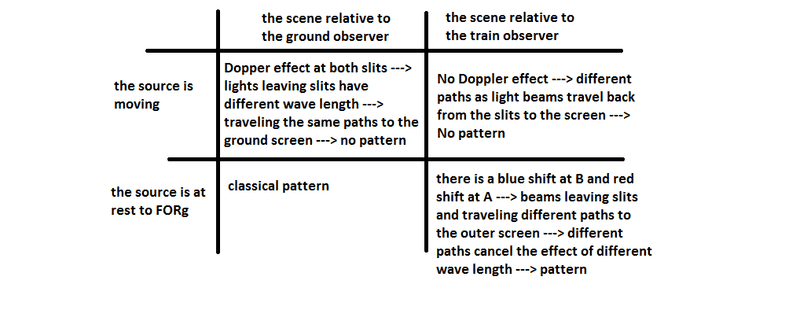

I would like to know if I am right in this:
There are 2 ways to label the state of motion of the source relative to the ground, either moves or fixed at the time of radiating light beams
There are also 2 ways to see the possible pattern on the ground screen, either seen by the ground observer or by the train observer
So, there are 4 possible ways to have a different state of motion of the source seen by different observers,,, here is the proposed diagram!
https://www.physicsforums.com/attachment.php?attachmentid=46334&stc=1&d=1334675354

  • #56

  • #57
I haven't done the math here, but I suspect that you won't get "no pattern" but rather a "moving pattern".
  • #58
Adel Makram said:
I suggested earlier that it will not form because the different wave length of light rays when leaving slits, due to Doppler effect, make the pattern impossible at the ground screen
Doppler shift alone will not necessarily eliminate a pattern. If doppler shift were to cause a frequency difference between the two sources then the way the interference pattern would appear would be changed. For instance, since you have light reflecting off mirrors it is polarized light and will create a straight up/down type of interference pattern. If one beam is a slightly different frequency, there will be a constant fringe shift to one side if it is a small change in frequency of only a few percent. Over roughly ten percent difference and the pattern will change so rapidly that there will no longer be one detectable or there may simply be a beat pattern.
Adel Makram said:
Now, how if I make the source at rest relative to the ground observer, while I maintain the same location of the source but this time on the ground. This will be the classical version of the interference pattern. In this case, will there be a Doppler effect at slits which exclude the pattern on the ground screen? Or the slits just act as a window of transmission of light waves and allow the pattern to form?
And why there is a difference in the formation of the pattern in two cases, if any? As long as the light is emitted any way no matter what was the state of motion of the source at the moment of emitting the beams?
Slits will act like a place of "re-transmission" for your beams regardless of their frequency or wavelength. The disturbance of the pattern is because of the difference between wavelengths or because of a difference in the phase.
Interference is all about the way the peaks and troughs line up. With differing wavelengths there is a beat pattern of lining up and not lining up.
The diagrams on this page http://en.wikipedia.org/wiki/Fringe_shift make it easier to understand mechanically.

  • #60

  • #61
Adel Makram said:
I am concerned about a fixed pattern on a ground
Then I would recommend modifying your chart to say "no fixed pattern" (which is correct) rather than just "no pattern" (which may not be correct).
