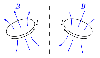

This is true tough:
M(a) x M(b) = -M(a x b)
where a, b are vectors in 3D, while M is a mirror transformation.
So if you have something defined via the cross product, like torque, and you mirror your scenario, then you also have to negate the torque.

This is true tough:

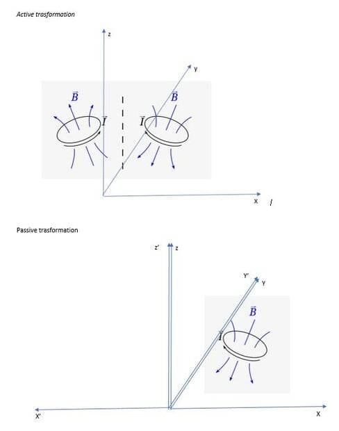

Hi A.T. thanks for rising That point.. I do not understand example whith mirrors.. as it is not completely clear what, when using it, it does rellay means.. I look on a mirror an experiment and I use the "real world" base vectors or I look inside the mirror .. see a different pointing vector and a different base vector... By my side it is somenthing that doesn't help speacking the same language... then I would say .. is the world seen on a mirrorr useful for some undestanding on mecchanics or electromagnetics? I would say no.. Then: is what I see on a mirror thru? My dog doesn't recognioce itself on a mirror ( on Tv do not recognize dogs too).. My heart appear on the left in a mirror , but I'm sure it is on the rigth.. So I do not understand.. I like the language of math if we want to use math to do physics. If we want to consider mirror ( transformation) is ok, however I would like to better understand what you mean with it.. indeed the M(.) operator you used.. could you better specify it? what does it mean mirroring a vector? is that a coordinate/ base-vector trasformation.. so is it a "passive" trasformation ( trasformation of the observer) or an "active" one ( trasformation of the system/ object) or no of the privious one.. My concern agaisnt Griffiths text is on passive coordiante trasformation ( namely the observer change coordinate sistem to reppresent vectors). so what mathematical operation I have to intend when you say M(a)..what happen to coordiantes, ( real or mirrored) to base vectors ( real /mirrored) to components of a vector ( real / mirrores)..?

Hi PeroK,
I have an issue with your text .. I do not se properly the latex formulas ( eg I see ##c' \ne a' \times b'## ??????).
However I do not uderstand even at your beginning when you say "...we do a transformation such that every vector is mapped to the negative" ... I do not understand what map does mean.. in my question and diisagreement with Griffiths I refer to coordinate system trasformation ( that some author refer as passsive trasformation , namely of the observer).. This kind of operation left the object vector unchanged... what change is its rappresentation... if toghether with the coordinates you change the choice of the basae vactors than the components of the vector for that new base change them selfs accordingly ( I do no want now to better call covariant and controvariant words) .. hovever the two trasformation ( of base vectors and components works toghether for having the same geometrical object.
When you say that a vector is mapped on the negative I do not clearly understand wht you mean... it sounds more that I identify the vector with its negative... but this is not, in my opinion, a passive trasormation ( trasformation of the observer namely of the coordiante system). .may be it is an active one.. " you force changing the sign of the vector" may be... please ...kindly better clarify "map in to the negative"
I meant the transformation that maps the components ##(x,y,z)## to components ##(-x,-y,-z)##.

Here, when you mirror ##\vec{I}##, then ##\vec{B}## is not just mirrored, but mirrored and negated. So ##\vec{I}## and ##\vec{B}## behave differently under a mirror transformation.
This anti-symmetric behavior might seem somewhat weird. But it becomes clearer, when you consider that in physics we (mis)use the result of a cross-product (a vector) to represent something which might be better understood as the result of an exterior-product (a bi-vector):
https://en.wikipedia.org/wiki/Pseudovector#Geometric_algebra
It's also important to note, that the actual observable physics is perfectly symmetric between the two mirrored cases above. If you shoot electrons with symmetric initial velocities through each ##\vec{B}## field , their deflections and thus paths will be symmetric. It's only that not directly observable quantity ##\vec{B}##, whose mathematical representation was chosen by a non-symmetric convention, that unsurprisingly breaks the symmetry. But only in our diagrams and calculations.

Hi A.T.
thank you for your reply..
I agree with you that in your example "Here, when you mirror �→, then �→ is not just mirrored, but mirrored and negated. So �→ and �→ behave differently under a mirror transformation."
However I want to ask you a question about that example : are the the two skeched "I" in your picture the same phisical object (made by the same moving electrons) or are they two different objects, one being the mirrored version of the other?
If your replay will confirm that they are " two different object ... each the mirrored of the other" then I think to understand what is the misunderstanding. The metter is explained by at least two text "Mathematical Methods for Physics and Engineering" ( Riley, Bence etc) at page 948 and also in " Classical Electrodynamics" ( John David Jackson) at page 267 and following.
We need therefore to agree on the meaning of "trasformation". The authors talk about "active" and "passive" trasformation. and depending on what of the two concept you apply then you end up with different assesment.
Considering the above classification you are refferring to "active trasformation" while my questino was about "passive trasformation"
I try to skech the question in the attached jpeg.
In the active trasformation you have two "I" currrents loop and two "B" magnetic fields.
For each element of the "I" on the left, let call it "dI", positioned at (x1, y1,z1) you have a correspondent element mirrored dI_mirrored at (-x1,y1,z1) .. and in a similar way for the B fields.
You are rigth when say that I and B behave differently when considering their mirrored "alter ego" and this is remarcable... and probably is for this reason that the concept of axial vector ( pseudovector) and polar vector (vector) is usefull. However in this scenario there is only one observer ( system of coordinate x,y,z and only one base vectors) and a specifc system situation of a current and another current which is the mirrored of the first one..
In the passive trasformation instead you consider only one current I and the generated B field.. there are no other entities mirrored.. However now you condisder two different observer each of them have decided of fixing a different coordinate system. In particular observer two decided for the same y and z axis but liked to have the x axse fliped.. Also in this case there is an invertion of coordinates and of vector components. indeed the generic infinitesimal element of "I" . let call it "dI" is positioned at coordinate (x1,y1,z1) as seen from the first observer and at coordinate (-x1,y1,z1) as seen from the second observer..
The two circumstances are complitely a different situation.....
In the active trasformation you have only one observer ( cordinate system) and two surces (currents i and I mirrored).
the passive trasformation is simply the different point of view of two observer looking only one surce ( current I). In the passive trasformation you ave mirrored coordinate and mirrored base vectors associated to the two cordinate systems.. then you see only one source "I" and the only effect being the "B" fields..
The unique B fields is always hte same for the two observer..
My questioning, from the beginning is that some authors define the concept of pseudovector based on the trasformation of coordinate system ( indeed a passive trasformation... indeed when a different observer look at the experiment having fixed another reference system of coordinates).. I think that this assesment of that authors was not correct.
Your point is correct as it is referred to another meaning of the concept of "trasformation" ( the active one)
Here's what I think.
The whole issue depends on whether the laws of physics are the same in a mirror system. The situation with the active transformation is clear. The cross product produces a pseudovector that transforms differently from a vector.
In the passive transformation, there is no change to the physical system. But, for reasons that I don't fully understand, the cross product changes to follow the left-hand rule in the case of a reflection (improper transformation). I guess if it didn't, then the results for active and passive transformations would be different.
What I wrote here:
Applies regardless if M represents an active or passive mirror transformation. A transformation matrix doesn't encode the type of transformation. So regardless if you interpret it as active or passive mirror transformation, you will get some inconsistency, because:
M(a) x M(b) ≠ M(a x b)
In your diagram below, the passively transformed I-vectors and loop-positions in the primed frame (bottom diagram), will have the same numerical components, as the actively transformed I-vectors and loop-positions on the left in the top diagram. So if you apply the same cross-product-definition to both, you get a B-vector pointing up (positve Z) for both. But for the passive case (bottom diagram), that contradicts the passively transformed B-vector which still points down (negative Z).
So regardless if you do an active or passive mirror transformation, you have to flip the pseudo-vectors, if you want to preserve the cross-product-definition.

what I'm saying is ( only appling to the case of passive trasformation) that the second observer knows that his base vector is left handed and therefore he should be aware that the determinant rule is not the rigth formula for calculating the cross product . For that reference system the rigth formula is the determinant rule and a minus sign after that.. if in the primed system of reference you do not do that and you use " the same rule for dot product" you would get also that i' x j' = k' while i' x j' = -k'
I do not see inconsistency and need of pseudovector.. only I need to say that determinant rule do not applies if the observer adopt a
left handed vector base.
Different thing is the atctive trasformation.. in this case the components of the involved vectors are mirrored ( x changed of sign in the example) however the base vector is still the same for the two dfferent set (current / displacement) of object.
otherwise i have the question:
Your example understand the Biot- Savart rule... which is an integral... looking to just the integrand it is a cross product... so... if an ionconsistecy there is ( as you say) it shoulod be for any cross product of any vectors.
I arrive to the conclusion that any vector of the base vector is a pseudovector... that becouse alltought they are not defined by the cross product however the cross product relation exist...
indeed i x j = k and j x k =i and k x i = j
are therefore i j k pseudovector too
How do you know your basis vectors are right or left handed? How do you know which is your right hand and which is your left? There is nothing mathematically to tell you. There would be nothing mathematically wrong with the determinant rule. The other observer would have no way to tell he was using a "wrong-handed" system of coordinates. He would simply be working with a different sign convention for angular momentum and magnetic field.
It's only when you compare the sign convention of the two observers you see that the differences.
  • #45
Aleberto69 said:
" ..So if you apply the same cross-product-definition to both ".... do you understand the determinant rule?
... the second observer knows that his base vector is left handed and therefore he should be aware that the determinant rule is not the rigth formula for calculating the cross product .´´
It is the "right" formula, because that is how the cross product is defined, regardles of the handedness of the system.
Having two different formulas for cross product depending on the handedness of the system, would be an alternative, but it's not the current convention. Likely beacuse it would be inparctical to always keep the handedness of the system in mind, when doing vector physics. With the current convention you only have to consider it when you transfrom between two systems of different handedness. But you don't even have to know which system has which handedness, just that they differ as you can deduce from the transformation matrix, so you flip the pseudo-vectors.
