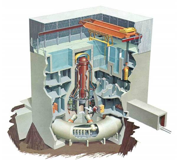

Is there any structure beneath the reactor vessel to catch the molten fuel if it burns it's way through the bottom of the reactor? Perhaps made from a material which will resist the white-hot 5,000+ degree heat from the molten fuel? So it won't burn it's way through the Earth and into the ground water creating "the china syndrome?"
The core is contained in the reactor vessel which is located in a concrete building I believe. I don't know the details though. I'm pretty sure there is something beneath it.
Roughly eight feet worth of reinforced steel and concrete. Apparently the containment structure in one of the reactor buildings was badly damaged. I thought these structures were designed to withstand almost anything.

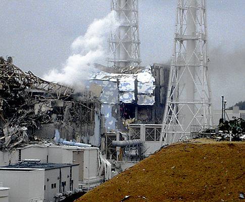

Do you think the reactor vessel itself in the below image which appears to have been devastated by an explosion (the one with smoke pouring out of it) has been comprimised?
That picture is from Reactor unit 4 I believe. The reactor vessel is believed to be undamaged and here is a picture of what it's suppose to look like.
What happened is the actual vessel is intact and undamaged. The roof blow off.
The reactor that has suspected vessel damage is reactor 2. They believe the Torus (The donut at the bottom of the picture) is cracked somewhere.

I don't trust what the media is saying about the condition of the reactors. I have a feeling the media both in Japan and elsewhere is downplaying the severity of this disaster. There's no way the reactor inside that decimated building (unit 4) isn't severely damaged. The cooling pumps and the pipework which supplies cooling water to the core have probably been destroyed in the hydrogen explosions.
It really isn't the reactors I'm concerned about, it's the some 600,000 spent nuclear fuel rods which are housed at the top floor of the reactor buildings. Apparently these rods pose a FAR greater radiological hazard than the worst thing that could possibly happen to the reactor core.
I believe the smoke pouring out of that reactor building is from the burning spent fuel, and not from the reactor itself.

The pumps providing cooling for the core is contained around the reactor. It is not in the part that was affected by the Hydrogen explosion. The core was not suspected to be damaged in units 1, 3, and 4. The major containment were not suspected to be damaged.
The smoke pouring out is suppose to be an oil fire from a pump (unrelated to the core) in the top level.

Last time I checked, uranium dioxide doesn't burn, nor does Zircaloy.

The building with steam pouring out of it has been nearly flattened. There isn't any way the containment structure and reactor vessel have not been severely compromised or even already destroyed. The other damaged reactor buildings are in much better shape, but it's (number 2?) I'm worried about.
