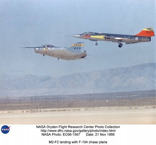

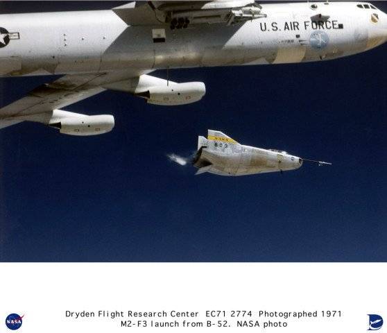

equal transit theory
These pictures of lifting bodies pretty much disprove this, plus I just think these are interesting because of the unusual design.
http://www.dfrc.nasa.gov/Gallery/Photo/M2-F2/Medium/EC66-1567.jpg
http://www.dfrc.nasa.gov/Gallery/Photo/M2-F3/Medium/EC71-2774.jpg

These pictures of lifting bodies(...)
That thing flies? Amazing! But wait till you see this...

True for most airfoils, but not all:
from
http://www.dfrc.nasa.gov/Gallery/Photo/index.html:

ccrummer said:
It's a reentry vehicle and it looks like it is not designed to gain altitude though. Is it powered?
M2-F2 was a glider so it wouldn't gain altitude. The M2-F3 was rocket powered and reached a maximum speed of mach 1.6, and could easily gain altitude.
The space shuttle doesn't have much lift either. Can you explain how it generates lift?
Downwards acceleration of air via diversion of relative air flow: an effective angle of attack, combined with forward speed. The amount of total lift is related to the diversion of the relative air flow both above and below an aircraft.
The drag is usually less if most of the diversion takes place above the aircraft via a reduction in pressure, since the reduction in pressure somewhat offsets the increase in kinetic energy, in a Bernoulli like exchange of pressure for kinetic energy. The other way to reduce drag is to reduce the kinetic energy added to the air, by accelerating more air at a lower rate (twice the air and half the acceleration results in half the kinetic energy) so long wingspans are generally more efficient than short wingspans.
Since the M2-F2 and M2-F3 were re-entry prototypes, a high lift to drag ratio wasn't a goal. In this case, a high drag factor reduces the time it takes between re-entry and landing.
