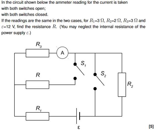

Relevant equations:
V=IR
Attempt at solution:
When the switches are open, R1, R2 and R3 are in series so the current in that case would be 12 V/ (2 ohms + 3 ohms + 3 ohms) = 1.5 A. When the switches are closed, the current across R3 is still 1.5 A, so the voltage drop across R3 is 1.5 A * 3 ohms = 4.5 V. I don't know how to calculate the voltage drops across other resistors and the currents through them. How do I proceed? I know we can ignore R2 when the switches are closed since it gets shorted, and I know R and R3 are in parallel when the switches are closed.
Your reasoning so far is correct.
Yes.
So, what is the voltage across R1? Apply KVL to the loop containing ε, R3 and R1.
Yes.
ε - (I*R1) - (1.5A *R3) = 12 V - (I*R1) - (1.5*3) = 0 therefore I*R1 = 7.5 V. The current across R1 is 7.5/3 = 2.5 A, therefore the current across R = 1 A. Since the voltage drop across R and R3 is the same (4.5 V), the resistance of R is 4.5/1 = 4.5 ohms. Is that correct?
It is perfect! :smile:

If we call the unknown resistance R, R4, then does everybody agree that this problem gives in general
R4/R1 = R3/R2
as the condition for currents in R3 equal for both cases?
A formula (recalling a bridge balancing condition) that seems to be 'suggestive' - but I don't know what it suggests. Can the circuits be switched around somehow to make it obvious what the answer should be? Is there some known principle involved? Duality or something?
