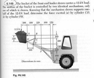

I am overwhelmed by this HW problem I have. Coming back from spring break, our professor blasted through the entire chapter covering analysis of structures, and then assigned this problem for HW (see attached).
I am completely stuck. I basically don't know if I am on the right track.
I started with part a) by trying to find the force (tension) pulling on member AB. I did this by calculating the moment about point D.
Md = 6kN * .3m = 1.8kNm (ccw)
I took this torque and used it to compute the x component of the tension at AB.
Md=Force*distance
Fab=Md / distance
Fab= 1.8kNm * .320m = 5.625kN to the left
Using this tension, I tried to find the x component of the force at point C by using the moment created at E by tension AB.
Me = .460m * 5.625kN = 2.59kNm (ccw)
Fcx = Me / distance
Fcx = 2.59kNm / .300m = 8.63kN
Finally, I try to compute the force along CD using the x component I just found (or think I found). I do this using the right triangle created between D, C and the horizontal from D. This gives me .4 along the horz, and .16 along the vertical. That gives a hypotenuse of 80*sqrt(29). Also, the angle created by DC with the horz is 21.8 degrees. By using similar triangles, I find the force along CD to be
Fcd=(80*sqrt(29)/400) * Fcx = 9.29kN
This answer is wrong. The book has 10.72kN at 21.8 degrees. Atleast I found the angle correctly. I am close, but not correct.
Also, I don't feel like I followed any process that we were given for the analysis of structures. Ofcourse, the class examples were painfully simple, and I left class with a great feeling that this was a piece of cake. This problem is changing my mind. Maybe this is simple too, but I am just not seeing it.
I am in over my head with this problem. Can someone atleast give me push towards shore? Maybe toss me a life preserver even?
I have not even considered part b yet!
Thanks in advance.

Here's where your mistake is:
Fcx = Me / distance
Anytime the vectors aren't at 90 degrees to each other, you need to take special care. A moment is Force*Dist only when they are at 90 degrees to each other.
In this case, you'll have Force x Dist = 2.59e3 Nm, or FDsin(theta) where theta is the angle between them, and Dist is the length from E to C.
For the part above where you found the moment due to the force in AB, the calculation was OK, but I'm not sure if you caught why. The actual moment arm is the line EB, not .460m. The reason you got the right answer for that part is because EB cos (theta) is the same as making the (shorter) moment arm [E->perpendicular to AB], or .460.
If you want to shortcut it in a similar way for the DC branch, you'd need to find the perpendicular distance to the line DC, and use that. It'll be the same number either way. I personally prefer to plug in the vectors and run a cross product calculation rather than take the shortcut.
See if that fixes the problem.

Still not getting it
Enigma,
I see what you were talking about with the moments. I have have reworked it but I am still not getting the correct answer as per the text.
I recalculated the moment about E due the force at B using the cross product. I confirmed, as you said, that I had the right number, 2.59kNm, albeit for the wrong reasons.
I find the angle at point C made by ECCx to be 71.6 degrees.
Theta = arctan(.3/.1)
I then proceeded to find the force of Cx:
Me = F D sin(theta)
Me = Cx D sin(theta)
Cx = Me / D*sin(theta) = 2.59k/.3*sin(71.6) = 9.1kN to the left
I think this is wrong, it needs to be higher.
Anyway, using that number, I calculate:
Fcd = Cx / cos(theta) where cos(theta) is 21.8 degrees
Now I get 9.8kN at 21.8 degrees. The books answer is 10.72kN.
What am I doing wrong?
the theta is the angle between the Dist and F, not the angle between Dist and horizontal
Element EC has an angle of 71.5 above the horizontal, and DC has an angle of 28.1 above the horizontal. So your theta is 71.5-28.1 clockwise.
Also, the distance isn't .3, it is sqrt(.3^2+.1^2)

I Got It!
:biggrin: Great and thank you. I finally pieced it together and got the correct answer.
That is, for part (a) anyway.

I think that I should start part b by finding the moment about G.
Is this the correct approach? If so, I am having trouble finding it. How do I treat the weight? As 6kN straight down applied where? At point D? This seems too simple.
Any guidance on this portion of the question?
You need to find the moment about G, yes.
For this one, since you don't know the Y position of the force, you need to define the moment arm as the line from point G perpendicular to the force (.3m to the left of D).

Well, if you made an error, I think it is in the angle EC makes with the horizontal. You mentioned it is 71.5, but I found it to be 71.6. This small difference makes the final answer work out to 10.74kN instead of 10.72kN. Is that what you were talking about.
Other than that, I basically followed along the lines you lead me, and it all makes sense now. I could scan and email you the sheet that I worked it all out on. I tried to scan and post it, but I can't seem to get it into a format and size the forums will accept, and keep it legible.

Moment at G
I am getting 3kNm as the moment at point G. I think this is too small.
I have defined the moment arm (r) to be -1.62i+.5j and performed a cross product with force of 6kN down, -6kNi.
Mg = r X F = 3kNm
I pressed on from there anyway:
Mg = Ffh D sin(theta) where Ffh is the force on member FH, D is the moment arm along FG which is sqrt(.120^2+.480^2) and theta is 30.97 degrees (45-14.03)
Solving for Ffh, I get 11.78kN. Intuitively this is way too low. The book answer is 35.4kN at 45 degrees. I think this method is correct (that doesn't mean much) but I think that my moment about G is too low. That is supposed to be the easy part, right?
Here is a scan of my work so far...
  • scan.pdf
The force is -6kN j, not i
:eek: DOH!

OK, I got it all. Thanks Enigma for the help on this problem. You really helped me to re-explore what I have learned. This was a cool problem because it helped me to apply a lot of concepts that we have learned all semester.
