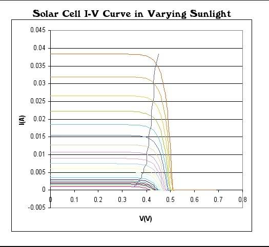

Of course, for low cost solar panel power systems used in many consumer products, the output power may only be optimized at a single specified irradiance. :smile:
Likes jrmichler and anorlunda
@alan123hk nailed it. A maximum power point tracking controller (MPPT) will adapt the load to the panel's capabilities.
If you did it as an Arduino project, your project would become a DIY MPPT controller. You should be able to find descriptions of MPPT online. If you buy a MPPT controller, prices start below $100.

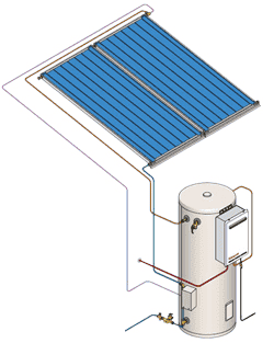

By the way, direct solar hot water heating is even more attractive and efficient than solar PV plus an electric water heater. If possible, consider putting up some solar hot water panels and some solar PV electric panels.
Interesting.
I imagine I would need to have a multitude of burners installed so that I can vary the resistance of the load to match the panel output.

As you said, hot water is a wonderful way to store energy. You should consider solar hot water panels. It is less expensive and more efficient to heat the water directly rather than with electricity. You can have separate PV electric panels for lighting purposes.
Likes sophiecentaur and davenn
I have considered the water heating panels as well. For this project I want to focus on using only PV panels. The coop is not expected to be kept as warm as say a house, and I think it is likely that the liquid in the system will freeze(i'm in Canada). Antifreeze could be used, but I'd prefer to just stick with PV panels. The goal is to learn about PV systems as much as it is to help heat the coop.

That is similar to other MPPT controllers. The goal is to operate the PV panel close to the "knee" of the curves shown by @alan123hk in post #2. Most controllers do that by dynamically adjusting the voltage on the load side of the controller (voltage on the panel side of the controller is different.) But you can do it by switching in more or fewer heater coils (you call them burners). It doesn't have to be perfect. If you can measure power to the heaters, then all you need to know is how many header coils draws the most power. Too many or too few means less power.
Your Arduino code can do that by trail and error. For example, say you have 4 burner coils. Then once every 15 minutes do the following. Turn on only 1 coil, measure power P1. Turn on 2 coils, measure power P2. Turn on 3 coils, measure power P3. Turn on 4 coils, measure power P4. Which power P is the largest 1, 2, 3 or 4? Leave that many coils on for the next 15 minute period. The period could be adjusted for longer or shorter periods. That will do a decent job of MPPT as the time of day changes. It will not be fast enough to catch the opportunity to adjust as a cloud passes overhead.
