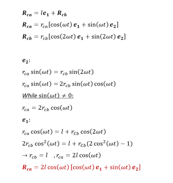

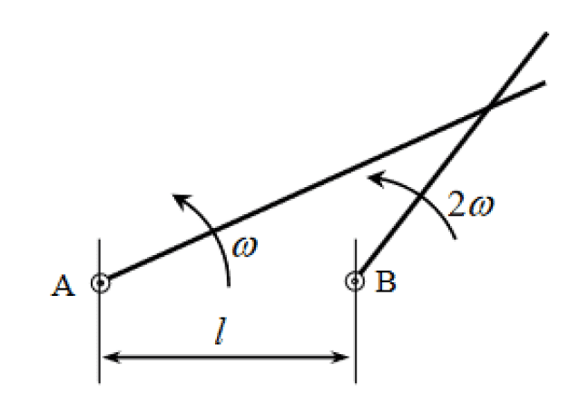

Two long rods rotate with the speed of omega and 2*omega around the parallel axes that pass through the points A and B respectively (and orthogonal to the plane of the drawing). At the moment in time t=0, both rods are turned to the right. What is the trajectory of the intersection point of the rods as a function of time?
I was able to find a mathematical expression for the trajectory of the intersection point in time except for the times when the two rods are horizontal, I understand that in this case there are infinite intersection points but I cannot see it mathematically.
R_ca = L + R _cb

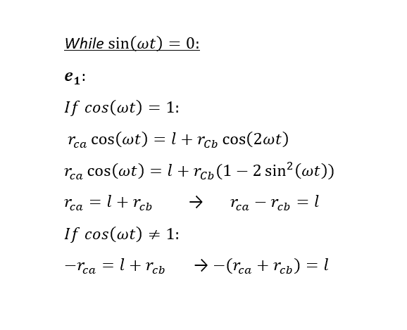

Check if there are other times when the rods are parallel? If the time is allowed to continue long enough, they could be parallel at any angle. My mistake.

Thanks for the comment. So where do you think my mistake is? Did I miss something during the solution?
I don't see anything wrong with your solution.
What do you get for the final expression for ##\vec{R}_{cb}##? Interpret.
How did you get the left hand side of step 2 in the e1 calculations?
You change it from rca to rcb and use the double angle formula.
I circled what I'm talking about.
It is a substitution using the last equation under the preceding "e2:" analysis.

For what values of ##\omega t## are the rods parallel/antiparallel?
@eitan77, not an answer to your question but possibly worth noting…
The trajectory of the intersection point (C) is not continuous over time. There are time-intervals when there is no intersection, e.g. consider the positions of the rods when when ##\omega t = 135^o## so ##2\omega t = 270^o##.
When intersection occurs, using simple geometry you can show triangle ABC is isosceles (AB=BC). This provides a simple way to find C's trajectory.

Now that you mention that I noticed that my answer restricts C to having only positive e1 components
So? Seems ok to me.
Does this equation restrict the allowed values of ##t##?
No mistake. Try answering the questions in posts #4, #7.
I didn't notice it until now, since r_cb represents length it cannot be negative so this limits it to values of t to be 0<t<pi/2.
0<omega*t<pi/2
ok, that's the right idea. Your inequality should include ##\omega## in it. Also, there will be other allowed ranges.

So it is correct to say that there is an intersection point that holds :
when ##2\pi k <\omega t <= \pi /2 +2\pi k## for k = 0,1,2... ?

That's for parallel in the strict sense, but allowing antiparallel it is ##\omega t=n\pi##.
In your algebra you wrote "While ##\sin(\omega t)\neq 0##", thereby sidelining these cases.

I see it like this. A full cycle of the system occurs when rod A performs 1 full rotation and rod B performs 2 full rotations – we’re then back to the originaL start position.
Take point A as the origin so AB lies on the x-axis.
##\theta_A## is rod A’s direction (##\theta_A = \omega t##) and similarly for rod B, ##\theta_B = 2\omega t = 2\theta_A##.
There rods don' intersect for ##\pi/2 <\theta_A<3\pi/2##.
But, for example, consider ##\theta_A =7\pi/4##. Rod A bisects the 4th quadrant. Rod B points at ##7\pi/2## which is the -y direction. The intersection (point C) is (##l, -l##) so that ABC is a right-angled isosceles triangle.
Is there a mistake in my logic?

No, you are right. It wasn’t as obvious as I thought you were implying, but I didn't follow it through far enough.
