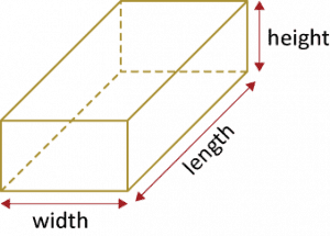

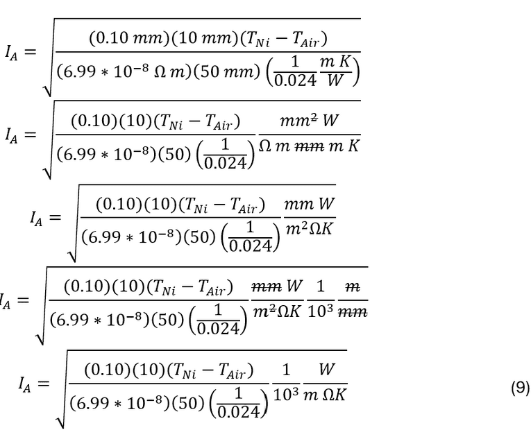

Calculate the ampacity of a nickel strip with thickness of 0.10 mm, width of 10 mm, and length 50 mm, assuming a DC current.
See below. There are many.
I'm not sure what forum to put this in. Sorry if I have placed this in the wrong forum. This topic seems to require understanding of both electrical and mechanical, so I'm placing this in the physics forum. Knowledge of this subject doesn't appear to be too common, so I'm not posting it in the introductory forum.
This is a theoretical thought exercise ONLY to help in understanding the ideas and concepts. The numbers in the question statement are MADE UP, simple numbers to do math with.
I'm hoping to understand how ampacity of a conductor is calculated and I have some questions. There are ampacity tables you can look up online, but what do you do when you are using a conductor that is not in these tables, and where do these numbers even come from? Are these numbers really just experimental data determined from testing, or can they be obtained with math? I'm attempting to understand where these numbers come from by attempting to calculate such a value in this theoretical thought exercise.
Ampacity is the current a conductor can handle before it is considered "overheated".

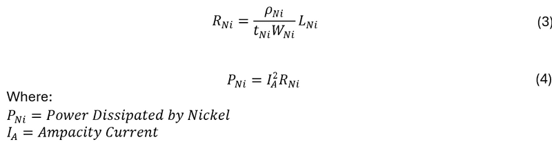

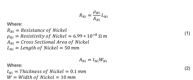

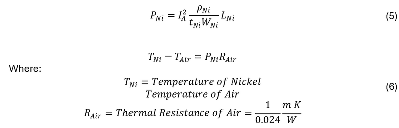

Question Statement: Calculate the ampacity of a nickel strip with thickness of 0.10 mm, width of 10 mm, and length 50 mm, assuming a DC current application.

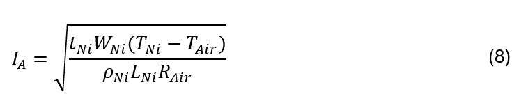

Insert Equation 2 into Equation 1to get Equation 3.
Insert Equation 3 into Equation 4 to get Equation 5.
Insert Equation 5 into Equation 6 to get Equation 7.
Rearrange Equation 7 for ampacity current to get Equation 8.
Inserting the values of constants, results in Equation 9.

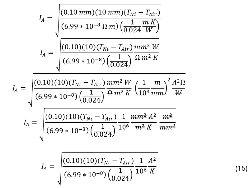

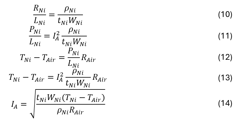

Looking online, ampacity does not care about the length of material. This would explain why the units do not work out. I now have based on the previous equations, Equation 10-14 taking this into consideration.
Inserting the values for the constants results in Equation 15.
Assuming that I have done everything above correctly, I have the following questions still:
  1. The ampacity does not care about length of the conductor, but why? I'm really not understanding this. I would assume the longer the conductor, the more current it can handle without overheating.
  2. What temperature should I use for the acceptable temperature in Kelvin for Nickel before it is considered "overheated"?
  3. What temperature should I use for ambient air in Kelvin?
Thank you for any help in understanding this!

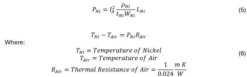

As you note, your equation 6 is dimensionally inconsistent. Certainly I would include the surface area in the denominator on the right, but that still leaves you needing a length factor in the numerator.
To use that equation, the external temperature (your ##T_{air}##) should be some guaranteed constant lower temperature and the length factor would be the distance to it through a solid medium. Using the value you have for the thermal resistance of air requires there is no convection, which is surely quite wrong.
You need to use something like Newton’s equation for convective cooling. This uses a heat transfer coefficient (at the interface between the nickel and the air) instead.
https://en.wikipedia.org/wiki/Convection_(heat_transfer)#Newton's_law_of_cooling
However, it is ideally for the forced convection case, i.e. a fan. In unforced convection the strength of the air current depends on the temperature difference, leading to a nonlinear relationship.

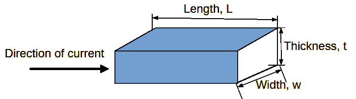

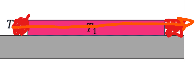

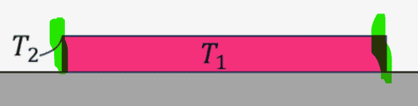

The rate of heat loss is proportional to the surface area (say 'S') (not to be confused with the cross-sectional area, A). And S (ignoring the ends) is proportional to L.
Ask yourself what doubling the length (but keeping the current constant) would do to:
- the rate of heat production;
- the rate of heat loss.
You will see the the two effects cancel! So conductor length doesn’t matter. This comes out of the maths of course, but a qualitative insight is useful..

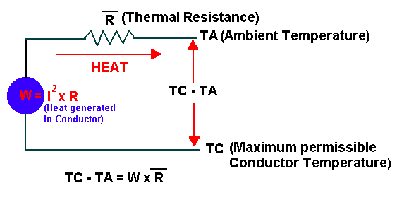

I was trying to use the electrical circuit model for heat dissipation, and as others have pointed out, made a few errors. I really appreciate it.
It appears that my Equation #7 in Post #1 is incorrect.
$$T_C-T_A = P_{Ni} R_{Air}$$
Where:
##T_C## is the temperature of the conductor in ##K##
##T_A## is the temperature of ambient air in ##K##
##P_{Ni}## is the power dissipated by the nickel strip in ##W##
##R_{Air}## is the thermal resistance of air in ##\frac{K}{W}##
It looks like my mistake is that for ##R_{Air}## I had the wrong unit of measurement. I had assumed it was in ##\frac{m K}{W}##.
Doing a UoM check on the Ohm's law equation this is clear:
$$K \neq \cancel{W} \frac{m\;K}{\cancel{W}}$$
$$K \neq m\;K$$

As pointed by @haruspex . It seems that I actually need to calculate ##R_{Air}##, which I do below, such that it has UoM of ##\frac{K}{W}##.
$$R_{Air} = \frac{1}{A_{Ni}h_{Ni-to-Air}}$$
$$R_{Air} = \frac{1}{t_{Ni}W_{Ni} h_{Ni-to-Air}}$$
Where:
##A_{Ni}## is the cross sectional area of nickel in ##m^{2}##.
##t_{Ni}## is the thickness of the nickel ## 0.1\;mm##.
##W_{Ni}## is the width of the nickel ##10\;mm##.
##h_{Ni-to-Air}## is heat transfer coefficient from nickel to ambient air under natural convection in ##\frac{W}{m^{2}\;K}##
Checking the UoMs below, it seems to check out.
$$\frac{K}{W} = \frac{ \cancel{m^{2}}\;K}{\cancel{m^{2}}\;W}$$
$$\frac{K}{W} = \frac{K}{W}$$
As pointed out by @haruspex It looks like I need to update my question statement to specify natural convection. In this exercise I'm assuming natural convection, no fans blowing air or other forms of cooling.
Question Statement: Calculate the ampacity of a nickel strip with thickness of 0.10 mm, width of 10 mm, and length 50 mm, assuming a DC current application, and natural convection.
Substituting in my new equation for ##R_{Air}## into the Ohm's law equation for the electrical circuit model
$$T_C-T_A = P_{Ni} \frac{1}{t_{Ni}W_{Ni} h_{Ni-to-Air}}$$
Now I need to calculate the power dissipated by the nickel strip.
$$P_{Ni} = I_{A}^{2} R_{Ni}$$
Where:
##I_{A}^{2}## is the ampacity current in ##A##.
##R_{Ni}## is the resistance of nickel in ##\Omega##,
As mentioned by @haruspex, with this discovery of this error, I will most certainly need to take into consideration the length of the nickel strip, when finding the resistance of the nickel strip.
$$R_{Ni} = \frac{\rho_{Ni} L_{Ni} }{A_{Ni}}$$
$$R_{Ni} = \frac{\rho_{Ni} L_{Ni} }{t_{Ni} W_{Ni}}$$
Where:
##\rho_{Ni}## is the resistivity of nickel ##6.99*10^{-8}\;\Omega\;m##.
##L_{Ni}## is the length of the nickel strip ##50\;mm##.
Plugging in the equation for ##R_{Ni}## into the equation for ##P_{Ni}## I get:
$$P_{Ni} = I_{A}^{2} \frac{\rho_{Ni} L_{Ni} }{t_{Ni} W_{Ni}}$$

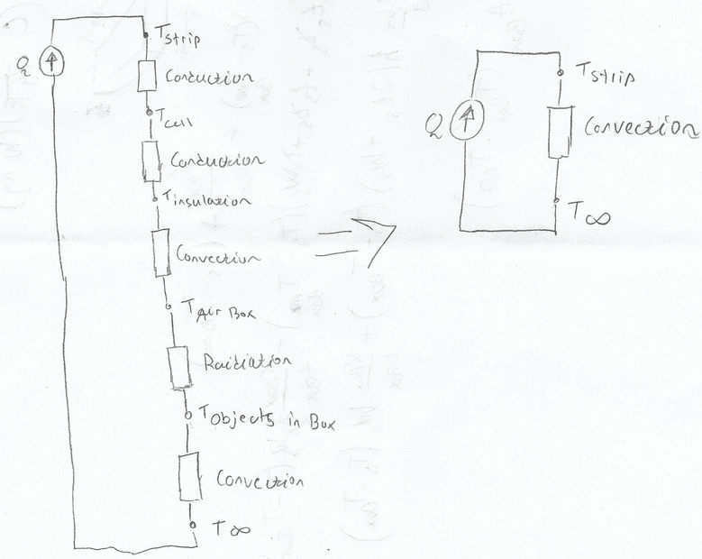

@Steve4Physics - I do need some guidance in determining what values to use here. I'm not sure what values to use to be honest.
  • This is for ambient air conditions, say outside, in an enclosed hard plastic box. We assume worse case scenario that it is over 110 deg F outside as the hottest temperature, and worse case scenario 32 deg F as the coldest? I'm honestly not sure what to use here. Or if I should go with the average temperature? When NEC specifies ampacity for conductors in tables, they don't specify the ambient air temperature, so I'm not sure if they just pick an "average" temperature that represents the average use case? Maybe somewhere in the middle of the two extremes?
  • The nickel is not to come into contact with a human hand. Any recommendations? I'm not sure what temperatures the national electric code uses for when determining ampacity of copper wires? This is nickel instead of copper, so I don't know if I should use a different temperature, even if the temperature that NEC uses was specified.
  • Sorry for all the subscripts. I'll remove them in follow up posts, hopefully I'm on the right track here and my equation is correct? At which point I should be good to remove the subscripts going forward. Nickel is purchased with a specified length, width and thickness, as opposed to cross sectional area. I see how it can be one or the other though in terms of specifying it. It's just why I broke it up like that.
  • Thermal resistance does not care about the length of the conductor, as you mention. Makes sense. But does the length of the conductor effect how much power is created, looking at my equation it seems to be related.
Updated Question Statement: Calculate the ampacity of a nickel strip with thickness of 0.10 mm, width of 10 mm, and length 50 mm, assuming a DC current application, and natural convection. The nickel strip resides an in enclosed plastic box outdoors.
Without the subscripts
$$I_{A} = \frac{t\;W}{\sqrt{L}} \frac{1}{\sqrt{\rho}} \sqrt{(T_C-T_A)h_{Ni-to-Air}}$$

Purpose - This question is being asked for my pure knowledge, and trying to learn something that I don't already know. NEC Chapter 310 (which you can Google) states ampacity of aluminum and copper conductors. It's been used for a long time it seems, and is the gold standard. But what do you use when you want to use a conductor that is not in NEC Chapter 310? Where do the values in NEC Chapter 310 even come from? I think there are applications, where you would use Nickel as a conductor, such as battery pack building. Or you could use gold as a conductor for computers, or space applications for satellites and so forth, so you don't want to worry about oxidation. But how do you find the ampacity of such conductors? I'm not sure what class this type of question would fall under, but it seems to require understanding of both electrical and mechanical fields.
Calculating thermal resistance justification - I looked into this some more, and seems that maybe what I did was indeed correct. The convection heat transfer equation:
$$\dot Q = h\;A\;(T - T_{f})$$
Where:
##\dot Q## is the heat transferred by the object in ##W##.
##h## is the heat transfer coefficient in ##\frac{W}{m^{2}\;K}## .
##A## is the cross sectional area of the object emitting the heat in ##m^{2}##.
##T## is the temperature of the object in ##K##.
##T_{f}## is the temperature of the fluid in ##K##.
To get the electrical circuit model.
Let
##\dot Q## be the the power generated by the object ##P##, and act as the current within the circuit ##I##.
##T - T_{f}## be the electrical potential difference ##V## across the resistor.
$$I = h\;A\;V$$
$$V = I\;\frac{1}{h\;A}$$
Let:
##\frac{1}{h\;A}## represent the resistor within the circuit ##R##.
$$V = I\;R$$
Now I have an ohms law, and an electrical circuit equivalent of the heat transferred by convection
Then following along with Post #4 in the middle I substitute the calculation for the power generated by the conductor, and then solve for the current in the conductor resulting in this equation.
$$I_{A} = \frac{t\;W}{\sqrt{L\;\rho}}\;\sqrt{(T_{C}-T_{A})\;h_{Ni-to-Air}}$$

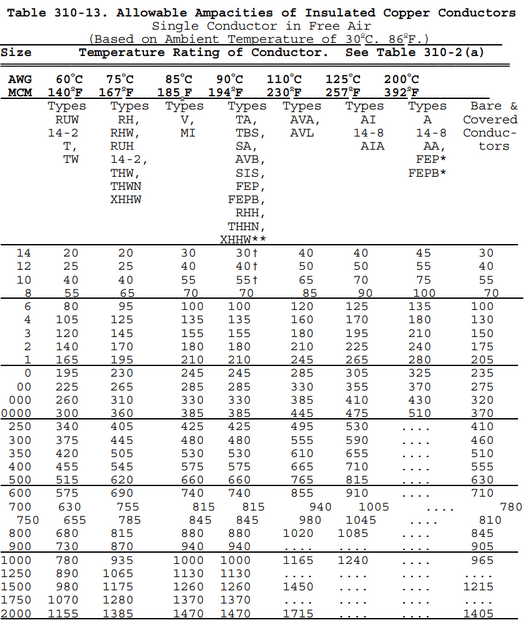

Step 2 Progress:
Observation 1: Looking through NEC Chapter 310, I stand fully corrected. Ampacities are indeed specified at ##30\;C\;(86\;F)##. There are correction factors if ambient is different. For the case of this exercise, it may be best to use ##30\;C\;(303.15\;K)## as a starting point for ##T_{A}##
Observation 2:
The ampacity for bare conductors is greater than a conductor with ##75 C## and less than or equal to a conductor with ##85 C##. Interesting!
Theory 1: ##T_{C}## is the temperature at which the insulation on the conductor begins to melt? This would make sense to me, that you would want to keep the conductor beneath the melting point of the insulation. Otherwise, it could result in an electrical short. I'm not sure what should be used for a bare conductor. Some ideas:
  • Nickel is often used used a conductor in battery packs. I'll take a value for the maximum operating temperature for a battery from a datasheet. I will go with Samsung 50S. Certainly we do not want to nickel strip to heat up to a temperature higher than the operating temperature of cells. The datasheet for this randomly chosen cell is ##60\;C\;(333.15\;K##.
  • The melting point of Nickel is #1,455\;C##.
  • The lowest temperature rating in ampacity tables that can be found within NEC Chapter 310 is for ##60\;C## insulation.
Based on this, I think ##60\;C## might be a good starting point for a nickel conductor within the equation for ##T_C##. Obviously would add in a safety factor, but for simplicity purpose of this thought exercise, we will just use ##60\;C## for the time being.
Observation 3: NEC Chapter 310 does not specify the length of the conductor. This is puzzling to me, as it seems related per the equation I found.

Inserting values from observations made above:
$$I_{A} = \frac{(0.1\;mm)(10\;mm)}{\sqrt{(50\;mm)(6.99*10^{-8}\;\Omega\;m)}}\;\sqrt{(333.15\;\cancel{K} -303.15\;\cancel{K})\;5\;\frac{W}{m^2\;\cancel{K}}}$$
$$I_{A} = \frac{1\;mm^{2}}{\sqrt{(50\;mm)(6.99*10^{-8}\;\Omega\;\cancel{m})(10^{3}\;\frac{mm}{\cancel{m}})}}\sqrt{150\;\frac{\cancel{W}}{m^2}\;\frac{A^{2}\;\Omega}{\cancel{W}}}$$
$$I_{A} = \frac{1}{\sqrt{349.5*10^{-5}}}\;\frac{\cancel{mm}^{\cancel{2}}}{\cancel{mm}\;\cancel{\sqrt{\Omega}}}\;\sqrt{25*6}\;\frac{A\;\cancel{\sqrt{\Omega}}}{\cancel{m}}\;\frac{1}{10^{3}}\;\frac{\cancel{m}}{\cancel{mm}}$$
$$I_{A} = \frac{5}{10^{3}}\;\frac{\sqrt{6}}{\sqrt{349.5}}\frac{1}{10^{-5/2}} A$$
$$I_{A} = 5\;\sqrt{\frac{6}{3495}} A$$
$$I_{A} = 5\;\sqrt{2/1165} A$$
$$I_{A}\;is\;about\;0.207 A$$
Conclusion - Something is clearly wrong here! I believe my equation to be correct, but I also believe the values that I selected for those variables ##T_{C},\;T_{A},\;h_{Ni-to-Air}## to be reasonable? But I'm not entirely sure? I think the value for ##h## might need to be closer to 25? I'm not sure how the value for ##h## is calculated. So I have no idea what I've done wrong. If anyone has any suggestions, please let me know!

@BuddyBoy, a few thoughts...
1. There is no single formula for ampacity for most practical situations. Ampacity is found empirically (by experiment) because of the complexity.
2. There are no ‘right temperatures’. When you work out a value for ampacity you are finding the maximum current for a particular situation. It is up to you to specify what temperatures are appropriate for that situation.
3. Maybe step back and try a more manageable problem. E.g. try this...
A uniform conducting strip has thickness ##t##, width ##w## and length ##L##. It is heated by a constant current along its length, is uninsulated and is surrounded by air. The operating conditions require that the strip’s surface temperature never exceeds ##T_S##. The surrounding air temperature is ##T_a##.
You may assume:
- cooling occurs entirely by forced convection with heat transfer coefficient ##h## (so conductive and radiative losses are negligible);
- the strip has reached a steady-state with surface temperature ##T_S##; in this situation the current (##I##) is the value of ampacity.
Q1. Find an expression for the rate of heat-loss in terms in terms of some of the given parameters.
Q2. Find an expression for the rate of Ohmic heat production in terms of some of the given parameters.
Q3. Using your answers to Q1 and Q2, find an expression for the ampacity, ##I##.

The heat is lost by the surface area of the strip, the resistance is inversely proportional to cross.-sectional area. There is a difference. It’s not ##tw## on both sides. Also…those ##tw## factors wouldn’t divide out regardless. They would multiply…check your mathematical logic there.
Likes BuddyBoy, Steve4Physics and SammyS

What is the surface area of the parallel-piped?
If current is flowing in this direction, parallel with the "Length" vector
Than the surface area would be with the width times the length. Which is what I did.
We are talking about the top surface right? Meaning if I placed a rectangular box on the table, and looked at it from a bird's eye view directly above it, it would be the "top surface" that I'm observing.
I'm misunderstanding something I take it?
The surface area is the sum of the areas of all the surfaces exposed to air.
So, to the area you computed, you would add the area of the bottom surface, and the area of the two sides.
Or, as a thought experiment, If you drop a sugar cube into a glass of water, the total area of all the surfaces that get wet. :wink:

I would consider all 6 surfaces if the strip was floating in the air.
If the strip was sitting on the table, do I still consider all 6 surfaces? I take it that the one surface that is in contact with the table would still need to be considered for the A term. It's just that one of the surfaces being in contact with something other than air, would effect the "h" term only?

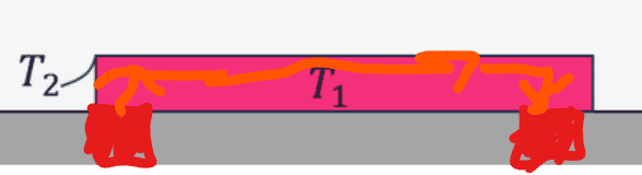

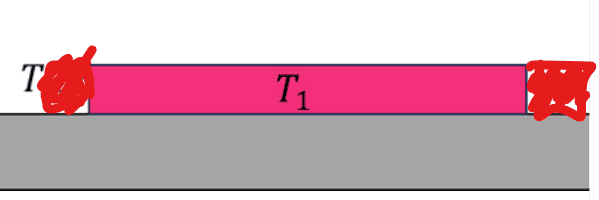

Just assume a uniform temperature distribution for now. Multidimensional heat transfer with different modes quickly becomes analytically unpalatable. You are still working on the core idea, let’s not make the problem unsolvable just yet.
BuddyBoy said:
$$\dot{Q} =h\;X_{||}\;X_{⊥1}\;(T_{C}-T_{A})$$
For clarity and readability I highly recommend using only simple, self-explanatory symbols. A diagram at the start can unamiguously define these, e.g.
And do not think about units at this stage! Derive all formula without even mentioning units! Units are something you only need to consider when using your final formula to do numerical calculations.
BuddyBoy said:
$$I_{A} =W\;\sqrt{\frac{t}{\rho}}\;\sqrt{h(T_{C}-T_{A})}$$
I believe the above equation is correct?
Not correct! Two problems I can immediately spot are:
a) By defining the unit for each symbol you have introduced major errors. For example the unit for resistivity is ohm-metres. But you have defined lengths to be in mm. The resistivity would need to be in ohm-millimetres for consistency. That alone introduces an error-factor of 1000! You should not be mentioning units - as already stated above (and as stated in previous posts)!
b) You have only considered heat-loss from a single face (as you are aware); but this is inconsistent with the original problem-statement.
BuddyBoy said:
Any recommendations on how to find ##h## or what value I should use? It seems like for Nickel to air the heat transfer coefficient is somewhere between ##5## and ##25 \frac{W}{m^2\;K}##, but I'm unsure which value to use, or how to find it, or calculate it. If it's easier, and likely more realistic, I could use natural convection, without a fan blowing air on the nickel strip.
The value shouldn't depend on the material. It should be pretty much the same for any material. That's because we are considering convection at a smooth outer surface not something happening internally. However it will be affected by the air-flow rate (e.g. what speed is used for a cooling-fan) and the direction of air flow.

Equipment safety standards would use TA≤40C. This isn't an uncommon occurrence in many parts of the world. Plus it's the ambient temperature near the wire insulation that matters, so your whole enclosure/conduit may trap heat above the outside temperature.
TC≤60C would be for the cheapest wire insulation. 90C insulation is pretty standard. Yes, it may cost more, but you can save money by reducing the wire gauge accordingly and make a bit more heat. Copper is expensive too.
When I was designing big power supplies, my standard starting point was TA≤50C and TC≤105C, but we made expensive things and would pay for good wire. Our equipment was rated for TA≤40C.
Of course none of this matters if you just want to play with the thermal modeling to learn how that works.
Thank you for the assistance. I see that ##A## is ALL surface areas of the nickel strip.
$$I_{A}^{2}\;\frac{\rho\;L}{t\;W} = h\;A\;(T_{C} - T_{A})$$
$$I_{A}^{2}\;\frac{\rho\;L}{t\;W} = (2LW + 2Lt+2tW)\;h\;(T_{C} - T_{A})$$
$$I_{A}^{2} =\frac{t\;W}{\rho\;L}2(LW + Lt + tW)\;h(T_{C} - T_{A})$$
$$I_{A} =\sqrt{\frac{t\;W}{\rho\;L}\;2(LW + Lt + tW)\;h(T_{C} - T_{A})}$$
$$I_{A} =\sqrt{(tW^{2}+t^{2}W+\frac{t^{2}W^{2}}{L})\frac{2}{\rho}\;h(T_{C} - T_{A})}$$
$$I_{A} =\sqrt{(W + t +\frac{t\;W}{L})t\;W\;\frac{2\;h}{\rho}(T_{C} - T_{A})}$$
$$I_{A} =\sqrt{(W + t +\frac{t\;W}{L})t\;W}\;\sqrt{\frac{2\;h}{\rho}(T_{C} - T_{A})}$$
Does the equation above look correct?

BuddyBoy said:
.. I see that ##A## is ALL surface areas of the nickel strip.
To avoid any confusion (using ##A## for both cross-sectional area and for surface area) it would be better to use different symbols for these areas.
It's not necessarily "ALL" surface areas. Only the surfaces through which significant heat-loss occur are relevent.
In a typical setup, the small end-faces have negligible areas when considering heat-loss. They would probably not even be fully exposed to the air as they would have electrical connections and be attached to supports. So the areas of the end-faces would usually not be included in ##A##. (In this case you find that ##L## cancels and you end up with simpler equations.)

So it seems very difficult to determine a value of h. I did some preliminary looking into it, and it appears to be dependent on the geometry of the item, and even it's orientation. The calculation seems a bit involved. It does not appear to be dependent on the material? So in theory a copper strip will have the same h value as a nickel strip, given the same dimensions and application?
It would be nice if I could just use the NEC document, as it's the "gold standard", and use ratios to calculate ampacity values of nickel strips, but this doesn't even seem possible because h is dependent on the geometry of the conductor. So you would have a long, over a 3D rectangular prism.
Is there a "gold standard" for copper busbar? If there was, I could extrapolate tables, up and down various widths and length, if my formula that I found was correct, using ratios.

Thanks. So I found the formula for how to calculate the value of h for a vertical and horizontal plate.
I'm getting that a 10 mm wide and 0.1 mm thick nickel strip can accept 6.57 A horizontally and 6.98 A vertically, with a surface temperature of 60 deg C for the nickel and 30 deg C ambient air.

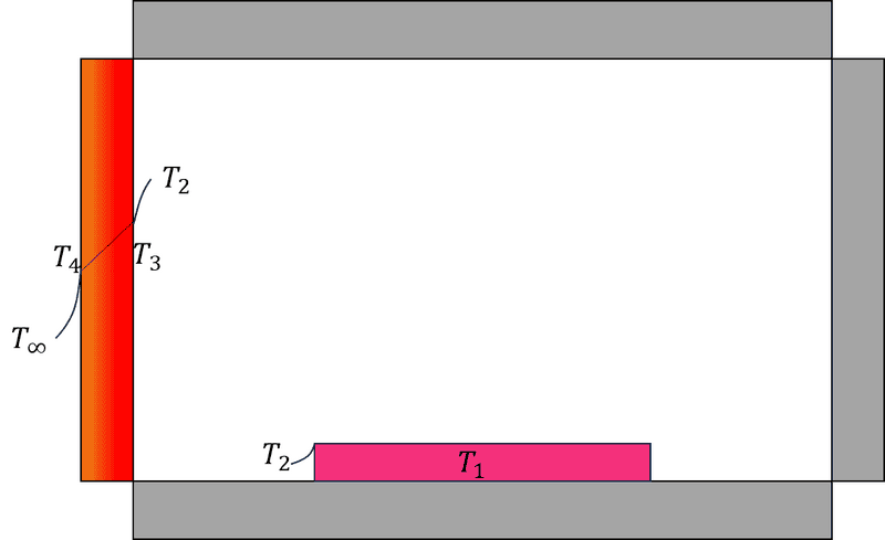

Now another question I have, representing a use case, of the nickel strip in a battery box without fans. Does natural convection still apply? Most battery boxes has holes for connectors, exposing the inside of the battery box to ambient air temperature. So it's not a completely enclosed space, but a very large percentage of it is.
  • #38
Yeah, but it becomes a system of transfers if the box is small. Heat is transferred from the conductor to the air contained in the enclosure, which is then conducted through the enclosure to the air surrounding the enclosure. This has the effect of raising the temperature of the conductor w.r.t to a conductor in a large “open” environment. Dimensions/thermal conductivity(new variables are obviously fine) for the material of the enclosure are needed to go anywhere with an analysis.
It’s a fairly straight forward extension of the problem when the systems are at steady state conditions because the power ##I^2 R## must be transferred across each boundary before it exits to the surroundings.

So the whole idea of finding the heat transfer of something like a battery box has got me thinking about finding the h values for a nickel strip.
In this equation
$$\dot{Q} = hA(T_{S}-T_{A})$$
h is a different value for each surface
A is a different value for each surface
This results in a dot product between the h values, and their respective areas.
Looking online the h value for a flat horizontal or vertical plate can be calculated via this formulas:
I played around with these formulas. Assuming that the nickel strip was not "floating" and one of the L*W surface areas was on some other flat surface (i.e., "the bottom"). Result in five different surfaces exposed to the ambient air.
Should I find the h value for each of the five exposed surfaces and consider them in calculating the current as a series of horizontal and vertical planes? Or do the formulas in the snap shot above already take this into consideration? Meaning what is the definition of a "plate"? I tried to find the derivation of these formulas, to see if it would aid in my understanding of how "plate" is defined, but didn't have any luck. At some thickness is my "plate" no longer considered a plate because it's to thick? I understand that I may be able to make the engineering estimation that the thickness may be considered insignificant, but I get different values for the current in the five surface analysis if I consider all five surfaces, vs only the one LW surface that is exposed to ambient air conditions.
Regardless, making the estimation that the thickness is insignificant and should not be considered, may not be an "option" but "required" to use the formulas to find h values for a flat plate? Meaning these formulas are inaccurate if you don't make this assumption? In order to use the formulas, you only consider the one LW surface.
Certainly for a battery box, the thickness should not be disregarded as insignificant, but for a nickel stirp they should be?

  • #40
Yes, they can be different. I guess the box must be different in ##A##, but its not a real issue- another variable.
That formula will only apply for the convection boundaries, across the box is a conduction boundary. just pretend heat is conducted across the walls and not up them in this portion. You will use what you know about ## \frac{dT}{dx}## for the plane wall.
It's tied to the fluid mechanics, if the fluid mechanics of the flow around the plate become complex because of the geometry of the object in a flow, the heat transfer by convection does too. They are linked through the velocity boundary layer.
My opinion: Get an overview solution of the total heat transfer problem first. Drop all this finding ##h## stuff at least temporarily. Once you get the overall picture, you can focus on the fine details if it interests you - I'm not saying you'll find an answer, but you are free to torture yourself with it.
Probably would have some issues - this is for the reason mentioned above , complex flow around the object, complex heat transfer.
Great, you need the thermal conductivity of the material the enclosure is made of and its thickness.
BuddyBoy said:
The other conceptional question I have, is "stacking" strips is common practice to reduce the overall resistance to allow for more current flow. If I have a 0.1 mm x 10 mm x 50 mm strip, and I calculate the ampacity current to be X amps given temperature desires, would "stacking" two identical strips of these dimensions on top of each necessarily give me 2*X amps at the same temperature desires?
I don't know for sure. For starters, you get half the resistance. Did you double the surface area exposed to the fluid?
You are trying to solve too many problems at once. Focus on the task at hand. Find the temperature of the conductor in the box given constant averaged ##\bar{h}##, thermal conductivity of enclosure material ##k##, the box thickness ##\ell## and the surface area of the box ##A_{box}##.
At steady state there is no thermal energy accumulating in the system, hence the power ##I^2R## passes through each boundary without any of it being captured (if you will) by the stuff in between boundaries. Three of those are convection boundaries, and one of them a conduction boundary. Do you know how to find the steady state temperature of your conductor as a function of ##I##?

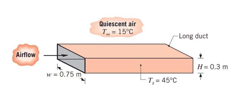

:oldsurprised: This is very perplexing to me! I'm looking through a textbook of a heating duct, and they also don't include the sides. Meaning in this picture, the two surface areas that would be calculated via ##w*H**## are ignored.
In the example solution they ignore those surface areas. In this example they find each h value for the surface areas involved. In the example above, it makes sense because the duct is open at two ends, and there is nothing physically there. But in my nickel strip example, I have physical metal on these sides. But in the nickel strip example, the current flows through the strip and is not trapped within the material. So the surface areas parallel to current flow are not considered.
Convection boundaries in my nickel strip example = 2Lt and LW
Conduction boundary is = LW
erobz said:
Do you know how to find the steady state temperature of your conductor as a function of I?
Given what you pointed out about there only being three surfaces which convection is to be considered, I can find the steady state temperature difference of the surface and the ambient air. I also need to consider the conduction boundary. Assuming that ##h## is the same for each surface.
Assuming that the strip rests along the "bottom" of a rectangular box, which sits on a table
Convection ##\dot{Q} = h A (T_{S} - T_{\infty})##
Conduction ##\dot{Q} = \frac{k}{t}A(T_{S} - T_{2})##
##S## is Strip
##T## is Table
##B## is Box
$$\dot{Q_{S}} = \bar{h} A_{S} (T_{S} - T_{B}) + \frac{k_{B}}{t_{B}}A_{BS}(T_{S} - T_{B})$$
$$\dot{Q_{S}} = I_{A}^{2} R$$
$$R = \frac{\rho\;L}{W\;t}$$
$$\dot{Q} = I_{A}^{2} \frac{\rho\;L_{S}}{W_{S}\;t_{S}}$$
$$A_{S} = 2L_{S}t_{S} + W_{S}L_{S} = L_{S}(2t_{S} + W_{S})$$
$$A_{BS} = L_{S}W_{S}$$
$$I_{A}^{2} \frac{\rho\;L_{S}}{W_{S}\;t_{S}} = \bar{h}*L_{S}(2t_{S} + W_{S})(T_{S} - T_{B})+ \frac{k_{B}}{t_{B}}L_{S}W_{S}(T_{S} - T_{B})$$
$$I_{A}^{2} \frac{\rho}{W_{S}\;t_{S}} = \bar{h}(2t_{S} + W_{S})(T_{S} - T_{B})+ \frac{k_{B}}{t_{B}}W_{S}(T_{S} - T_{B})$$
$$I_{A}^{2} \frac{\rho}{W_{S}\;t_{S}} - \frac{k_{B}}{t_{B}}W_{S}(T_{S} - T_{B}) = \bar{h}(2t_{S} + W_{S})(T_{S} - T_{B})$$
$$(T_{S} - T_{B}) = \frac{1}{\bar{h}(2t_{S} + W_{S})}\;(I_{A}^{2} \frac{\rho}{W_{S}\;t_{S}} - \frac{k_{B}}{t_{B}}W_{S}(T_{S} - T_{B}))$$
My new equation for the ampacity of the conductor becomes:
$$I_{A}^{2} = \frac{W_{S}t_{S}}{\rho}(\bar{h}2t_{S} + W_{S})(T_{S} - T_{B})+ \frac{k_{B}}{t_{B}}W_{S}(T_{S} - T_{B}))$$
$$I_{A} = \sqrt{\frac{W_{S}t_{S}}{\rho}}\sqrt{(\bar{h}2t_{S} + W_{S})(T_{S} - T_{B})+ \frac{k_{B}}{t_{B}}W_{S}(T_{S} - T_{B}))}$$
Which is independent of ##L## if ##h## is provided numerically to you and you assume each surface area of the conductor has the same ##h## value.
Do these equations look correct?
Thank you for all the help!
Once I narrow down the equation, I can consider the heat transfer of the box to ambient air.
For conduction, is the A term the area at which the nickel strip comes into contact with the box, or the whole surface area of the plane that comes into contact with the nickel strip? I guess I had just assumed it was the surface area of the stirp L*W that came into contact with the "bottom" of the box? But I'm not sure if it should be the surface area of the bottom of the box L_B * W_B?
I'm thinking that I don't know the temperature of the box. But can I come up with the heat transfer equation of the box, and assume that the number of watts transferred by the strip within the box, is also the same number of watts transferred by the box to the ambient air? I can then come up with a equation for the temperature within the box, maybe?
  • #42
You have to make some decisions about how you are handling things in this scenario. How big is this box surrounding the conductor in comparison to the conductor?
  • #43
That's a great picture!
Thanks, I believe that there is to many unknown variables here?
I know the dimensions of the strip.
I know the ambient air temperature.
I can come up with a formula for the temperature of the strip.
Oh wait a second, the temperature of the air within the box is the same temperature of the strip ##T_{2}##? I was assuming that they would be different. But if they are the same. Than this might open some DOORS to calculating Convection of the battery box. I just want to be sure here that they are the same. Would defiantly make things easier.
I was also wondering I know you had mentioned that the surface areas perpendicular to the flow of air should not be considered for convection calculations. Is there anyway you could elaborate as to why this is the case? This is very perplexing to me.
I understand in the example above of a long air duct, that the surface areas perpendicular to the flow of the air (i.e. both wxH or 0.75 mm x 0.3 mm surface areas) should not be considered in convection calculations, because the duct is open on both ends, so there's physically no material there, and is likely connected to some other duct.
However in the case of my nickel strip I have physical material there, the green highlighted portion below. For example it's not a hollow rectangular box.
Nickel strips are commonly used in battery connections. Current still flows along the length of the strip, but it's more of like this
Case 1:
Where the red boxes are batteries or "the rest of the circuit". I'm not trying to perform this calculation or anything at this point with regards to "the rest of the circuit". Just trying to assess if the the two green surfaces should still not be considered in convection calculations if "the rest of the circuit" is connected in this way, as opposed to directly in contact with the two green surfaces (width times thickness) like below
Case 2:
Meaning that in both pictures with red boxes, where the red boxes represent "the rest of the circuit" and some other electrically conductive pieces, I do not consider the two green surfaces (length times thickness) in both situations? I can see in Case 2 I literally have some other item in full contact with the green surfaces, so therefore no convection occurs on these surfaces. But I'm unsure about Case 1.
I really do appreciate the help on this topic!

  • #44
Thanks!
No, They are different. ##T_1## is the ss temp of the strip. We neglect thermal gradients in this body because its a relatively thin metallic substance with a high thermal conductivity. We assume that everywhere in the strip is uniformly ##T_1##. There must be a temperature differential for heat to be transferred. Hence the surrounding air ( just outside of the convection boundary layer between it and the conductor ) in the box is ##T_2##.
Its more accounting.
Case 1: View attachment 356630
Case 2: View attachment 356632
It's about the boundary area. Imagine it is a thin film, heat is transferred across it, and in the direction of flow. We ignore this last part, that's why ##h## changes along the length. We are hand waiving that away. As for the open duct, the flow entering/exiting does not have a convection boundary with itself...it requires relative motion.
As for the green area, whatever you want to do with it. In the case of a solid conductor the flow which carries heat away would hit it...relative motion. BUT its a pretty tiny area, its most likely not worth the trouble of factoring it in unless you want to keep options open for geometry changes.

$$P = I_{A}^{2}\;R$$
Where:
##P## is the power created by sending current through the strip.
##I_{A}^{2}## is the ampacity current.
##R## is the resistance of the strip.
$$R = \frac{\rho\;L}{A} = \frac{\rho\;L}{Wt_{S}}$$
Where:
##\rho## is the resistivity of the material, for nickel it's ##6.99 * 10^{-8} \Omega\;m##
##L## is the length of the strip, parallel to the flow of current
##A## is the surface area perpendicular to the flow of current
##W## W is the width of the strip, perpendicular to the flow of current
##t_{S}## is the thickness of the strip, perpendicular to the flow of current
$$P = I_{A}^{2}\;R = I_{A}^{2}\;\frac{\rho\;L}{Wt_{S}}$$
$$I_{A}^{2}\;\frac{\rho\;L}{Wt_{S}} = Q_{1} + Q_{2} + Q_{3}...$$
$$I_{A}^{2} = \frac{Wt_{S}}{\rho\;L}(Q_{1} + Q_{2} + Q_{3}...)$$
$$I_{A} = \sqrt{\frac{Wt_{S}}{\rho\;L}(Q_{1} + Q_{2} + Q_{3}...)}$$

There are many heat transfers that take place, and many temperatures that are unknown and cannot be calculated based on the six known variables ##L\;W\;t\;T_{\infty}\;T_{S}\;\rho##
$$\sqrt{\frac{Wt}{\rho\;L}(Q_{1} + Q_{2} + Q_{3}...)} > \sqrt{\frac{Wt}{\rho\;L}Q_{1}}$$
Hence if we consider only convection of the strip in ambient temperature conditions T_{\infty}, it will produce a current value smaller than the actual value if we were to consider:
  1. Heat transfer via conduction from the temperature difference between the cells and the strip
  2. Heat transfer via conduction from the strip to the insulation from the temperature difference between the strip and the insulation
  3. Heat transfer via radiation from the temperature difference between the insulation and other electrical components within the box
  4. Heat transfer via convection from the temperature difference between the insulation and the air within the box
  5. Heat transfer via convection from the temperature difference between the air in the box and the air outside of the box
  6. Likely others that I'm forgetting...
We will consider the temperature of the cells, the temperature of the insulation, the temperature of the air within the box, all to be the same temperature as the strip. Hence, we will consider heat transfer via convection from the strip and the ambient air conditions.

$$I_{A} = \sqrt{\frac{2(0.026)(0.01)(0.0001)}{(6.99 * 10^{-8})(0.063)}} \sqrt{333.15 - 310.928} \sqrt{(0.063+0.01)(16.1957) + (0.01)(0.784)+ (0.063)(0.784)}\;is\;about\;18.0348 A$$
So does this look correct?
The current I got of over 18 A seems a bit high to me.
My values for Nusselt Number for orientation 2 and 3 are not defined because Rayleigh number is to small. I'm wondering if my values for
##v## the kinematic viscosity of about ##1.68679*10^{-5} \frac{m^{2}}{s}## and ##\alpha## of about ##2.34249*10^{-5} \frac{m^{2}}{s}## are correct? They look ok to me.
Note the 18 A I got for the answer, is just what the numbers gave me, likely a mistake somewhere in my calculations, or assumptions I made, but I cannot find it. Theoretical exercise only to understand the calculations and concepts. I suspect it is WAY to high. I am NOT suggesting someone actually send this much current through a strip of these dimensions.
Thanks for any help!
  • #46
This is not correct. I think you are missing the forest from the trees. You must try to work with the overall process to understand what is going on. While the final transfer of power is that of convection, you can't just reduce it to that step to get the ss temp.
Thought Question( conceptual): If you have two boxes of exterior dimension ##a,b,c,##. Inside each is an identical conductor generating ##I^2 R##. One box is made of thin conductive material, like 1mm steel plate( high thermal conductivity). The other is constructed of 18 cm thick plastic( low thermal conductivity). Both at a steady state, which has the conductor of greater temperature inside it?
  • #47
Thanks for the response and help!
I would say that the thick plastic box with low thermal conductivity would contain the higher temperature strip. This would be because convection wouldn't cool off the box as well, and heat would be more retained in the lower thermal conductivity.

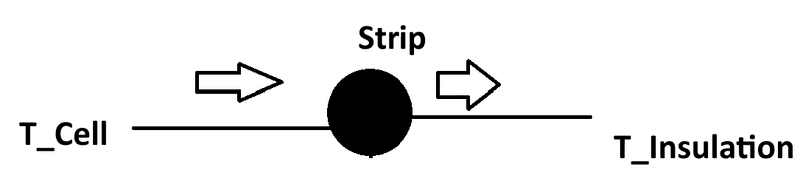

So when I find ##\dot{Q}## for the nickel stirp, do I consider all heat transfer of the nickel strip and consider this to be one equation. Then find ##\dot{Q}## from the perspective of insulation as a second equation. Then find ##\dot{Q}## from the perspective of the battery box. Do I consider all heat transfers to be positive instead of negative? I'm thinking of something like this, from an electrical circuit perspective:
The heat transferred via convection from the cell to the strip is equal to heat transferred from the strip to the insulation. The whole thing of if you assume that current entering the node is positive, then current leaving the node is negative. The two are equal to each other
$$Q_{Conduction\;Cells\;to\;Strip} = Q_{Conduction\;Strip\;to\;Insulation}$$
Equation 1:
$$Q_{Conduction\;Cells\;to\;Strip} = Q_{Conduction\;Strip\;to\;Insulation} = I^{2}R$$
##Q_{Conduction\;Cells\;to\;Strip}## will likely not be able to determine. But I suppose if my assumption is correct, ##Q_{Conduction\;Strip\;to\;Insulation}## can be calculated, therefore I would know ##Q_{Conduction\;Cells\;to\;Strip}##.
Equation 2:
$$Q_{Conduction\;Strip\;to\;Insulation} = Q_{Convection\;Insulation\;to\;Air\;in\;Box}$$
Equation 3:
$$Q_{Convection\;Air\;in\;Box\;to\;Box} = Q_{Convection\;Box\;to\;Ambient\;Air}$$
Now showing each transfer as a function of the temperatures:
$$Q_{Conduction\;Strip\;to\;Insulation}(T_{Strip}, T_{Insulation\;1})$$
$$Q_{Convection\;Insulation\;to\;Air\;in\;Box}(T_{Insulation\;2}, T_{Air\;in\;Box})$$
$$Q_{Convection\;Air\;in\;Box\;to\;Box}(T_{Air\;in\;Box}, T_{Box\;1})$$
$$Q_{Convection\;Box\;to\;Ambient\;Air}(T_{Box\;2}, T_{infty})$$
Where the first temperature is hotter than the second temperature. Meaning ##T_{Box\;1} > T_{Box\;2}##
How to solve the problem:
  1. $$Q_{Conduction\;Strip\;to\;Insulation} = I^{2}R$$. Solve the equation for ##T_{Strip} - T_{Insulation\;1}## as a function of current. Lets call this function F1
  2. Solve $$Q_{Conduction\;Strip\;to\;Insulation} = Q_{Convection\;Insulation\;to\;Air\;in\;Box}$$ for ##T_{Insulation\;2} - T_{Air\;in\;Box}## as a function of ##T_{Strip} - T_{Insulation\;1}##. Lets call this function F2
  3. Solve $$Q_{Convection\;Air\;in\;Box\;to\;Box} = Q_{Convection\;Box\;to\;Ambient\;Air}$$ for ##T_{Box\;2} - T_{\infty}## as a function of ##T_{Insulation\;2} - T_{Air\;in\;Box}##. Lets call this function F3
  4. Insert function F2 into function F3. Now I have a function for ##T_{Box\;2} - T_{\infty}## as a function of ##T_{Strip} - T_{Insulation\;1}##. Lets call this function F4
  5. Insert Function F1 into function F4. Now I have a function for ##T_{Box\;2} - T_{\infty}## as a function of current. Lets call this function F5.
I think I'm getting closer in trying to understand how to solve this problem. But I would still have an unknown variable of the temperature of the outside of the battery box. I'm not seeing a way to solve for it.

It’s late here, but here is something to chew on. You will apply surface energy balances working your way out or in. When you get to a wall/air boundary apply:
$$-k\left. \frac{dT}{dx}\right|_{x=0}= h(T-T_{\infty})$$
Then apply conduction to get through the wall to the next boundary temp,( x=0 just means evaluate the derivative at the boundary in question). Then to get across the convection boundary on that side re apply the equation above. I haven’t gone through this fully but I can’t see why we shouldn’t be able to find a solution for this.
P.S. correct, the conductor in the thick plastic box will have higher SS temp, all other things the same.
  • #49
Note you may have to scroll to the right to see the full equations.
I see. Thanks for pointing this out! so I think it's something like this give, this guidance.
Using the image above, and ignoring any insulation, conduction from the bottom of the strip to the box.
Power generated in conductor equals heat transferred via natural of the strip to air within the box:
$$I_{A}^{2}R = (T_{1} - T{2})\sum_{n_{S} = 1}^{5} h_{n_{S}} * A_{n_{s}}$$
Solving for ##T_{1} - T{2}##
$$T_{1} - T_{2} = \frac{I_{A}^{2}R}{\sum_{n_{S} = 1}^{5} h_{n_{S}} * A_{n_{s}}}$$
Heat transferred via natural convection from the air in the box to the strip equals heat transferred from the air in the box, to the inner surface of the box via natural convection
$$(T_{1} - T_{2})\sum_{n_{S} = 1}^{5} h_{n_{S}} * A_{n_{s}} = (T_{2} - T_{3})\sum_{n_{B1} = 1}^{5} h_{n_{B1}} * A_{n_{B1}}$$
Plugging in the first equation into the equation above
$$I_{A}^{2}R = (T_{2} - T_{3})\sum_{n_{B1} = 1}^{5} h_{n_{B1}} * A_{n_{B1}}$$
Solving for ##T_{2} - T{3}##
$$T_{2} - T_{3} = \frac{I_{A}^{2}R}{\sum_{n_{B1} = 1}^{5} h_{n_{B1}} * A_{n_{B1}}}$$
Heat transferred via natural convection from the air in the box to the inner surface of the box via natural convection equals the heat transferred via conduction from the inner surface of the box to the outer surface of the box
$$(T_{2} - T_{3})\sum_{n_{B} = 1}^{5} h_{n_{B}} * A_{n_{B}} = (T_{3} - T_{4})\frac{k_{B}}{t_{B}}\sum_{n_{B2} = 1}^{5} A_{n_{B2}}$$
Plugging in the first equation to the equation above
$$I_{A}^{2}R = (T_{3} - T_{4})\frac{k_{B}}{t_{B}}\sum_{n_{B2} = 1}^{5} A_{n_{B2}}$$
Solving for ##T_{3} - T{4}##
$$T_{3} - T{4} = \frac{I_{A}^{2}R}{\frac{k_{B}}{t_{B}}\sum_{n_{B2} = 1}^{5} A_{n_{B2}}}$$
Heat transfer via conduction from the inner surface of the box to the outer surface of the box is equal to the heat transferred from the outer surface of the box to ambient temperature via natural convection
$$(T_{3} - T_{4})\frac{k_{B}}{t_{B}}\sum_{n_{B2} = 1}^{5} A_{n_{B2}} = (T_{4} - T_{\infty})\sum_{n_{B3} = 1}^{5} h_{n_{B3}} * A_{n_{B3}}$$
$$I_{A}^{2}R = (T_{4} - T_{\infty})\sum_{n_{B3} = 1}^{5} h_{n_{B3}} * A_{n_{B3}}$$
Solving for ##T_{4} - T_{\infty}##
$$T_{4} - T_{\infty} = \frac{I_{A}^{2}R}{\sum_{n_{B3} = 1}^{5} h_{n_{B3}} * A_{n_{B3}}}$$
Now
$$(T_{1} - T_{2}) + (T_{2} - T_{3}) + (T_{3} - T_{4}) + (T_{4} - T_{\infty})$$
$$T_{1} - T_{2} + T_{2} - T_{3} + T_{3} - T_{4} + T_{4} - T_{\infty} = T_{1} - T_{\infty}$$
Setting the two equations above equal to each other:
$$T_{1} - T_{\infty} = (T_{1} - T_{2}) + (T_{2} - T_{3}) + (T_{3} - T_{4}) + (T_{4} - T_{\infty})$$
Using the equations found for the temperature differences:
$$T_{1} - T_{\infty} = \frac{I_{A}^{2}R}{\sum_{n_{S} = 1}^{5} h_{n_{S}} * A_{n_{s}}} + \frac{I_{A}^{2}R}{\sum_{n_{B1} = 1}^{5} h_{n_{B1}} * A_{n_{B1}}} + \frac{I_{A}^{2}R}{\frac{k_{B}}{t_{B}}\sum_{n_{B2} = 1}^{5} A_{n_{B2}}} + \frac{I_{A}^{2}R}{\sum_{n_{B3} = 1}^{5} h_{n_{B3}} * A_{n_{B3}}}$$
$$T_{1} - T_{\infty} = I_{A}^{2}R(\frac{1}{\sum_{n_{S} = 1}^{5} h_{n_{S}} * A_{n_{s}}} + \frac{1}{\sum_{n_{B1} = 1}^{5} h_{n_{B1}} * A_{n_{B1}}} + \frac{1}{\frac{k_{B}}{t_{B}}\sum_{n_{B2} = 1}^{5} A_{n_{B2}}} + \frac{1}{\sum_{n_{B3} = 1}^{5} h_{n_{B3}} * A_{n_{B3}}})$$
$$I_{A}^{2}R = \frac{T_{1} - T_{\infty}}{\frac{1}{\sum_{n_{S} = 1}^{5} h_{n_{S}} * A_{n_{s}}} + \frac{1}{\sum_{n_{B1} = 1}^{5} h_{n_{B1}} * A_{n_{B1}}} + \frac{1}{\frac{k_{B}}{t_{B}}\sum_{n_{B2} = 1}^{5} A_{n_{B2}}} + \frac{1}{\sum_{n_{B3} = 1}^{5} h_{n_{B3}} * A_{n_{B3}}}}$$
$$I_{A}^{2} = \frac{T_{1} - T_{\infty}}{R(\frac{1}{\sum_{n_{S} = 1}^{5} h_{n_{S}} * A_{n_{s}}} + \frac{1}{\sum_{n_{B1} = 1}^{5} h_{n_{B1}} * A_{n_{B1}}} + \frac{1}{\frac{k_{B}}{t_{B}}\sum_{n_{B2} = 1}^{5} A_{n_{B2}}} + \frac{1}{\sum_{n_{B3} = 1}^{5} h_{n_{B3}} * A_{n_{B3}}})}$$
$$I_{A} = \sqrt{\frac{T_{1} - T_{\infty}}{R(\frac{1}{\sum_{n_{S} = 1}^{5} h_{n_{S}} * A_{n_{s}}} + \frac{1}{\sum_{n_{B1} = 1}^{5} h_{n_{B1}} * A_{n_{B1}}} + \frac{1}{\frac{k_{B}}{t_{B}}\sum_{n_{B2} = 1}^{5} A_{n_{B2}}} + \frac{1}{\sum_{n_{B3} = 1}^{5} h_{n_{B3}} * A_{n_{B3}}})}}$$
And Bingo was his name? It looks like if I did this correctly, I would in theory have everything I would need to calculate the current of a strip of given dimensions, provided a desired surface temperature of the strip, the temperature of the ambient air, the thickness of the box, the inner and outer dimensions of the box, and the thermal conductivity of the box?
I really appreciate the help with this!
  • #50
That all looks reasonable to me, good job!
