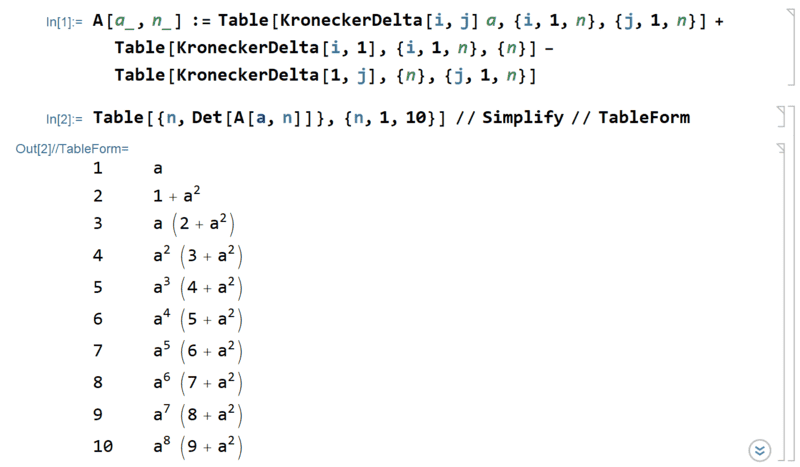

You can't leave n undefined. Mathematica can't find the rule for arbitrary n by itself. You have to calculate the result for explicit values of n, and then find by yourself the general rule.
Likes Lambda96 and renormalize
As DrClaude says, ##n## must be specified explicitly:
The pattern is pretty obvious.

Thanks DrClaude and renormalize for your help 👍👍
Thanks also renormalize for the trick with plotting n objects in Mathematica, so I could directly plot the eigenvalues from ##n=1## to ##n=10## without repeating the calculation 10 times 👍
I could now recognize corresponding patterns for the other values :smile:
