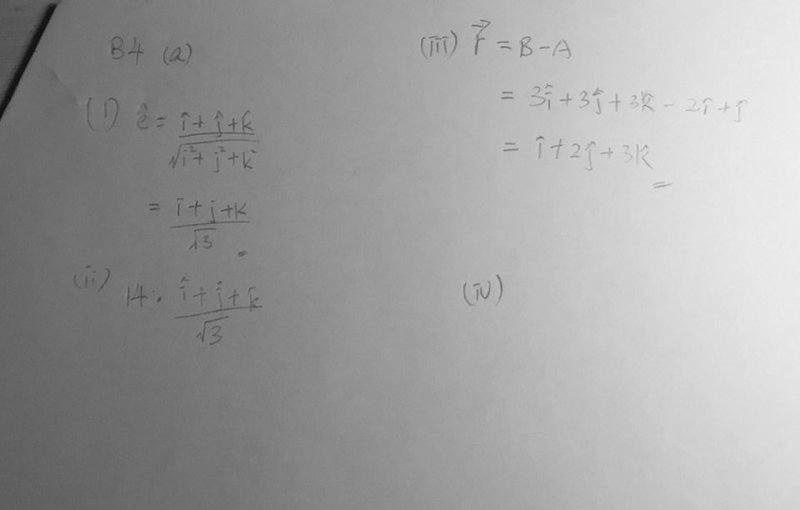

like this?
but how can get force of vector by multiplying
I did not get it. Can you please state it clearly.
But I guess you mean how to express Force in vector form. That is simply ##{14\over\sqrt{3}}\hat{i} + {14\over\sqrt{3}}\hat{j} +{14\over\sqrt{3}}\hat{k}##.
For (iv) you need to take dot product of (ii) and (iii). ##(\vec{A}\cdot\vec{B} = A_xB_x + A_yB_y + A_zB_z)##
Thank you ~i got it
i just thought the other way more complex:wink:
