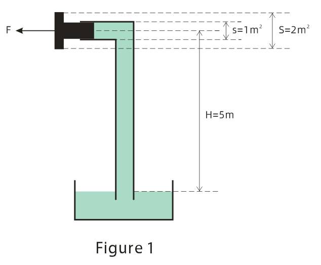

An interesting question that came to mind on its own.
F=ρghs
Neglect piston gravity, neglect friction.
Assume that the height at which the piston draws water is equal to 5 meters.
When the piston is solid.

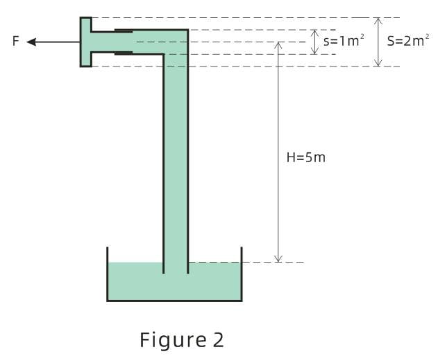

F=ρgHs=ρgHs=1000×9.8×5×1=49000 N
When the piston is hollow.
F=ρgHS=ρgHS=1000×9.8×5×2=98000 N
Is the calculation of the tension force in Figure 2 correct?
If incorrect, how is it calculated?

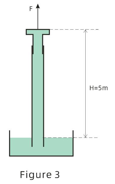

If S has no effect, is F(F=ρgHs=ρgHs=1000×9.8×5×1=49000 Nstill constant when placed vertically?
S is irrelevant. It makes no difference to the height by which the water is raised by a given movement of the piston.
Thanks.
If S has no effect, then when placed vertically (Fig. 3)? is F unchanged?
vdance said:
Thanks.
Yes.
To see why, consider the forces on the piston. What are the forces?
Not correct.
The column of fluid is not a cylinder with cross section of 2 m2, which would weight twice as much as the actual one.
The force F is of the magnitude needed to lift and hold in static equilibrium the mass of fluid contained in the represented volume.
To be precise, figure 3 represents a slightly greater mass of fluid, considering the fluid occupying the hollow piston (respect to the solid piston of neglected mass).

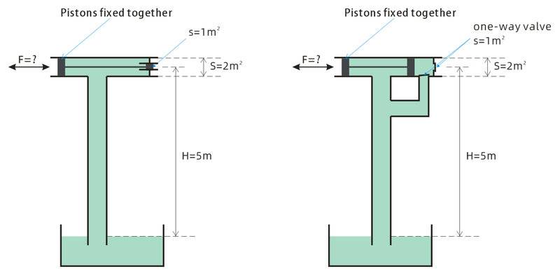

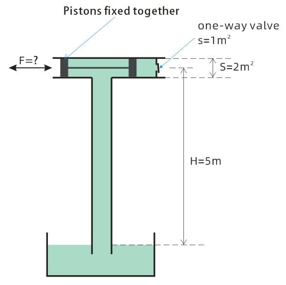

In this structure, I want to know the magnitude and direction of F.
Is it F=ρgH(S-s)=1000×9.8×5×(2-1)=49000 N
or F=ρgH(S-S)=1000×9.8×5×(2-2)=0 N
I do not see how that would work. The space between the pistons is constant volume, so why would any water rise?
Aha, I think I understand now. I shouldn't calculate the water pressure, but rather the weight of the water. This way, my problem can be solved. Thank you!
I see a one way valve.
If this is a question about hydrostatics then @haruspex is making the relevant observation. As long as the pistons are moving slowly and steadily, the one way valve is under a constant pressure difference. No air is ever allowed in past the one way valve. No water can ever leak out against the unchanging pressure difference.
If the pistons are accelerated back and forth then we can identify dynamic pressure differences due to that intermittent acceleration. While the pistons are being accelerated rightward or leftward by some external force, a pressure gradient will exist in the fluid between the two pistons. This pressure gradient will be consistent with the acceleration of the fluid. The gradient will be given by ##\Delta = \rho a s## where ##\rho## is the fluid density, ##a## is the left-right acceleration and ##s## is the left-right displacement across which a pressure differential is to be measured. [I've not carefully chosen a sign convention for that formula. If you decide to use it, pay some attention to that].
If the back and forth acceleration is vigorous enough, one may find that the left-right pressure difference is enough so that the gauge pressure at the one way valve intermittently goes positive, allowing fluid to escape past the valve.

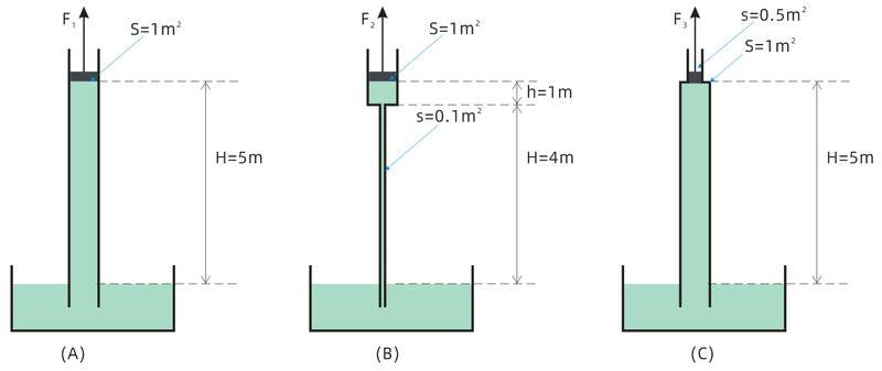

This question is the part I broke out of the graphic on the right above. The left end of the piston on the left side of the picture above has a different cross-sectional area than the right end, and at atmospheric pressure the piston must be moving to the right. In the right graphic I modified the right piston to be of equal size and added check valves to the ports, in this case I don't understand if the piston is stationary or moving to the right.Therefore, I need guidance from all teachers.
The piston absorbs water and is analyzed at rest, ignoring piston gravity and friction.
Calculate the traction of the piston separately.
The first set of calculations:
F1=ρgHS=1000*10*5*1=50000 N
F2=ρg(H+h)S=1000*10*(4+1)*1=50000 N
F3=ρgHs=1000*10*0.5*1=5000 N
Second set of calculations:
F1=ρgV=ρgHS=1000*10*5*1=50000 N
F2=ρg(hS+Hs)=1000*10*(1*1+4*0.1)=14000 N
F3=ρgV=ρgHS=1000*10*5*1=50000 N
Which group's calculations are correct?
The AI is telling me it's the first set of results.

vdance said:
My view is: Calculating the blocking force based on the piston’s cross-sectional area is valid. In such cases, even though two pools have identical water depths of 1 meter but drastically different internal cross-sectional areas (1 m² vs. 10,000 m², implying a colossal volume disparity), the force required to block their drainage pipes remains equal as long as the pipe diameters are the same.
Right.
vdance said:
However, a fascinating paradox emerges: If a standalone 1 kg mass of water is freely suspended, I could effortlessly lift it with one hand. Yet, if this same kilogram of water is spread into a thin layer spanning several square meters, held by a piston above and connected to a pool below via a narrow tube with an inner diameter of 1 cm, I would be completely unable to lift this mere 1 kg of water.
If you were to lift the piston at 10cm/s, how fast would the water in the thin tube rise?
Why not?
You may be cofusing force and work.
This hydraulic pistons business is not different from a lever and work: what you gain in reduced force, you lose in increased distance you need to apply that lesser force, and vice-verse.
