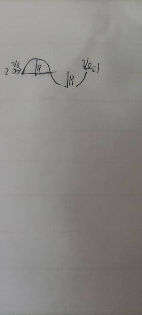

How do you calculate the terminal velocity of these two balls?

The coefficient of friction of the two arcs is the same.The radius of the ball is not taken into account.The roll of the ball is ignored.Can it be calculated or estimated quantitatively?The difficulty is estimated to be above the Physics Olympics semi-finals.

Thanks.I am sure that there is sliding friction.So the difficulty of the problem is to solve the sliding friction.
I would like to see a full statement of the problem. Is this a bead with a hole and a wire through it that is constrained to stay on the curved paths? If not, it is entirely possible for the mass to leave the track and follow a ballistic parabolic trajectory while on the left curve.
This is a problem in space.But it is confined to a plane.The wire stands for a rough transversal semicircle.Because the speed is not big, so do not consider the speed is too big and out of orbit.The support force divided by the friction force is considered constant μ.
Is this really from high school? I definitely didn't work on problems like this in high school 🤣 .
Anyways, the full statement of the problem as Kuruman said would be extremely useful. If the original statement includes pictures you could add them as well to help us understand you.
So we have a "rough" wire on which the bead slides, no gravity, and the centripetal force is provided by the wire. Is that your understanding? If "yes", then it seems to me that you can use Newton's second law to derive a simple differential equation for the linear acceleration along the path that is easy to solve.

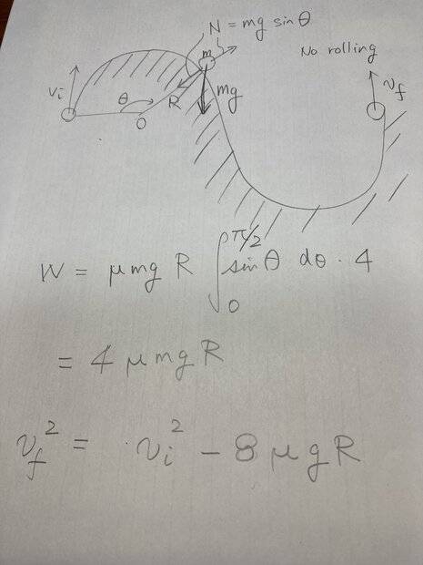

##v\frac{\mathrm{d} v}{\mathrm{d} \theta } + gRcos \theta + \mu gRcos \theta = \mu v^2 ##On the right, I get a complex differential equation.
$$ v\frac{\mathrm{d} v}{\mathrm{d} \theta } + gRcos \theta + \mu gRcos \theta = \mu v^2 $$
As I posted, unless it states that you should include gravity then I strongly suggest you should not. With gravity, the ODE looks insoluble to me; without gravity it is straightforward.

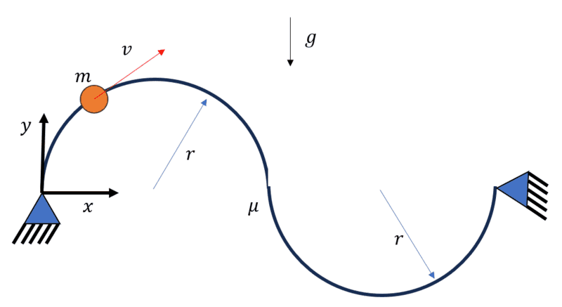

It looks very different to what I got. But I'm not an expert on this. I'll share my attempt.
I solved the left half of the problem. The equations that describe the other half should be equivalent. It's just a matter of getting the velocity of the bead at the end of the left loop and using it as the initial condition for the next loop.
Here is the diagram I used.
Using Newton we know that:
$$\sum \vec{F}=m\ddot{\vec{r}} \rightarrow m\vec{g}+\vec{F_f}+\vec{N}=m\ddot{\vec{r}} \tag {1}$$
(I prefer to express them all being positive and allow trigonometry to give me the right signs)
Since we're dealing with a circular path, it makes sense to use polar coordinates. Therefore, I'll express the cartesian coordinates ##x## and ##y## in terms of ##r## and ##\theta##. Take into account that ##r## is constant so its derivative with respect to time will be 0.
$$x=r\cos\theta \tag{2}$$
$$\dot{x}=-r\dot{\theta}\sin\theta \tag{3}$$
$$\ddot{x}=-r(\ddot{\theta}\sin\theta+\dot{\theta}^2\cos\theta) \tag{4}$$
$$y=r\sin\theta \tag{5}$$
$$\dot{y}=r\dot{\theta}\cos\theta \tag{6}$$
$$\ddot{y}=r(\ddot{\theta}\cos\theta-\dot{\theta}^2\sin\theta) \tag{7}$$
I'll also need to express the horizontal and vertical components of the forces. The weight is clear, it's always pointing down and with the same magnitude. For the other forces, we will need ##\theta##.
$$N_x=N\cos(\theta+\pi)=-N\cos\theta \tag{8}$$
$$N_y=N\sin(\theta+\pi)=-N\sin\theta \tag{9}$$
$$F_{fx}=F_f\cos(\theta +\pi /2)=-F_f\sin(\theta)=-\mu N\sin\theta \tag{10}$$
$$F_{fy}=F_f\sin(\theta +\pi /2)=F_f\cos(\theta)=\mu N\cos\theta \tag{11}$$
Finally, applying Newton to the horizontal and vertical directions results in:
$$\sum F_x=m\ddot{x}\rightarrow N_x+F_{fx}=m\ddot{x}$$
$$-N\cos\theta-\mu N\sin\theta=-mr(\ddot{\theta}\sin\theta+\dot{\theta}^2\cos\theta) \tag{12}$$
$$\sum F_y=m\ddot{y}\rightarrow -mg +N_y+F_{fy}=m\ddot{y}$$
$$-mg-N\sin\theta+\mu N\cos\theta=mr(\ddot{\theta}\cos\theta-\dot{\theta}^2\sin\theta) \tag{13}$$
I believe from ##(12)## and ##(13)## it should be possible to obtain the expressions for ##N## and ##\theta##.
I believe we can take advantage of the fact that, since we know it's a circular path, the centripetal acceleration is defined.
$$a_n = \dot{\theta}^2r \rightarrow m\dot{\theta}^2r = - N - mg \cos(\theta-\pi /2) \tag{14}$$
Although I have some doubts about ##14##. I guess one possibility would be to solve it both ways and see if the methods are equivalent or not. I can't do that though because those differential equations are too hard for me now.
The extra complication is that in the equations above ##N## is not constant but depends on ##\theta## and ##v^2## as a free body diagram would show.

  • #33
haruspex said:
I just spotted this in post #5:
So there is definitely no need to consider gravity.
OP has been giving confusing bits describing the problem during the thread. I tried to provide a clearer description in post #9 but I got no answer from him about it. Still, if there really is no gravity as you just said it's just a matter of setting ##g=0##.
I believe the procedure I posted should be OK but I don't know for sure. I'm especially doubtful about the comments on equation ##14## as I said in post #31.
  • #34
Your method in #29 is long-winded. You can write equation 14 straightaway (except, g=0 and you have a sign error; according to your diagram N should be positive). You just need another equation to relate N to ##\ddot\theta##.
  • #35
There might be a shortcut but I wasn't sure about it so I tried to be thorough.
Do you mean it'd be like this (with ##g=0##)?
$$a_n = \dot{\theta}^2r \rightarrow m\dot{\theta}^2r = N $$
Since ##N## points inwards I thought I should give it a negative sign. It is for these kinds of possible confusions that I try to avoid these "shortcuts" if I have no way to check for the solution to see if the result makes physical sense. I know it's possible to derive that expression using vectors and then the signs appear by themselves but I don't remember how to do that now.
By the way, do you know what'd be that additional equation?
In the long version of the problem, the solution comes from equations ##12## and ##13## with the possibility of using ##14## (when expressed correctly) if it makes the system of differential equations easier to solve. But I don't know what would be the equation "##15##" that you mentioned.
