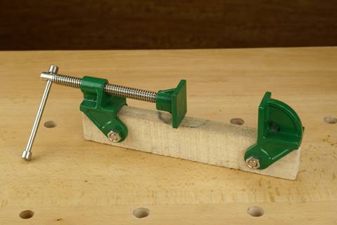

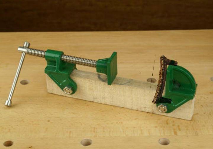

it's a piece that i am trying to attach to the bar clamp. let me see what i can do as far as pictures.
do you see this?
join metal and metal (steel to aluminum)
now i want a different grip for it like this, or a different caul

they're actually zinc. i was way off-base.
so zinc to steel? weldable? can they be brazed possibly? what do you think?
The boiling point of zinc is below steel's melting point. Are you sure they are fully zinc, or zinc-coated? Also Zinc contains volatiles that are released when burned and are pretty hazardous. You aren't going to get a good connection between these two materials.
My suggestion (though I know you don't have access to a welder) would be to weld threaded rod onto locations on the clamp, drill holes in the zinc piece, and then bolt.
As Pkruse suggested, epoxy might be your friend for this one. I'd drill some inserts to fit the threaded rod into, epoxy them into place and go from there.

they're cast and they have different finishes as in they're finished with either brass, pewter dark bronze or satin nickel.

so would you still go with epoxy that is a LePage Epoxy Steel as your #1 method?
The epoxy will be more effective if you heavily scuff up the surfaces you want to join. Epoxy also works best with a fairly thick glue line, so I would not clamp them together too tightly. Tape can usually provide enough clamping force.
