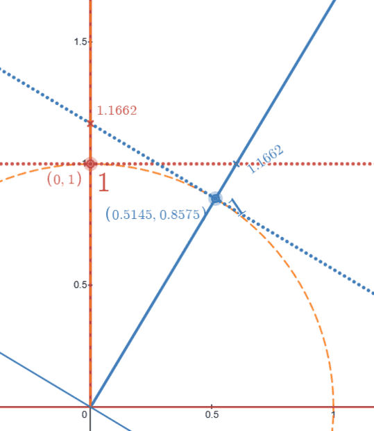

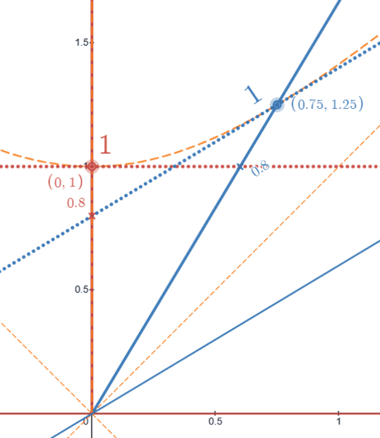

On a spacetime diagram,
simultaneity is described using the Minkowski version of the "tangent-line to a circle".
More specifically, when one intersects a circle by a radial line,
the tangent-line at that intersection is orthogonal to the radial line...
in the geometry determined by the "circle".
Try it at:
robphy SIMULTANEITY spacetime diagrammer for relativity (simplified from v8c) - 2023
https://www.desmos.com/calculator/ajktes8bp5
Euclidean (E= -1), Minkowski/Special Relativity (E = +1), Galilean Relativity (E = 0)
Likes curiousburke and PeterDonis

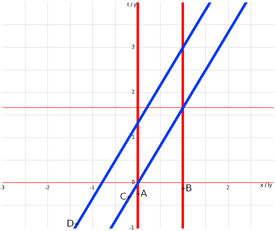

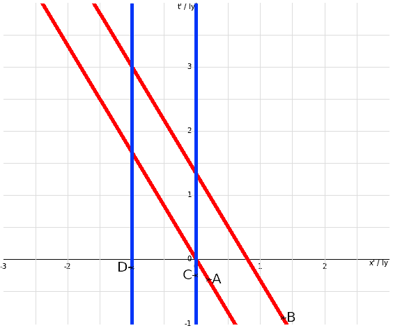

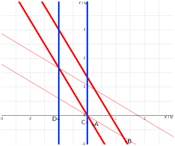

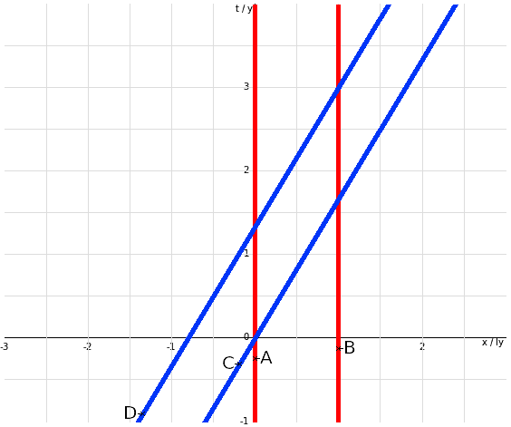

  • #38
Here are a few spacetime diagrams. If you haven't come across them, they're simply plots of the position of an object over time, the custom being that time goes up the page. So a vertical line represents an object that isn't moving, and a line slanted to the left indicates one moving to the left. You may have come across these (usually with time horizontally) as "displacement-time graphs" in high school physics. We take them a little more seriously in relativity, since spacetime is a thing - these are maps of spacetime, and the lines are the 4d objects inhabiting it. You see one 3d slice at a time.
So here's your scenario, with my extra "D" observer. A and B are marked in red and are stationary, C and D are marked in blue and moving to the right.
Note that, in this frame, C and D are closer together than A and B - the horizontal distance between the lines ("the space between them") is shorter.
We could mark on the diagram the start and end of the experiment - when C passes A and then B. Let's do that with fine red lines:
Now comes the interesting part. C and D don't use the same definition of simultaneity. The lines in spacetime they call "now" are not horizontal lines on this diagram - they're sloped. In fact they are the fine blue lines on this graph:
Note that these lines still go through the A/C and B/C meetings. But if you look at the lower fine line, you can see it passes through B much later than the fine red line did. So according to C, at the start of the experiment B's clock was ahead. And the part of B's line that is "during the experiment" according to C (the part between the fine blue lines) is much shorter than the part that is "during the experiment" according to A and B - that is, it starts ahead and ticks slower.
This is also why length contraction doesn't lead to a contradiction. Length is measured at one time, and the frames have different definitions of "at one time". A and B measure length horizontally; C and D measure it along the fine blue lines. So there are four different measures: the A-B and C-D distances along a horizontal line, and the A-B and C-D distances along a fine blue line (warning: "distance" here is a slight lie - you have to measure "interval", which is ##\sqrt{\Delta x^2-c^2\Delta t^2}## rather than the Euclidean distance you see on the graph, ##\sqrt{\Delta x^2+c^2\Delta t^2}## - this has the consequence that some lines that are longer on the graph are shorter in reality).
You asked about symmetry. That's why I've drawn D, even though I haven't used that letter yet. I can draw the equivalent graph using the frame where C and D are at rest. It looks like this:
This is a mirror of the first graph - now the blue lines are vertical and the red lines are sloped and closer together. The "same experiment" is A moving from C to D, and the same graphs with horizontal and slanted fine lines (just left-right reversed) can be drawn:
That's the symmetry you were missing. But you need to add D to get it, or in this frame there's nothing for A to move to and you can't do the same experiment as you did with the first frame. If you ignore D for a moment, the only thing you can measure is the time between A and B reaching C - and here you can see that the time between those events as measured by C is shorter than the time measured by A and B, by comparing the vertical distance between the crossings.
I hope that helps. You may need a more thorough intro to Minkowski diagrams if you haven't seen them before, but they really are the easiest way to visualise special relativity.

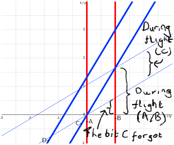

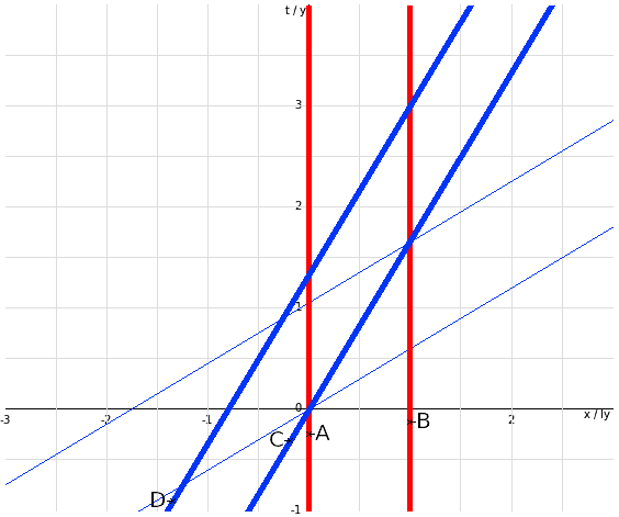

curiousburke said:
Checking if I understand this. I seems you can't read A, B and C's proper times directly off a single diagram
You can get A and B's proper times directly from the first diagram because ##\Delta x=0##, so in this case ##\Delta \tau=\Delta t##. Similarly you can get C's from the fourth diagram because ##\Delta x'=0## so C's ##\Delta\tau=\Delta t'##. You can't get all three off one diagram without doing a fairly simple bit of maths, no. (Although note that @robphy has a clever graphical method of measuring arbitrary proper times).
curiousburke said:
So, A and B from the first diagram is ~1.7 and C from the second diagram is ~1.4?
The diagram is draw with the speed of C and D being 0.6c relative to A and B, and with A and B separated by 1ly. So the time A and B measure should be 1.66y, and C should measure 1.33y. So you are pretty close.
  • #46
I almost said 1.35, but the added precision seemed unjustified :)

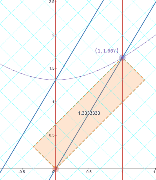

  • #47
Here's a Desmos visualization that reconstructs @Ibix 's spacetime diagram:
robphy-PFreply-resolveSeemingContradictions-CausalDiamonds
https://www.desmos.com/calculator/y5aiiixdvx
You can reposition the two events to find the interval between them,
which is calculated as the square-root of the
area of the causal diamond enclosed by two causally-related events.
With the given graph paper, one small diamond has diagonal with interval (1/3).
The causal diamond of OP has 16 diamond areas.
So, the (diagonal's interval) = (sqrt(16))*(1/3) =4/3.
With O at the origin, one can consider events Z only on the hyperbola of radius (4/3).
Likes curiousburke

  • #50
curiousburke said:
Unfortunately, now I'm taking a big step backwards (sorry). I think I'm understanding the space-time diagrams, but I'm still not really getting how the asymmetrical setup leads to different elapsed times. If B travels from some initial position to C, the space between them contracts and it takes less time. If C travels to B, the same. How does adding A change anything?
Forget about Minkowski spacetime for a minute and just look at the diagrams as pictures. Look at the second one, with the fine red lines marked. The two thick and two thin red lines form a rectangle. One blue line is the diagonal. The length of blue line between the fine red lines is longer than the length of thick red line between the fine lines, because one's a diagonal and the other's an edge.
Now go back to thinking of it as a Minkowski diagram. The elapsed time along the blue line between the fine red lines is shorter than the elapsed time along the thick red line between the fine lines, because one's a diagonal and the other's an edge.
That's why the times are different. It's because you picked the red lines to form the rectangle, so the blue is inevitably the diagonal. The third diagram (with slanted fine blue lines) shows what blue did wrong with intuitive reasoning: there is less elapsed time for the destination red clock during the experiment by blue's definition of "during". But the red clocks are not synchronised like that, and blue forgot to allow for the extra time.
