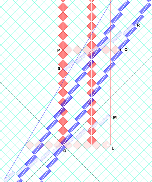

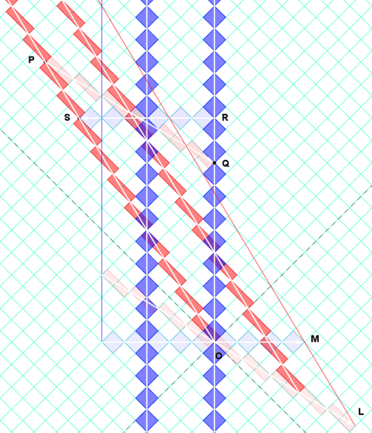

On a spacetime diagram,
simultaneity is described using the Minkowski version of the "tangent-line to a circle".
More specifically, when one intersects a circle by a radial line,
the tangent-line at that intersection is orthogonal to the radial line...
in the geometry determined by the "circle".
Try it at:
robphy SIMULTANEITY spacetime diagrammer for relativity (simplified from v8c) - 2023
https://www.desmos.com/calculator/ajktes8bp5
Euclidean (E= -1), Minkowski/Special Relativity (E = +1), Galilean Relativity (E = 0)
Likes curiousburke and PeterDonis

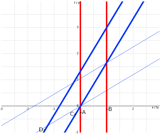

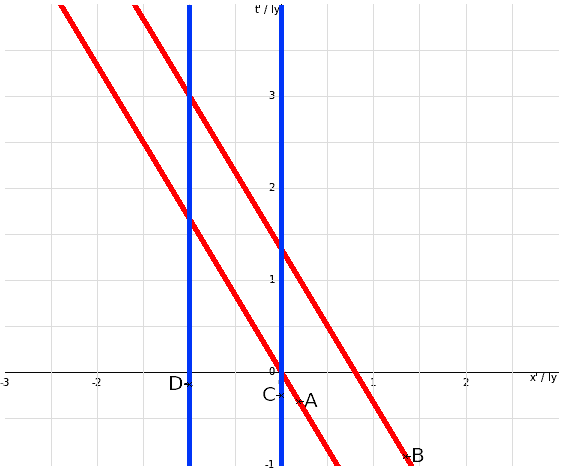

Here are a few spacetime diagrams. If you haven't come across them, they're simply plots of the position of an object over time, the custom being that time goes up the page. So a vertical line represents an object that isn't moving, and a line slanted to the left indicates one moving to the left. You may have come across these (usually with time horizontally) as "displacement-time graphs" in high school physics. We take them a little more seriously in relativity, since spacetime is a thing - these are maps of spacetime, and the lines are the 4d objects inhabiting it. You see one 3d slice at a time.
So here's your scenario, with my extra "D" observer. A and B are marked in red and are stationary, C and D are marked in blue and moving to the right.
Note that, in this frame, C and D are closer together than A and B - the horizontal distance between the lines ("the space between them") is shorter.
We could mark on the diagram the start and end of the experiment - when C passes A and then B. Let's do that with fine red lines:
Now comes the interesting part. C and D don't use the same definition of simultaneity. The lines in spacetime they call "now" are not horizontal lines on this diagram - they're sloped. In fact they are the fine blue lines on this graph:
Note that these lines still go through the A/C and B/C meetings. But if you look at the lower fine line, you can see it passes through B much later than the fine red line did. So according to C, at the start of the experiment B's clock was ahead. And the part of B's line that is "during the experiment" according to C (the part between the fine blue lines) is much shorter than the part that is "during the experiment" according to A and B - that is, it starts ahead and ticks slower.
This is also why length contraction doesn't lead to a contradiction. Length is measured at one time, and the frames have different definitions of "at one time". A and B measure length horizontally; C and D measure it along the fine blue lines. So there are four different measures: the A-B and C-D distances along a horizontal line, and the A-B and C-D distances along a fine blue line (warning: "distance" here is a slight lie - you have to measure "interval", which is ##\sqrt{\Delta x^2-c^2\Delta t^2}## rather than the Euclidean distance you see on the graph, ##\sqrt{\Delta x^2+c^2\Delta t^2}## - this has the consequence that some lines that are longer on the graph are shorter in reality).
You asked about symmetry. That's why I've drawn D, even though I haven't used that letter yet. I can draw the equivalent graph using the frame where C and D are at rest. It looks like this:
This is a mirror of the first graph - now the blue lines are vertical and the red lines are sloped and closer together. The "same experiment" is A moving from C to D, and the same graphs with horizontal and slanted fine lines (just left-right reversed) can be drawn:
That's the symmetry you were missing. But you need to add D to get it, or in this frame there's nothing for A to move to and you can't do the same experiment as you did with the first frame. If you ignore D for a moment, the only thing you can measure is the time between A and B reaching C - and here you can see that the time between those events as measured by C is shorter than the time measured by A and B, by comparing the vertical distance between the crossings.
I hope that helps. You may need a more thorough intro to Minkowski diagrams if you haven't seen them before, but they really are the easiest way to visualise special relativity.

curiousburke said:
What do I measure on the diagram to say find A and C's proper elapsed times during the experiment?
For a straight line, measure the vertical distance ##\Delta t## and horizontal distance ##\Delta x## between the endpoints. The "length" squared (properly called the interval) of the line is ##\Delta s^2=c^2\Delta t^2-\Delta x^2##. When this is positive the proper time along the line is the square root of it over ##c##. When it's zero the line represents something travelling at ##c##, and proper time is not defined. When it's negative it represents a spatial distance with a length equal to the square root of the absolute value.
Note that some sources define ##\Delta s^2## with the opposite sign. As long as you don't use both conventions in one calculation, it doesn't matter which you use - just reverse the positive and negative in my paragraph above. Note also that the graphs above use years for time and light years for distance, and using these units ##c=1\mathrm{ly/y}##, which simplifies the algebra. It also lets you see the sign of ##\Delta s^2## immediately by seeing if the line has a slope greater than, less than, or equal to 1.

You can get A and B's proper times directly from the first diagram because ##\Delta x=0##, so in this case ##\Delta \tau=\Delta t##. Similarly you can get C's from the fourth diagram because ##\Delta x'=0## so C's ##\Delta\tau=\Delta t'##. You can't get all three off one diagram without doing a fairly simple bit of maths, no. (Although note that @robphy has a clever graphical method of measuring arbitrary proper times).
curiousburke said:
So, A and B from the first diagram is ~1.7 and C from the second diagram is ~1.4?
The diagram is draw with the speed of C and D being 0.6c relative to A and B, and with A and B separated by 1ly. So the time A and B measure should be 1.66y, and C should measure 1.33y. So you are pretty close.

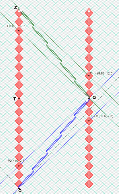

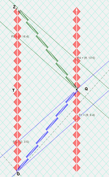

Here's a Desmos visualization that reconstructs @Ibix 's spacetime diagram:
robphy-PFreply-resolveSeemingContradictions-CausalDiamonds
https://www.desmos.com/calculator/y5aiiixdvx
You can reposition the two events to find the interval between them,
which is calculated as the square-root of the
area of the causal diamond enclosed by two causally-related events.
With the given graph paper, one small diamond has diagonal with interval (1/3).
The causal diamond of OP has 16 diamond areas.
So, the (diagonal's interval) = (sqrt(16))*(1/3) =4/3.
With O at the origin, one can consider events Z only on the hyperbola of radius (4/3).
Likes curiousburke

Forget about Minkowski spacetime for a minute and just look at the diagrams as pictures. Look at the second one, with the fine red lines marked. The two thick and two thin red lines form a rectangle. One blue line is the diagonal. The length of blue line between the fine red lines is longer than the length of thick red line between the fine lines, because one's a diagonal and the other's an edge.
Now go back to thinking of it as a Minkowski diagram. The elapsed time along the blue line between the fine red lines is shorter than the elapsed time along the thick red line between the fine lines, because one's a diagonal and the other's an edge.
That's why the times are different. It's because you picked the red lines to form the rectangle, so the blue is inevitably the diagonal. The third diagram (with slanted fine blue lines) shows what blue did wrong with intuitive reasoning: there is less elapsed time for the destination red clock during the experiment by blue's definition of "during". But the red clocks are not synchronised like that, and blue forgot to allow for the extra time.

Here's @Ibix 's spacetime diagram supplemented with "light-clock diamonds"
to help visualize the ticks along segments in spacetime.
An inertial observer's light-clock diamond
has a timelike diagonal parallel to his worldline
and spacelike diagonal Minkowski-perpendicular to his worldline.
Thus the spacelike diagonal is simultaneous according to that inertial observer.
All light-clock diamonds
have lightlike edges (speed of light postulate: eigenvectors of a boost on this plane)
and have equal area (determinant of boost equals 1).
The scale is (1 on @Ibix 's scale)=(3 ticks).
Using @Ibix's labeling of worldlines,
B along x=1 is 3 red-spaceticks [red-"sticks"] away from A and
D is -3 blue-"sticks" from C.
  • The undecorated parallel worldlines 5 ticks away from A and C
    help in counting diamonds to set up proportions (via similar triangles)
    when trying to count diamonds involving B and D.
    For instance:
    for v=(3/5)=(6/10)=[itex]\frac{(PQ)}{(OP)}[/itex], we have [itex]\gamma[/itex]=(5/4) and k=2.
    Length contraction:
    A rod of proper-length 5 [red-]sticks carried by A
    is measured to be 4 [blue-]sticks according to C since [itex]5/\gamma=4[/itex]. [itex](OM)=\frac{(OL)}{\gamma}[/itex])
    A rod of proper-length 5 [blue-]sticks carried by C
    is measured to be 4 [blue-]sticks according to A since [itex]5/\gamma=4[/itex].
    So,
    A rod of proper-length 3 [red-]sticks carried by A [whose far end is traced out by B]
    is measured to be 2.4 [blue-]sticks according to C since [itex]3/\gamma=3/(5/4)=(12/5) {\rm\ sticks}=(12/5) (1/3 {\rm\ Ibix})= (4/5 {\rm\ Ibix})[/itex].
    ...and similarly for the rod carried by C [whose far end is traced out by D].
Likes curiousburke

Here's the original diagram, followed by its boosted version.
If you look at these a little bit and learn how to interpret the geometry and physics encoded,
I think that you can see that they convey the same information...
(...Like a rotated photo has the same information as the original photo.)
by counting ticks and sticks.... and by interpreting the diagonals
of an inertial observer's light-clock diamonds as defining
"at the same place" and "at the same time" for that observer.
So, the second diagram isn't necessary... and, in fact, can be constructed by hand from the first diagram.
(Using v=(3/5)c or (4/5)c [or more generally velocities with a rational Doppler factor]
makes this easy to construct by hand on rotated graph paper.)

Here's my clock-effect/twin-paradox spacetime diagram using the rotated graph paper.
This is for [itex]\gamma=2[/itex] [so, [itex] v=\sqrt{3}/2 [/itex]] (the video's situation),
which isn't ideal for handdrawing on rotated graph paper
since [itex]k=2+\sqrt{3}[/itex] (not rational).... so the piecewise-inertial traveler's diamonds don't fall nicely on the rotated graph paper.
I've drawn in the lines of simultaneity, which are parallel to the spacelike diagonal of the traveler's diamonds.
Note [itex]2.5=\frac{10}{\gamma^2}[/itex]
With [itex] v=4/5 [/itex], we have [itex]\gamma=5/3[/itex] and [itex]k=3[/itex].
Note [itex]3.6=\frac{10}{\gamma^2}=10\left(\frac{3}{5}\right)^2[/itex]
Likes curiousburke
