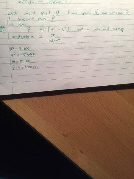

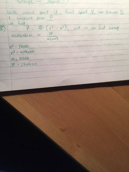

Could you please advise if I'm heading in the right direction or not with the numbers in the image.
Thanks
NotVerySmart said:
View attachment 216244 Could you please advise if I'm heading in the right direction or not with the numbers in the image.
Thanks
No, you may have missed the edit I made at the end of post #4. Besides, you should not quote the formula I posted without proof. You need to derive it yourself, but taking into account the given wind resistance.
Start from first principles. If the tractive force provided by the engine at time t is F(t), the drag is D, and the speed is v(t):
- what is the net force?
- what is the acceleration?
- what is the power being provided by the engine?
