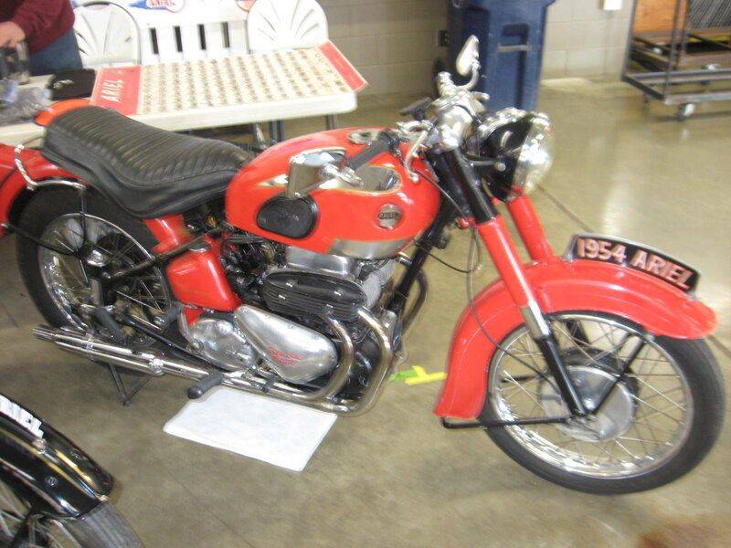

An unusual setup for a 4-piston engine was the Ariel Square 4, a British motorcycle produced between 1931 and 1959. It had two crankshafts, making it effectively a joined pair of inline two-cylinder engines in a single engine case and a single head. Early versions had overhead cams, but later versions ran overhead valves.
Here's a picture of a '54 Ariel I saw at an antique motorcycle show about a week ago.
Likes sysprog
