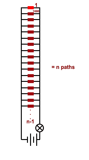

Hm. What are the conditions for a circuit to spontaneously produce unsteady, oscillating output for a steady input?
  • #33
snorkack said:
Given those two requirements, current still finds path of least resistance even if the circuit is higly nonlinear... or does it?
No.
It finds all paths - it just follows them to varying degrees.
A circuit with a single 1 Ohm resistor and 49 x 1000 Ohm resistors (all in parallel) will still see the current follow fifty paths...
... only one of which is "the path of least resistance".
