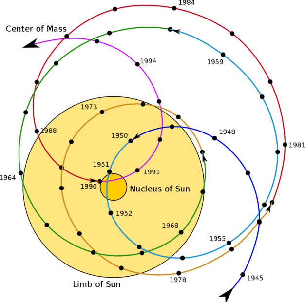

Every planet orbits around it's barycenter with the Sun. In most cases, this barycenter is close enough the center of the Sun to make little difference. The Jupiter-Sun barycenter is actually just above the surface of the Sun. There is no real difference between Earth orbiting the Sun and Jupiter other than the size of the Sun's orbit around the respective barycenters. Kepler's Laws reflected a pattern he derived via observation, and of course, were limited by those observations. The small variation due to planets orbiting barycenters rather than the Sun proper were more than likely within the error bars of his observations. Remember, he produced these laws before Newton came up with the theory of gravity which explained them.
In most cases the difference is negligible to the extent that other effects, such as the jovian influence on the orbit, have a larger impact. In the case of Jupite it is relatively accurate.
For the interested, there is a telling image on Wikipedia:
This displays the motion of the solar system barycenter relative to the Sun.
