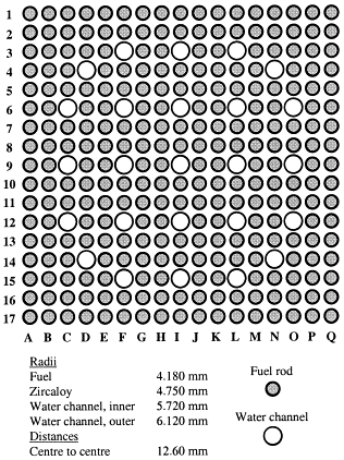

So when you say the Fuel Rods are put in Bundels of say 17x17 do you meen one Bundel will be a Bed of Rods 17 Rods left to right and 17 Rods top to bottum?
biferi said:
So when you say the Fuel Rods are put in Bundels of say 17x17 do you meen one Bundel will be a Bed of Rods 17 Rods left to right and 17 Rods top to bottom?
More or less. The fuel rods are arranged in a Cartesian (x-y) array. The guide tubes are interspersed among the fuel rods.
See the attached figure.
Ok thanks for the photo I think I get it now.
Every Reactor will be made diferant but for this one each Bundle will be 17x17 Fuel Rods.
Now in the Photo every so often I see a big whole inbetween the Fuel Rods.
It says this is a Watter CH. so would I be right in thinking this?
The whole Bed of 17x17 Fuel Rods are in one Bundle and get submerged under watter. And in the photo when I see the big whole inbetween say every other Fuel Rod is for watter to come all over the Fuel Rods?
Or am I missunderstanding?

PWR fuel assemblies do not contain water rods or water channels, but rather they have 'guide tubes' which perform several functions:
1. Accommodate the control rods when inserted in the core,
2. Form the structural skeleton of the fuel assembly, and support the spacer grids which maintain the reqular square lattice of the fuel rods,
3. Contain water when control rods are withdrawn, so do provide some moderation in the fuel assembly.
In a given PWR core, all the fuel assemblies have the same lattice. The control rod assemblies are a fixed part of the reactor design since the hardware is fixed in the upper guide structure, which is part of the upper head structure.
In BWR fuel, there are three principal manufacturers (AREVA, GNF, Westinghouse (formerly ABB-Atom)), each having a unique design.
AREVA's ATRIUM design has a large square water channel in the center of the fuel assembly. It is centrally located in the 9x9 and 11x11 designs, but slightly offset on the diagonal oriented toward the control rod in the 10x10 design.
GNF has the GE14 and GNF2 designs which incorporate two cylindrical water rods in the lattice.
Westinghouse's 10x10 is the SVEA-96/-100 design, which is a 10x10 lattice. It has a unique water cross design which sits among four mini-bundles.
All BWR assemblies are encompassed in a square (with round corners) channel which serves to direct the flow up through the assembly (and prevents crossflow). The channel is required because of the significant boiling in the fuel assemblies,
