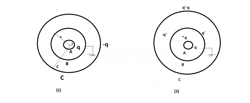

Figure (1)shows three concentric thin spherical shells A,B and C of radii a,b and c respectively.The shells A and C are given charges q and -q respectively and the shell B is earthed.Find the charge appearing on the surfaces of B and C.
Figure (2) shows how charge distribution would take place.

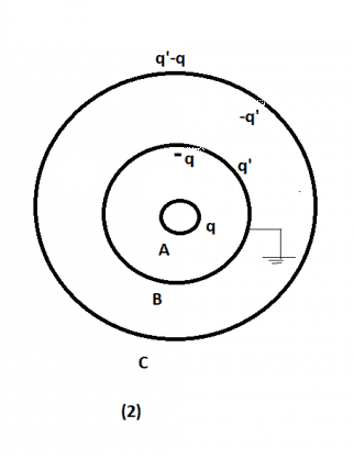

Charge distribution:The inner surface of B must have a charge -q from the Gauss's law.Suppose,the outer surface of B has a charge q'.The inner surface of C must have a charge -q' from the Gauss's law.As the net charge on C must be -q ,it's outer surface should have a charge q'-q.The charge distribution is shown in the figure.But as per my understanding
The inner surface of B must have a charge -q so that net charge becomes zero because as shell B is earthed it has to be at zero potential.But then we will be violating "conservation of charge"law.As originally shell B does not have any charge.That's why the outer surface of B should have charge q.
I am all confused about shell C.As according to Gauss's law it is ok to have charge q on the outer surface(i.e inside shell C) of B because this gives net charge q inside shell C and that was the case initially.But then total charge of shell C becomes zero and that violates "conservation of charge"law.
Please help.I am really Sorry if it is confusing.
Shell B is not isolated since it is connected to ground. Ground can be treated like a big neutral sea of available charges (positive or negative). If they can (if there's a conductive path) they will move to try to cancel charges and their fields.
So the charge conservation rule doesn't hold for shell B since it can draw on charges through its ground connection.
Please help me to understand this.How and why?Any hint?
There can be no electric field inside a conductor, so something must prevent any field originating in the interior of shell C from penetrating shell C's material. If shell B has some charge q' on its surface, then that charge will attract its opposite charge -q' to the inner surface of C, satisfying the requirement of cancelling the field from B. That charge of -q must have come from the total charge q on the C shell (the C shell being isolated), leaving charge q-q' to present at the outer surface of C.

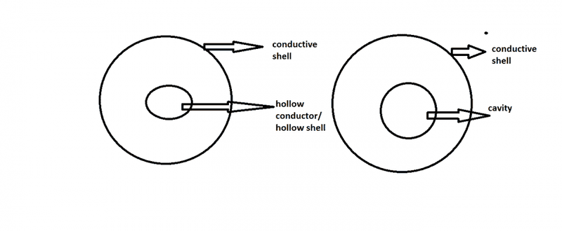

If any conductive shell surrounds a hollow conductor,can that hollow conductor be treated as a cavity inside the conductive shell?
I'm not sure that I understand what you're getting at. As far as I can tell you're describing nested conductive shells, or several hollow objects inside another shell. As you've seen, charges on nested shells can influence the field external to the outer shell. Any fields in the interior of that outer shell will be due to charges in its cavity, and they can interact between each other the way charges usually do. These charges can reside on hollow conductors.
Can you draw a scenario that might make your query more clear??
Likes gracy
What I am asking is, are these two same?
Well, the same in what way? In the diagram on the left one could place a charge on the inner conductor and there would be a field surrounding it in the open space between it and the outer shell. In the diagram on the right that space is filled with conductor (it's part of the shell) so there would be no field in that space, and there's no isolated conductor to hold a charge. In effect you have only one shell in the diagram on the right.

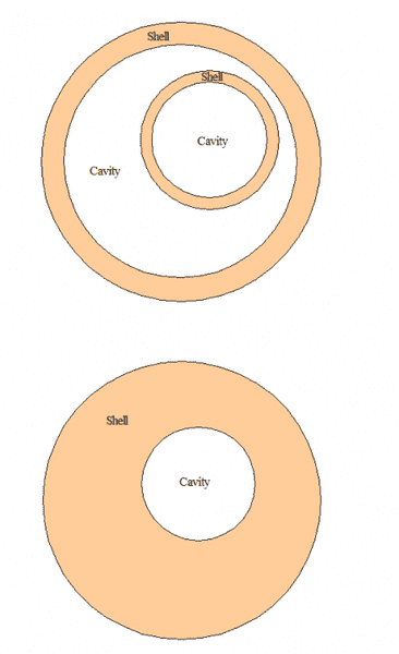

Perhaps I am misreading your intentions with your diagrams? You don't indicate what's solid material and what is not. I interpreted your cases as follows:

In the pictures you drew both inside and outside shells are hollow conductors,right?
White is empty space, color is conductor.
What I am asking is can that hollow conductor (hollow shell :shell containing cavity inside)be treated as a cavity inside the conductive shell?[/QUOTE]

A "shell" is a single contiguous layer that encloses some space. It has two surfaces: an inside surface and an outside surface. I'm having trouble distinguishing a shell from your "hollow shell", since they should be identical, with the "hollow" being redundant. Two nested shells can have a hollow space between them. Perhaps that's what you mean?
In your drawing what I'm seeing is an outer shell (gold color) with a cavity, and in that cavity is another, single very thin shell represented by the line of a circle.
A shell can hold a charge, but a void (cavity) cannot. So in general a shell is not the same as a cavity.
