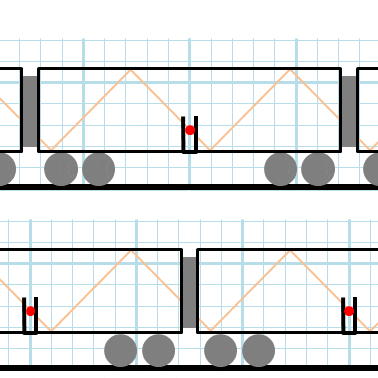

Maybe this diagram helps
Here's something (it could be a pulse of light, it could be a ball) bouncing up and down in a train.
An observer in the train (top) infers the thing is moving vertically up and down.
An observer on the ground (bottom) infers the thing is "sliding sideways" in a zig-zag path.
This is valid in both relativistic and Newtonian mechanics.
