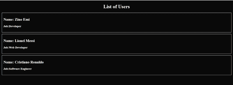

I'm not understanding the program flow here. What happens first then what? React is really confusing man.
Can anyone help me build a mental model of it?
Output:

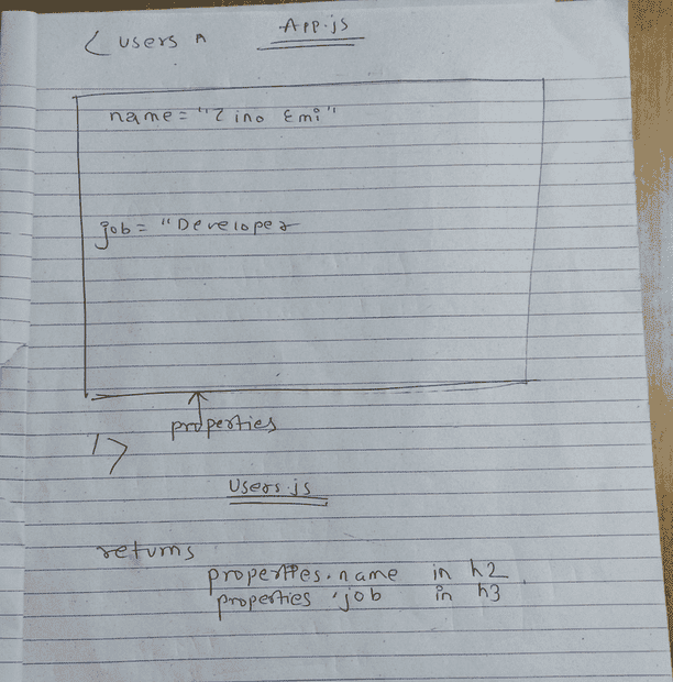

1) Start with App.js
2) It returns Users component.
3) Inside Users component we pass properties name and job.
4) Inside Users.js we access it using props.name and props.job.
A figure that helped me
