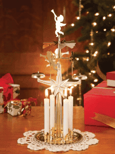

Are you asking about something similar to this?
Maybe you can post a picture of the paper thing you're asking about.
Likes phantomvommand
Yes, although the usual demonstration is less elaborate.

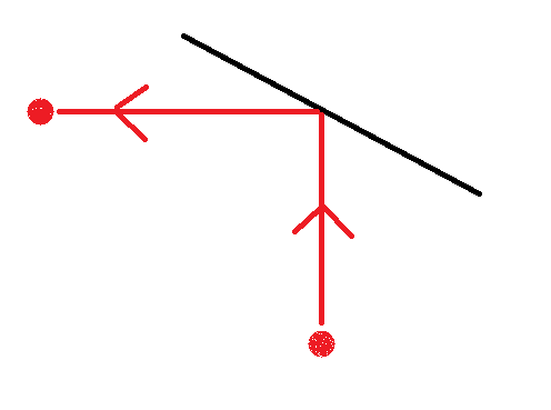

Forget about the air, let a particle collide with the blade instead. Seen from the side:
What is the direction of the impulse on the blade?

No, the paper blades in the illustrations you linked are not vertical, they are diagonal. Part of the force is vertical, part horizontal.
Likes phantomvommand, hutchphd and malawi_glenn

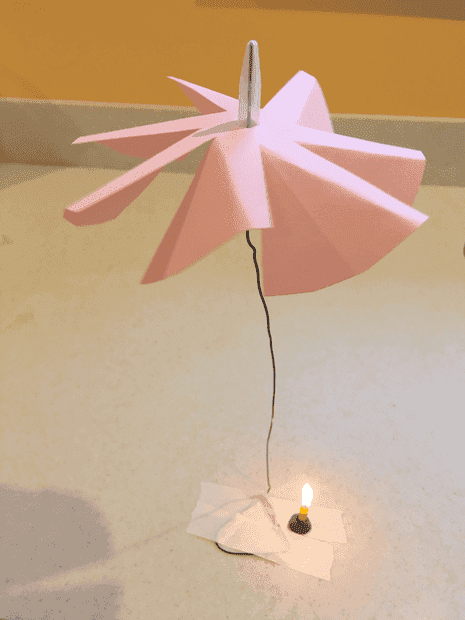

Are you talking about something like this, @phantomvommand? The principle is the same as the helicopter blades - the flat spiral falls into a spiral ramp, so the paper is everywhere slanted downwards in the same direction (clockwise or anticlockwise). The diagram in @malawi_glenn's post #4 then applies, and you get rotation.
Likes phantomvommand and malawi_glenn
